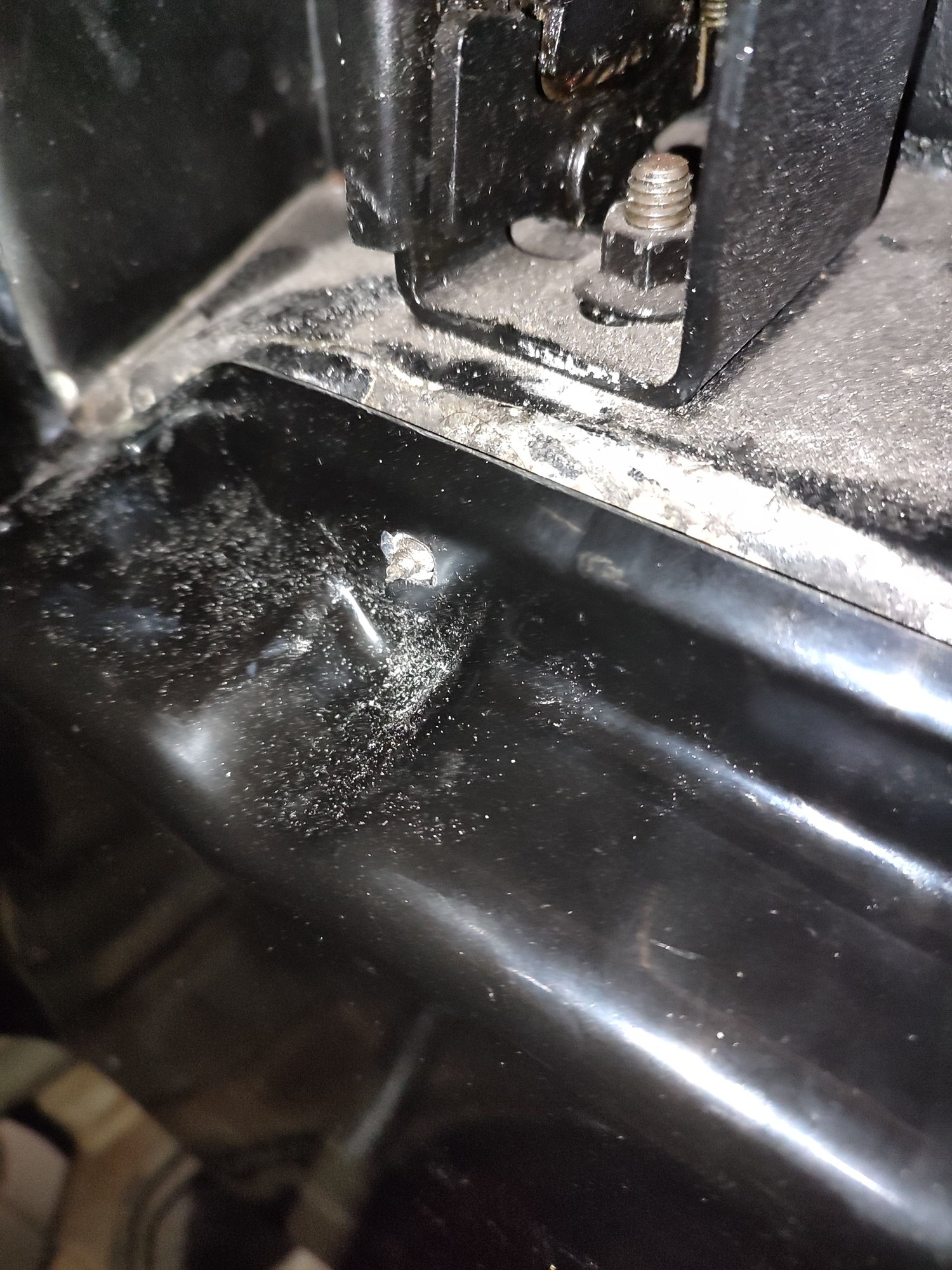

Hi everyone
I'm installing a 'Delete Airco'-heaterbox.
There is a screw that comes from under the dash, but before I remove the LH dash panel, I want to make sure that there isn't another way to deal with this screw.
(I really hate taking the dash apart.)
Is there another way to fasten that side of the heater box by using the end of the screw sticking out the firewall?

Also pulling apart the right hand side of the dash in a 77 is child's play compared to most cars.
You must really hate pulling that map pocket.
And in answer to your question. You Need to pull that dash apart if your changing your heater box.

To the OP question....I am afraid you will just have to pul the right side panel......I have pulled mine without taking anything else apart....so at least its not on the left side!!!

Is that the only screw causing you fits? Perhaps a T-nut, turned around, with the splines cut off would work? Or a threaded standoff stud, and drill a bigger hole in the AC delete cover.
I had my dash apart when I did my AC delete.
