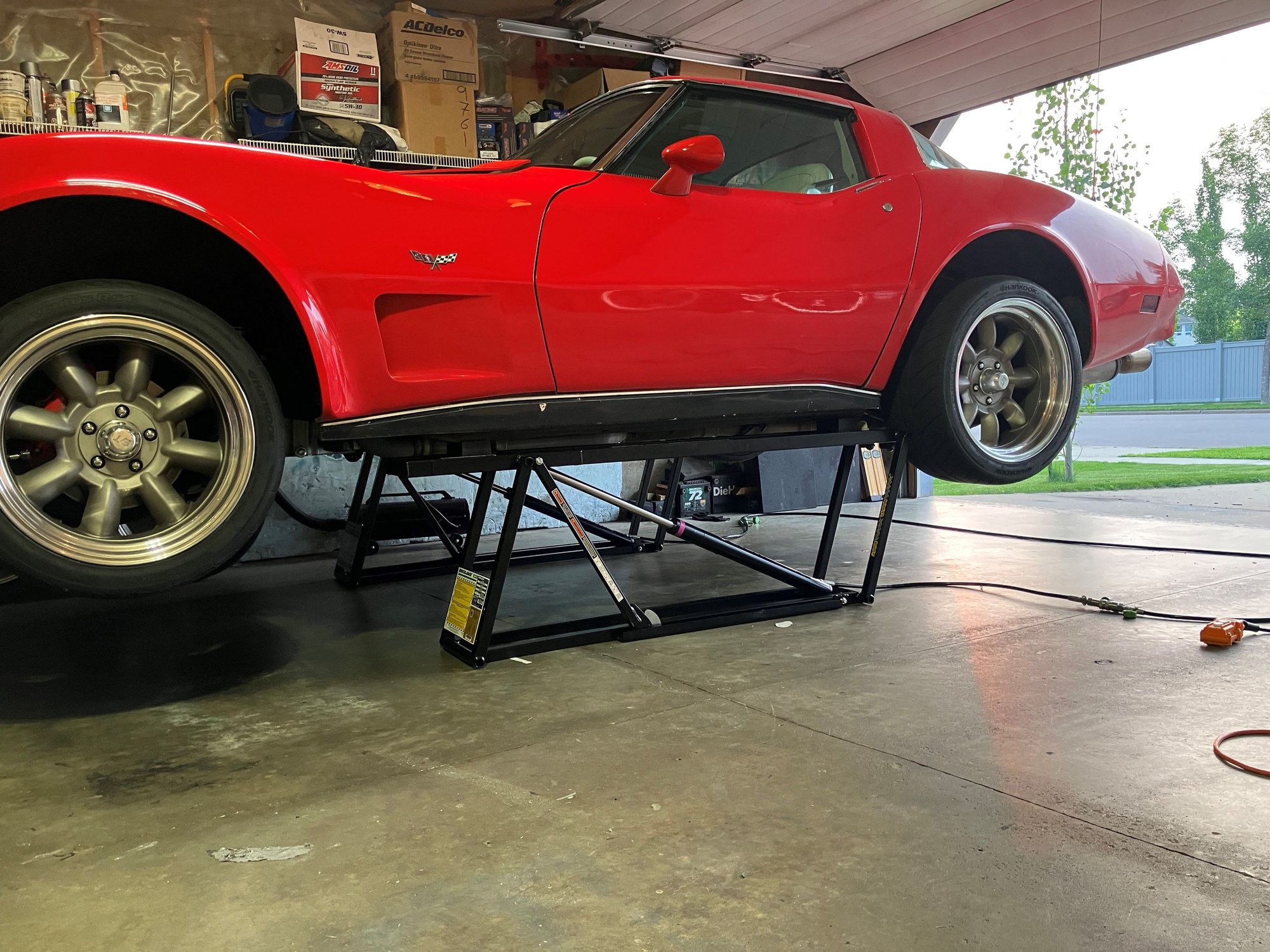

I didn't install a TKX (5 speed) used a T56 Magnum 6 speed.
T56 Magnum Install 78 Corvette. - CorvetteForum - Chevrolet Corvette Forum Discussion
Since my car already had a removable cross member, I still needed a different cross member for the T56 6speed. Started using a single disc clutch (way to stiff) then went to a Twin disc setup ( almost feels like a C6 manual )
But since then I have replaced the motor (LS3) / clutch. Not possible for me to install engine / trans as one piece. Since the LS3 swap is replaced the clutch 1 more time. If I had to pull both I would never DIY the process.
With a quick jack 5000TL there is enough clearance to leave the transmission on a jack and slide under the car and complete the clutch swap.
As for diff gears, I still have the factory 3.08 Rear diff. With the ZZ383 or the LS3 / 480 was no problem street or track days. I do have a 3:36 diff which best matches the C6 corvette (3.42) but I do have 2 gears for overdrive.
With the 3.08 / LS3, highway gas mileage was 33.1 MPG
1978 LS3 Swap Completed. - CorvetteForum - Chevrolet Corvette Forum Discussion
If you are planing on doing this once, install a twin disc to save your legs.
