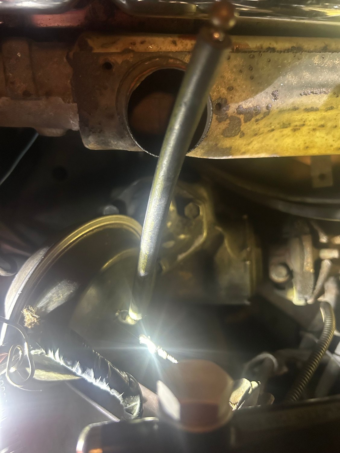

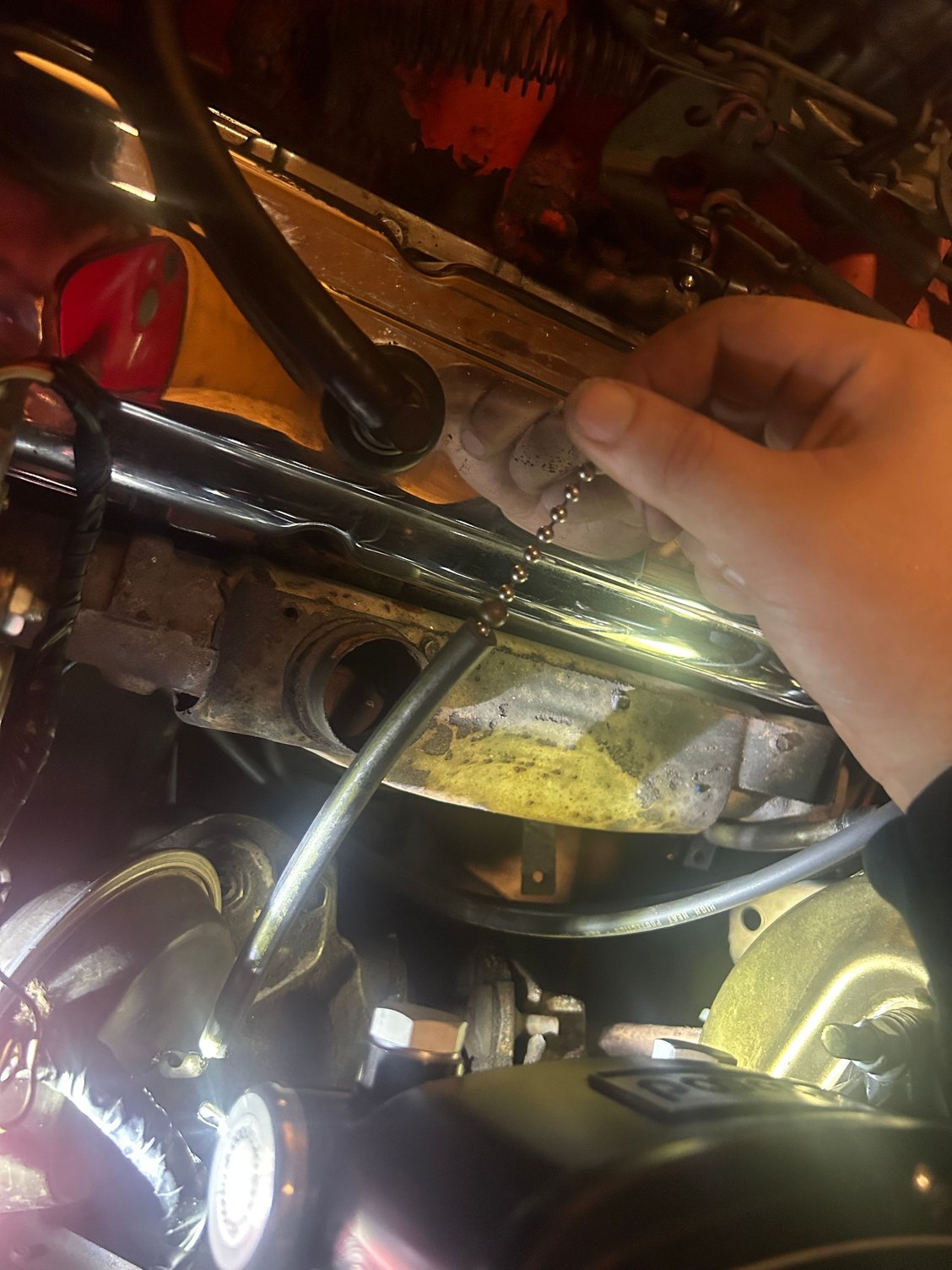

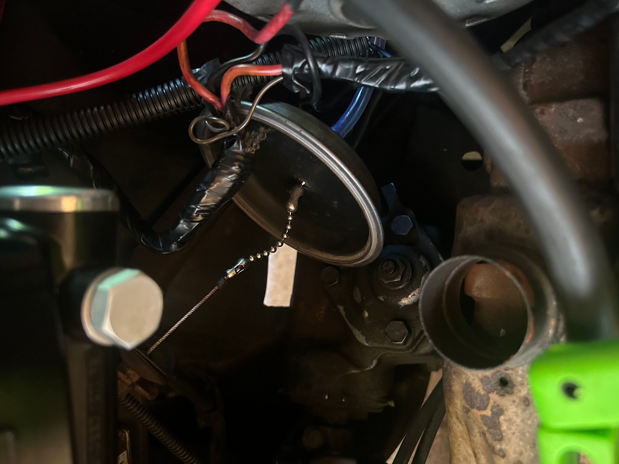

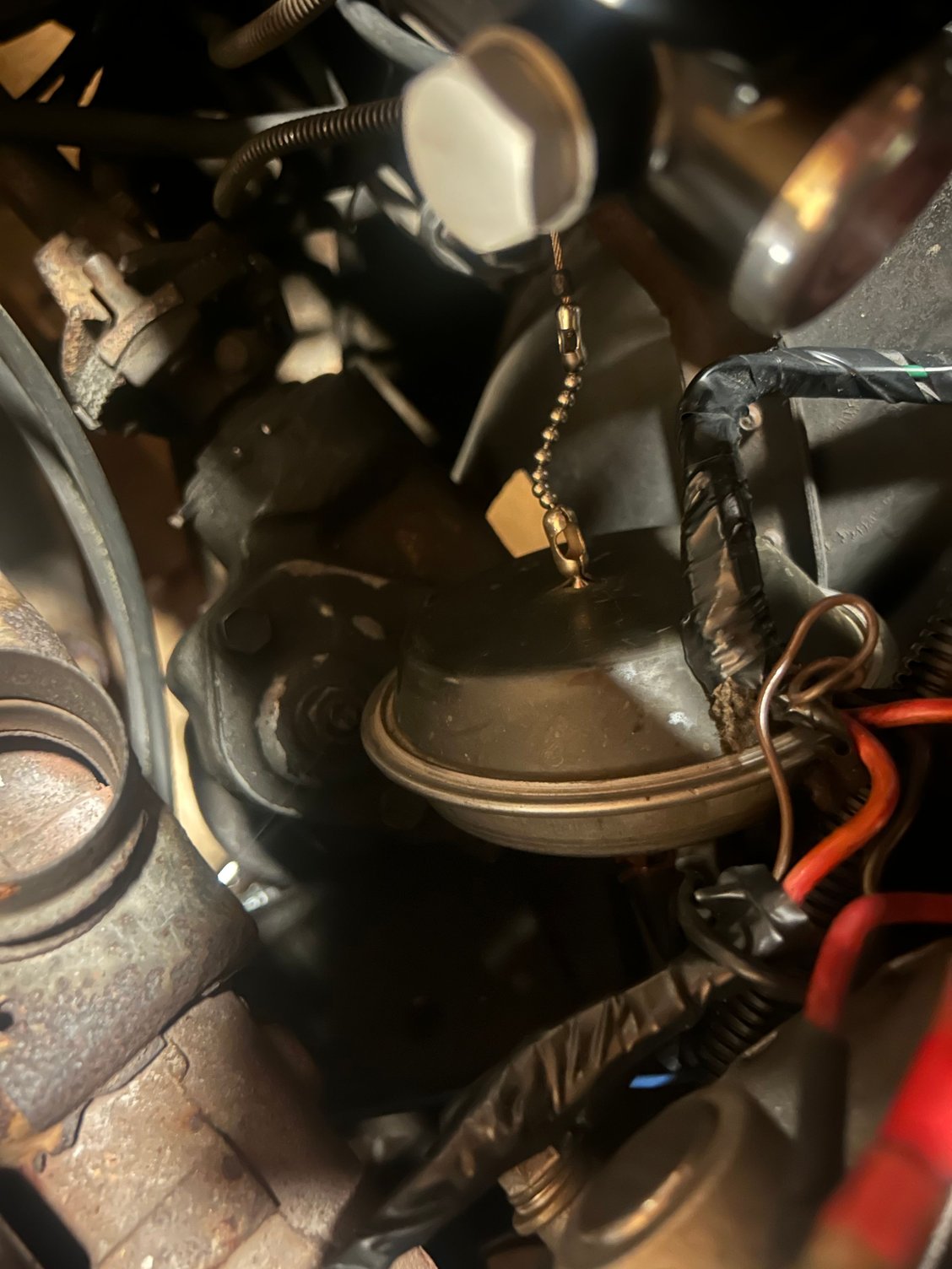

I got a ball and chain type servo for my 1977 corvette. NOS part from a Buick of the same year. Problem is, chain is too long. The pictures show its length, and the cable is already hooked up to the carb at rest position.
what is the solution? I have #10 connectors, I just don’t know if I need any slack in the chain or if it’s supposed to be an even firm line from cable to chain to servo.

Yeah, sorry. This is what I needed, but the photo I sent with me holding the chain shows that it’s way too long.
My grandfather found his manual and is sending it to me, I just don’t have it yet. But anyways, when adjusting this chain should the servo be sucked in?
Im trying to find articles and information on how the vacuum works, and if the servo sucks in when the car is on and only pulls back when cruise is engaged?

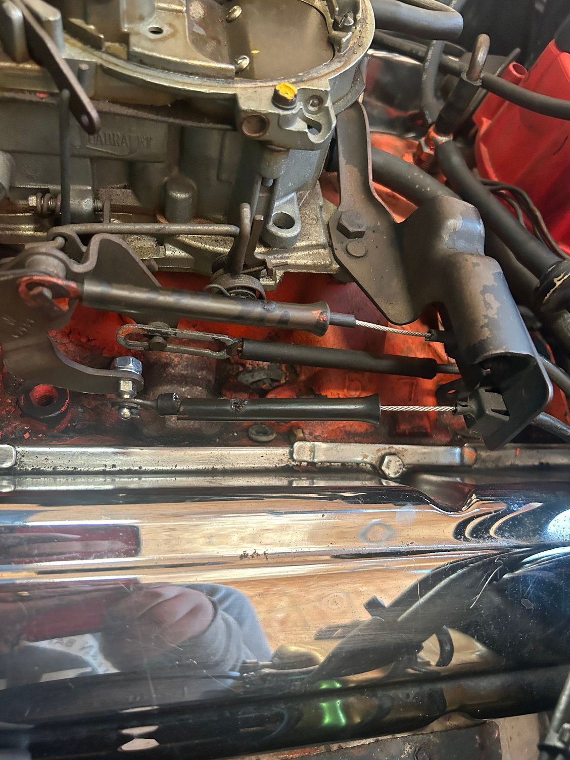

More photos.
took vacuum all the way down in the servo with throttle cable at straight/tight position at carb.

Originally Posted by dmallen95
More photos.

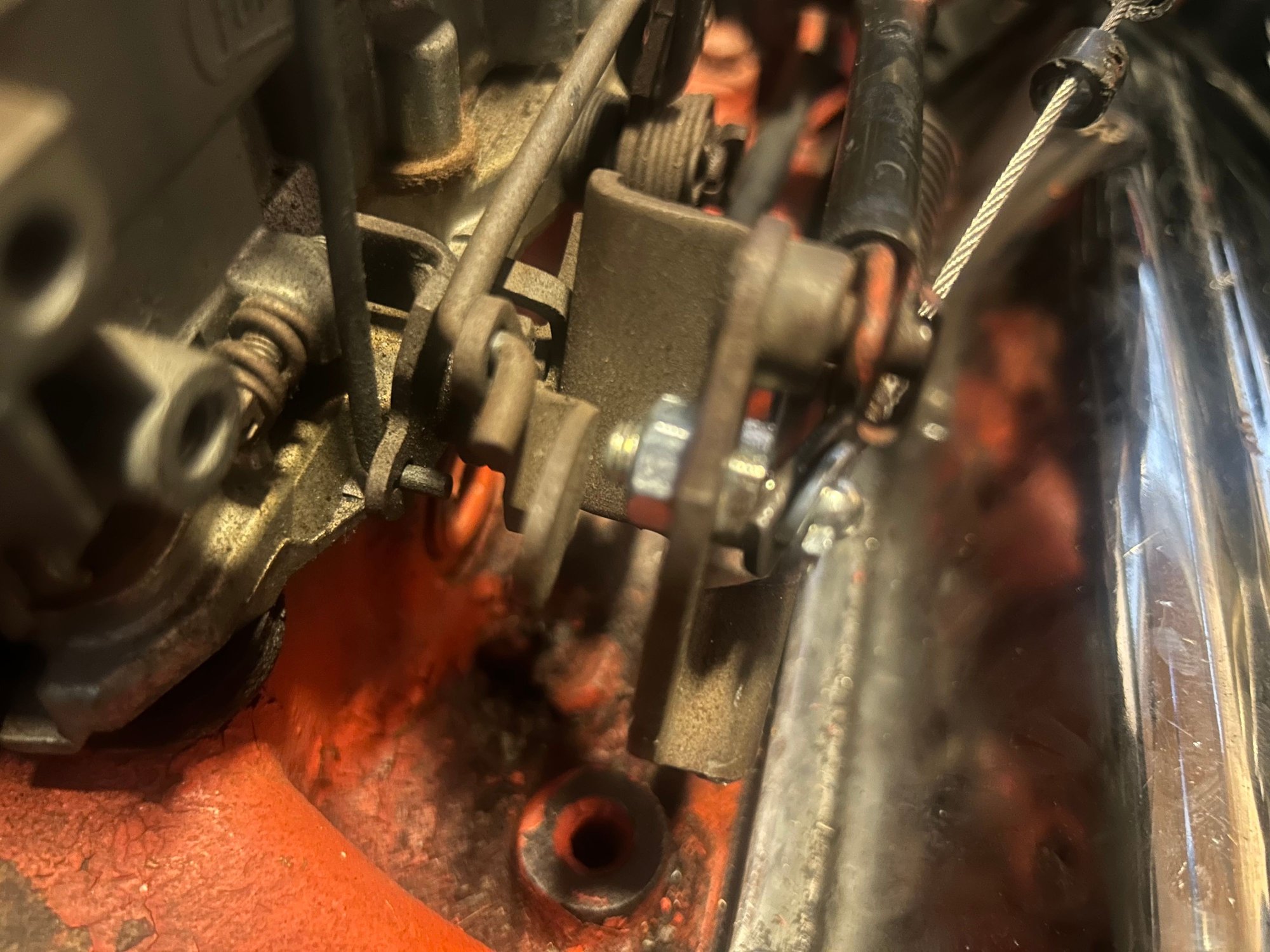

No vacuum when you adjust the cable, just a tiny bit of slack. You don't want any pull that would possibly mess with the throttle plate position. That's the reason for the slack.
Post a photo of the side of the carburetor where the cruise cable attaches.

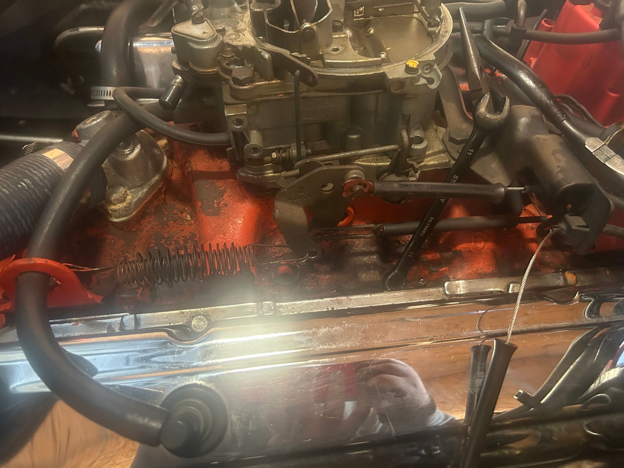

this is with the vacuum released from the servo. Now the ball and chain hangs. I guess what I’m wondering is, when you crank the car, does the servo suck in? Making the ball and chain straighten up, and then when cruise is engaged the servo is pulled back by the cable?
To me, if the servo sucks in when the engine is turned on, I don’t know how to get the right chain length unless I pull vacuum with it match the chain to the cable.

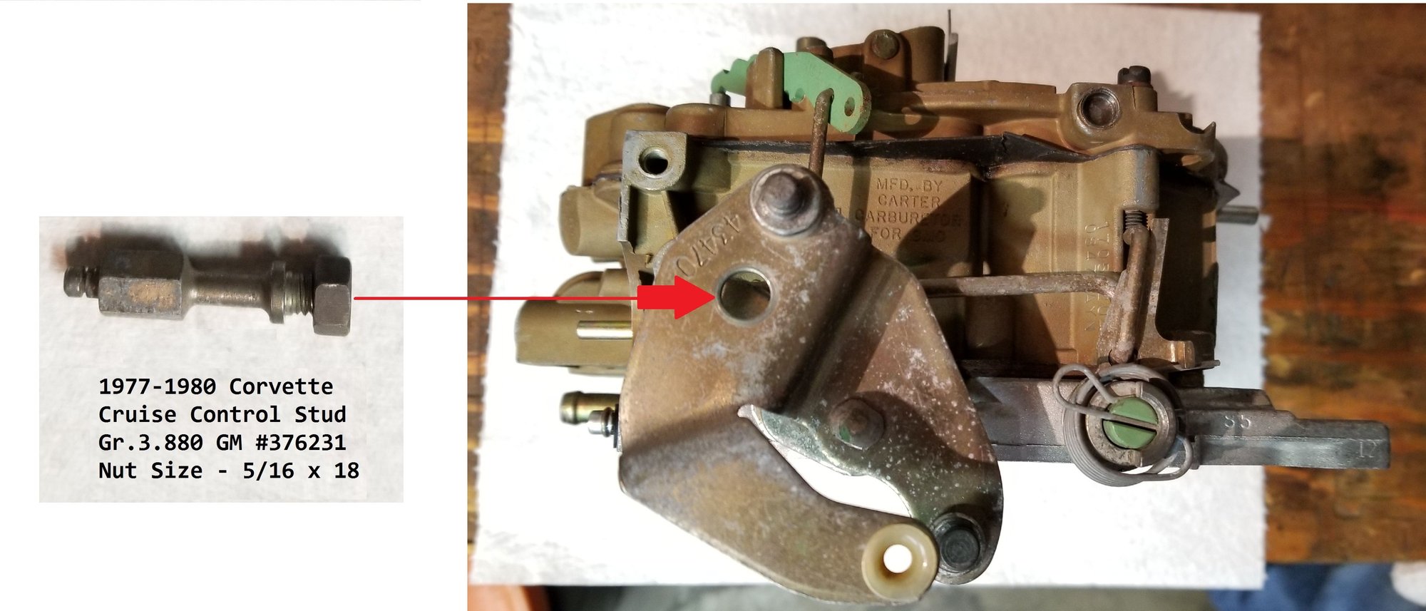

That's where I thought you had the Cruise Cable connected, that is incorrect!
Here is the correct part and where it should attach...
The place where the cable is attached to now is for your throttle return springs...See the nylon bushing in the hole?

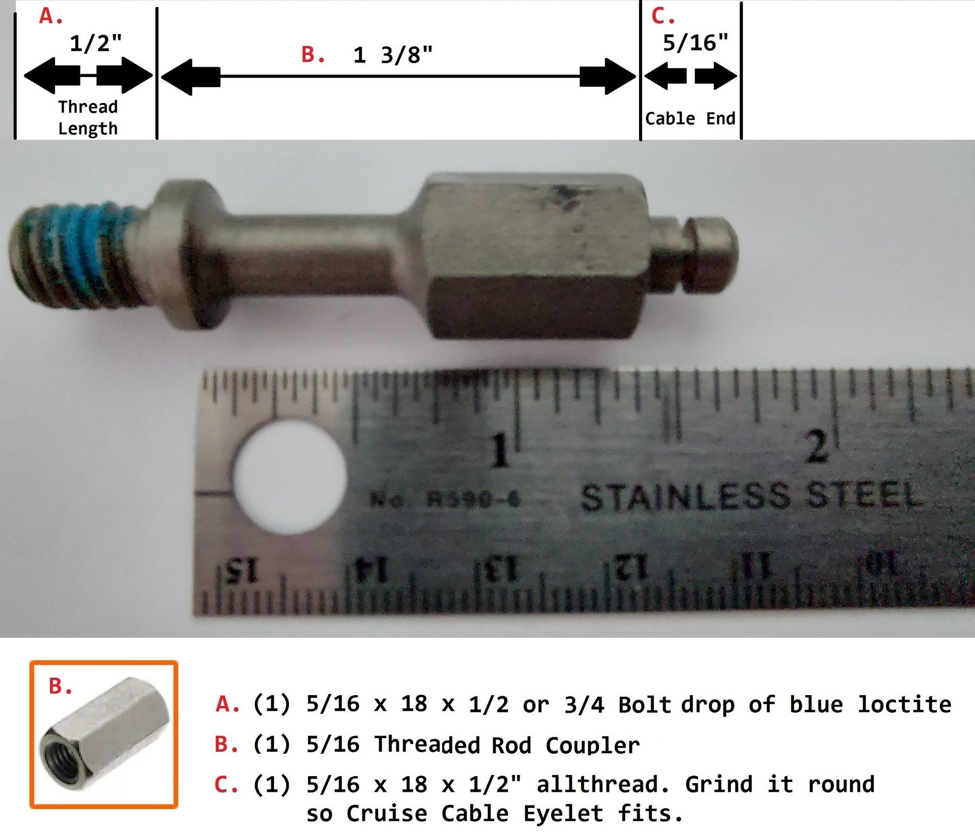

You want to know how I would fabricate that cruise stud you are missing?

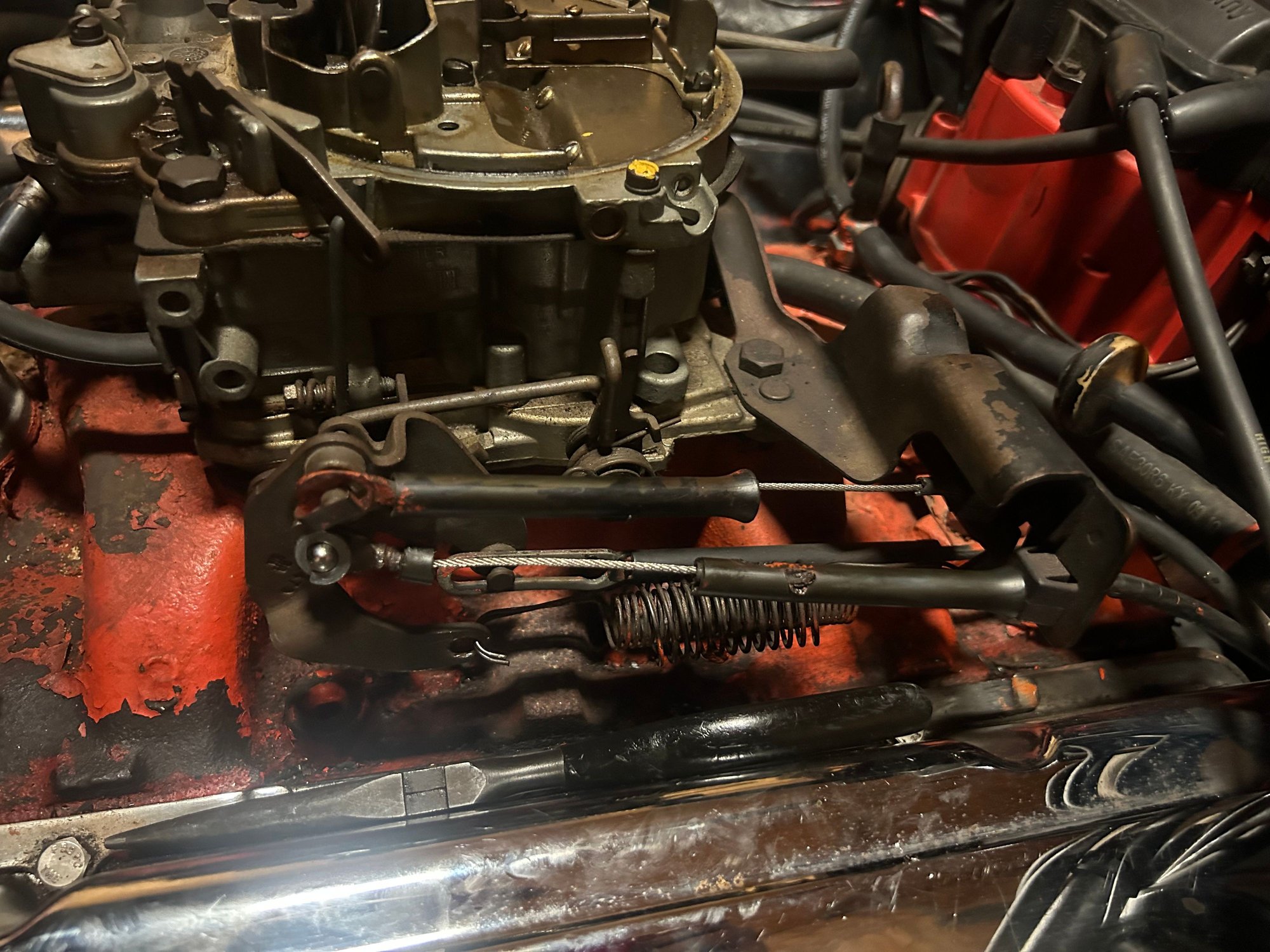

would love to know, but first. I loved the spring to the hole where the last photo said it should be. Now it is wide open and won’t return.

Change your spring to go from where it is on the carb to the red arrow hole of the support bracket......
You can pick the 5/16 x 18 threaded coupler up at Lowes, HD or Ace for under $3.00

If you have any questions on what parts you need to fab up the cruse stud, ask away...

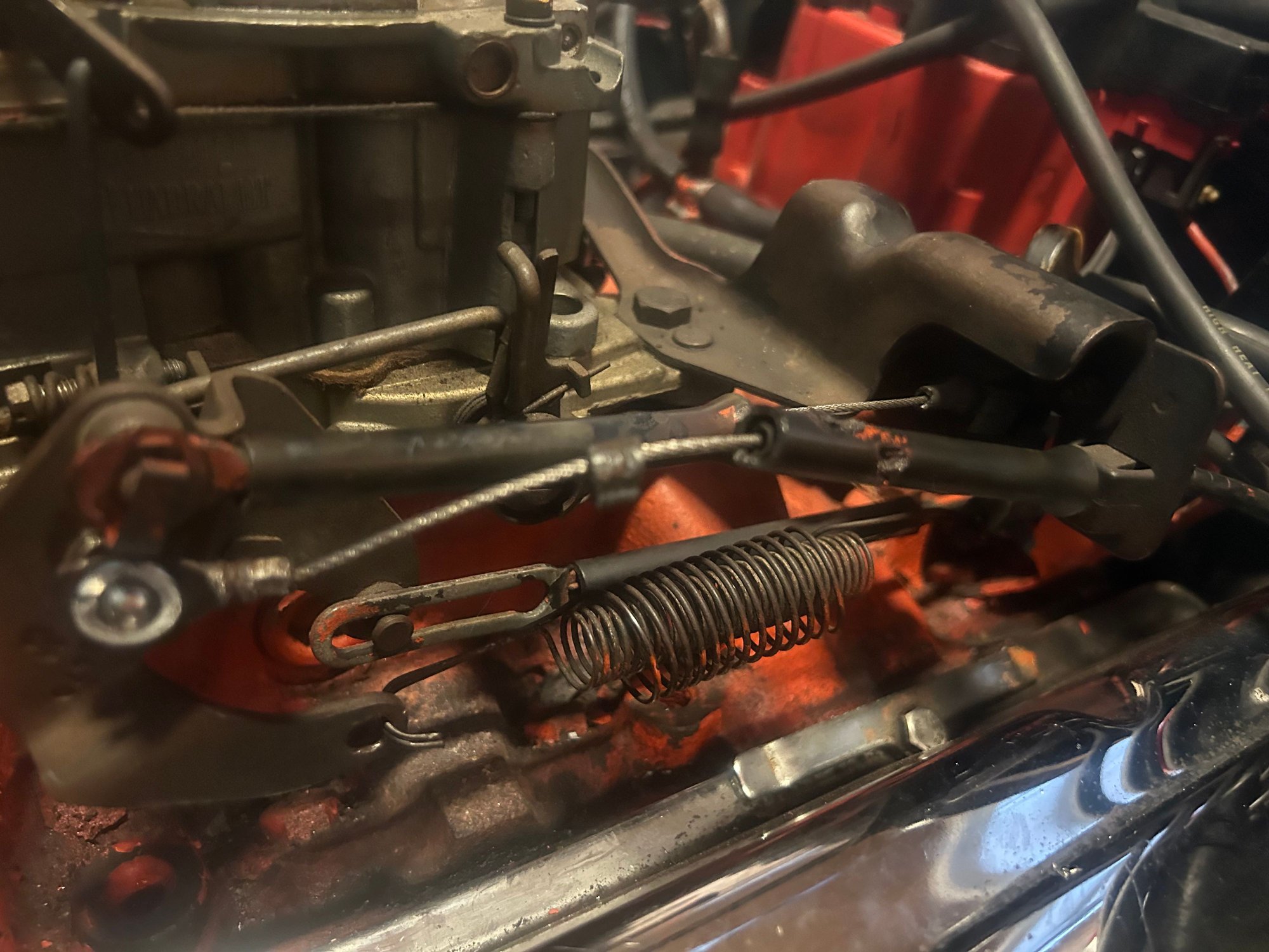

Okay cool, I’ve got the setup right. Now I just have to figure out how the cruise works. 1. When the engine comes on, is there vacuum at the servo? 2. Still trying to understand your explanation of adjusting the chain length. With the cables and spring on the carb fixed and the cruise cable in there, there’s still way too much chain.

You just going to through crap like that on your Grandpas vette?
The geometry of that is not going to work...
You can do better than that!
