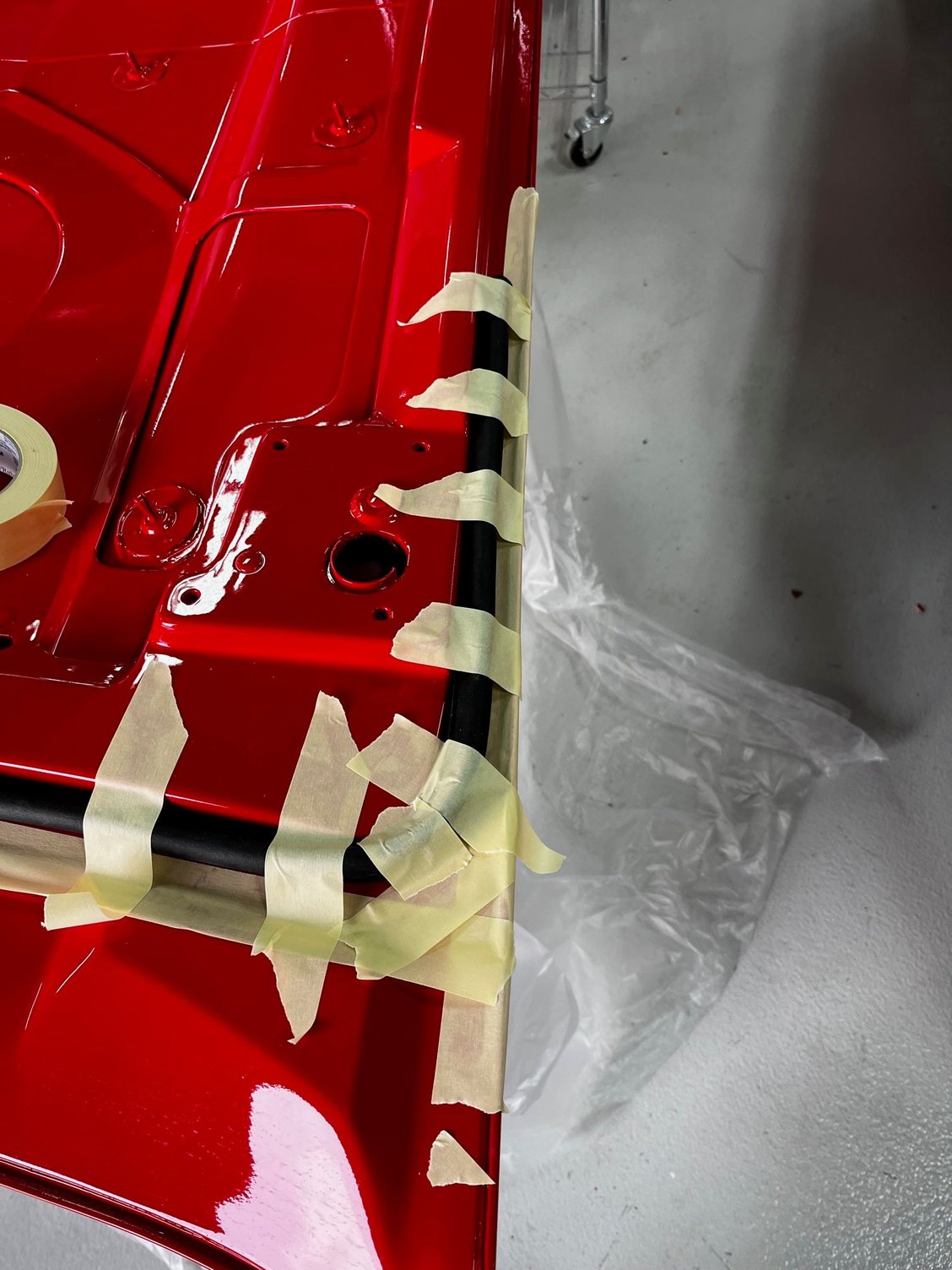

I recently purchased the entire weatherstrip and seal kit for the 73 that went through an entire repaint. The seals and weatherstrip all fit real nice and sealed good. No issues at all. Great technical support when needed. I'd buy from them again!
My 2 cents

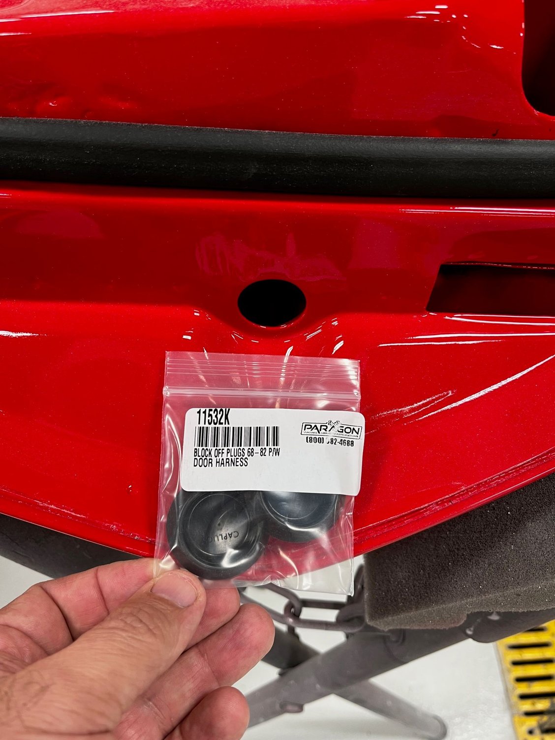

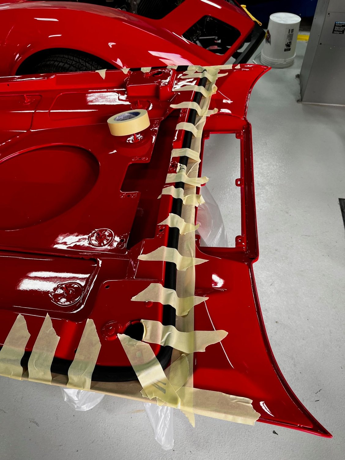

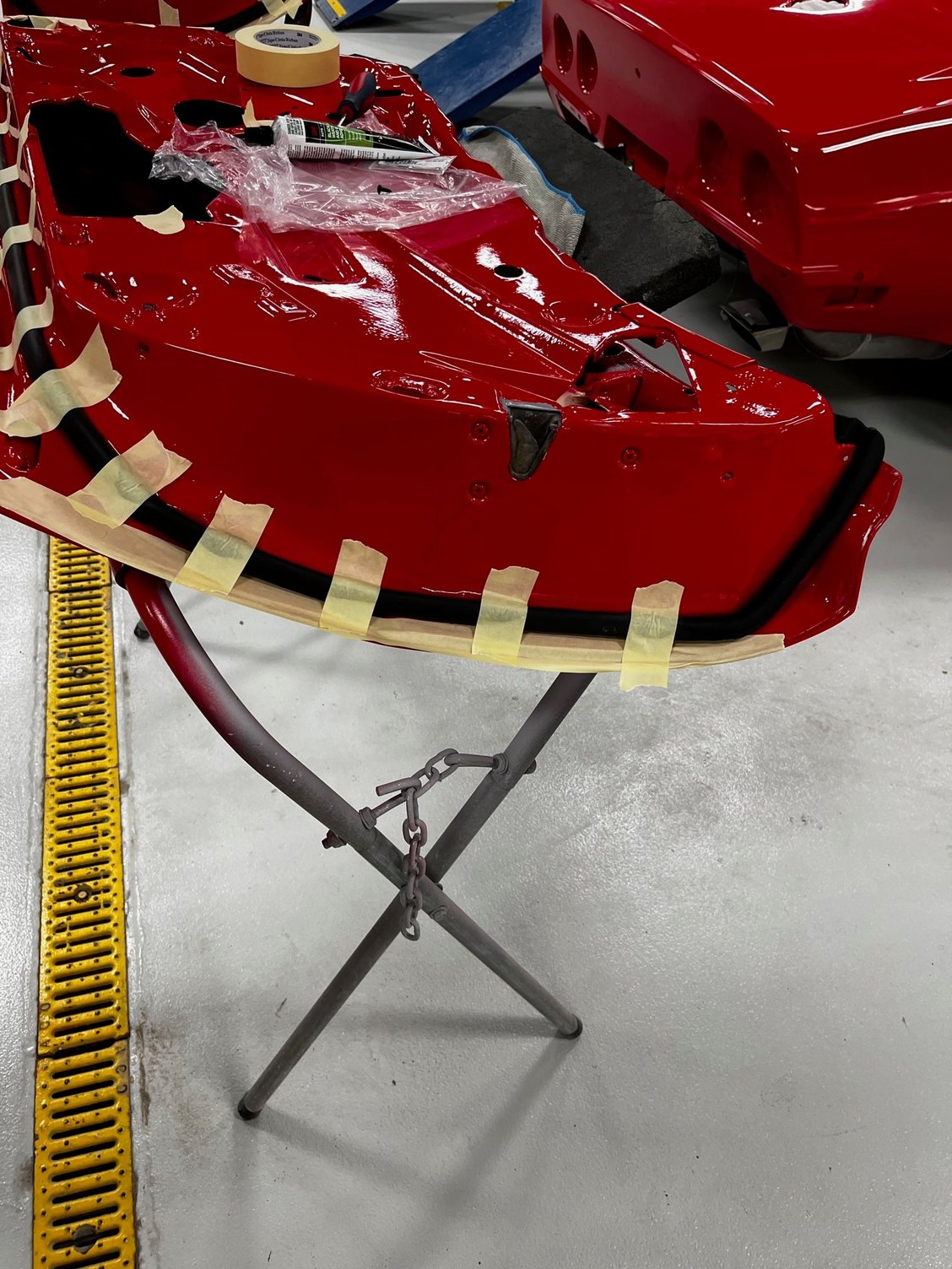

I purchased the entire weatherstrip kit from either Corvette Rubber Company directly from their website or from Paragon. Sorry I do not recall exactly.
I've added a few more pictures of my weatherstrip installation. Hopefully it helps.
Best of Luck
PutTogether
Best of Luck
PutTogether
really nice. thks for the picture. just saw Paragon is/was acquired by Corvette Central....where I can find Corvette Rubber components.
