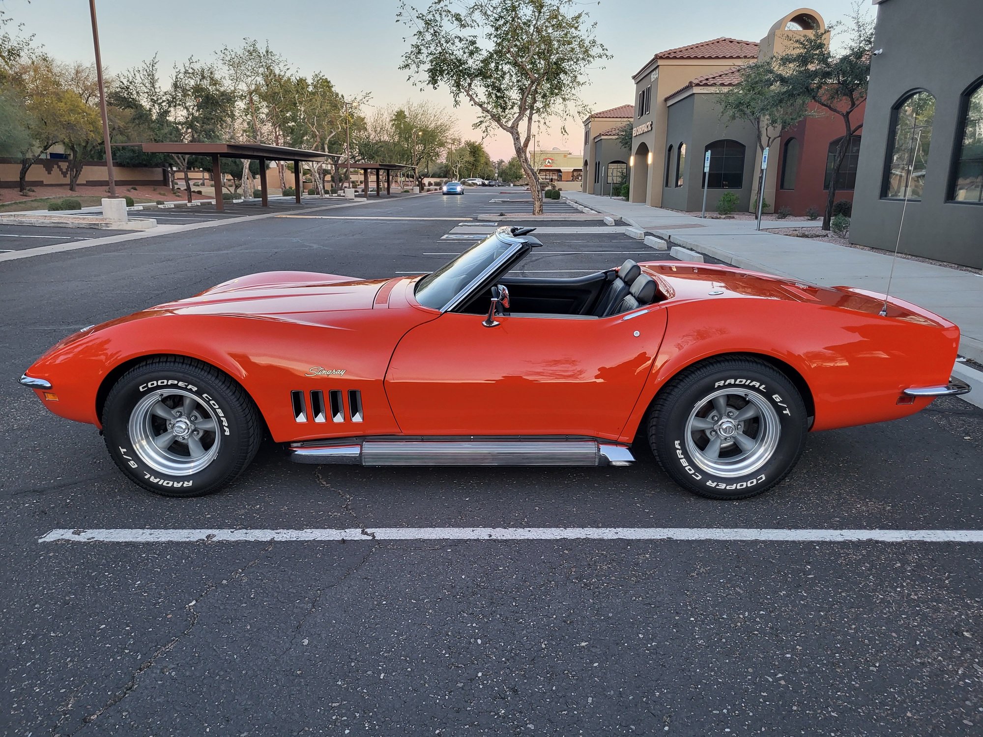

I'm trying to post a pic for the first time on here. If this works, this is the car from about 10 feet away.

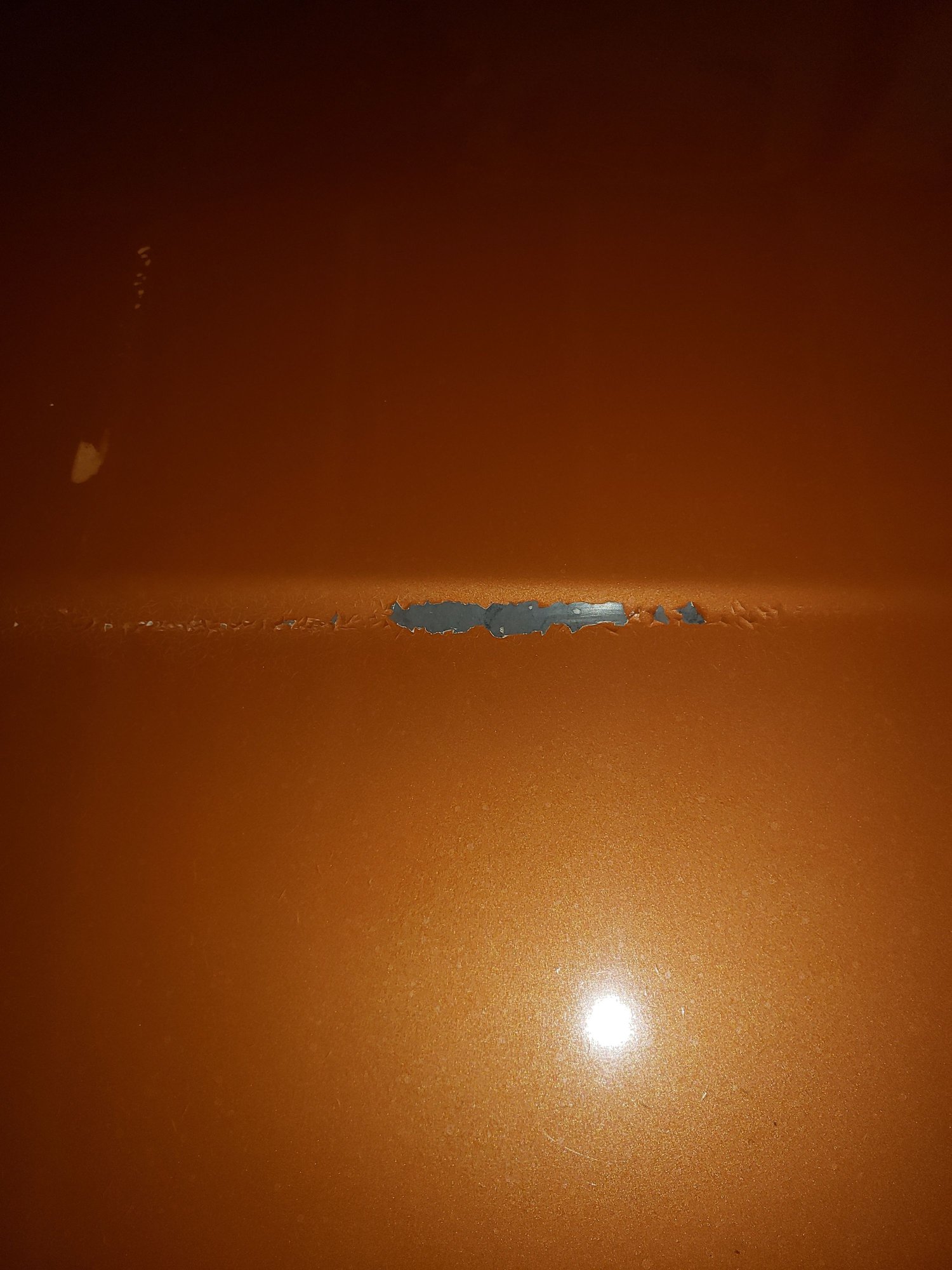

This is the Hood.

if it's isolated towards the center of the hood it can absolutely be blended with bc/cc and just the final coat of clear being taken out to the edges of the hood if the color is matched well.

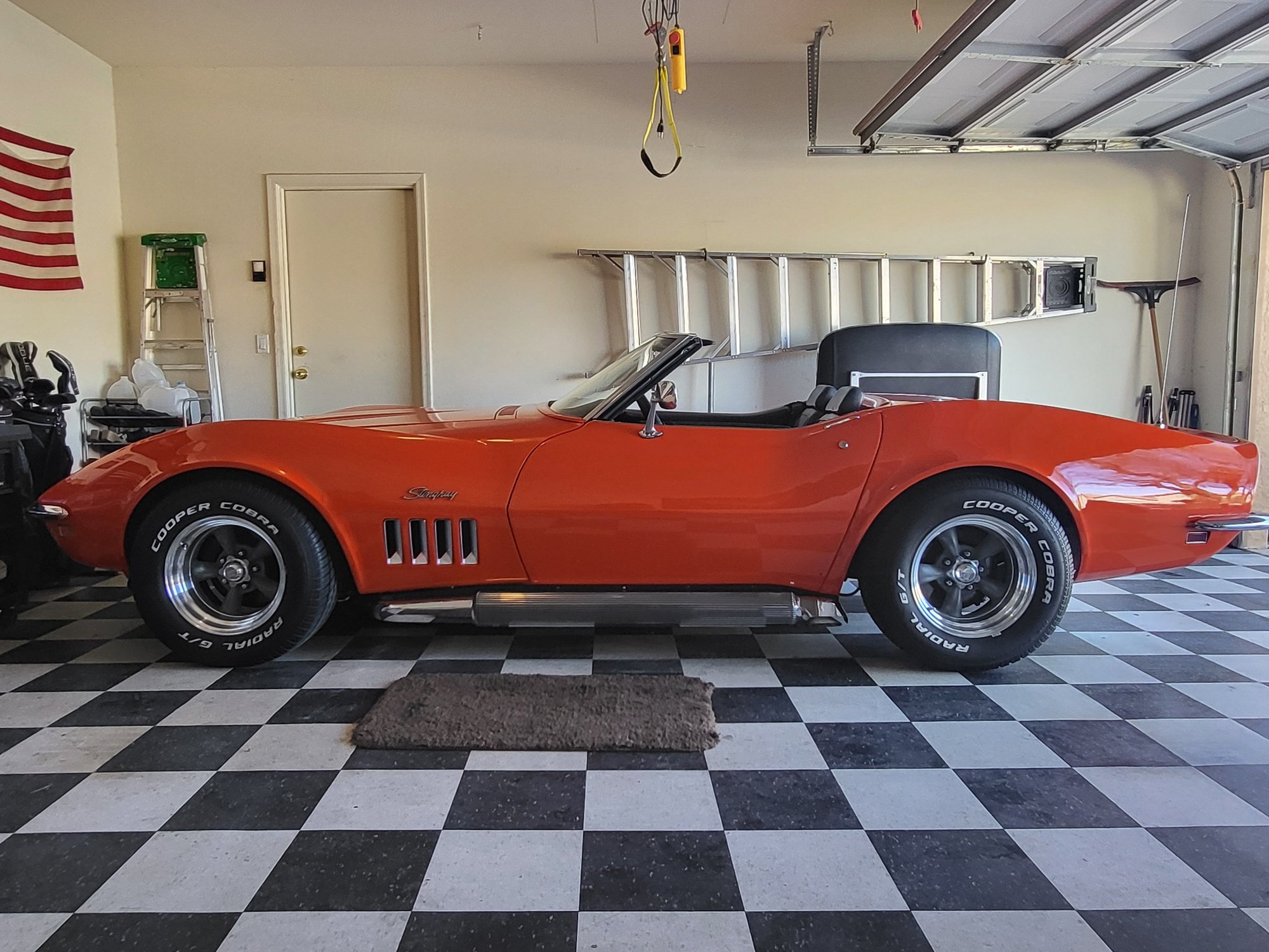

you can see here o​​​​​​n the 69 the outside photo if you zoom in has cracks on the front of the door, the inside photo is after I repaired and pinted, color matched and basecoat blended with clear to the end.

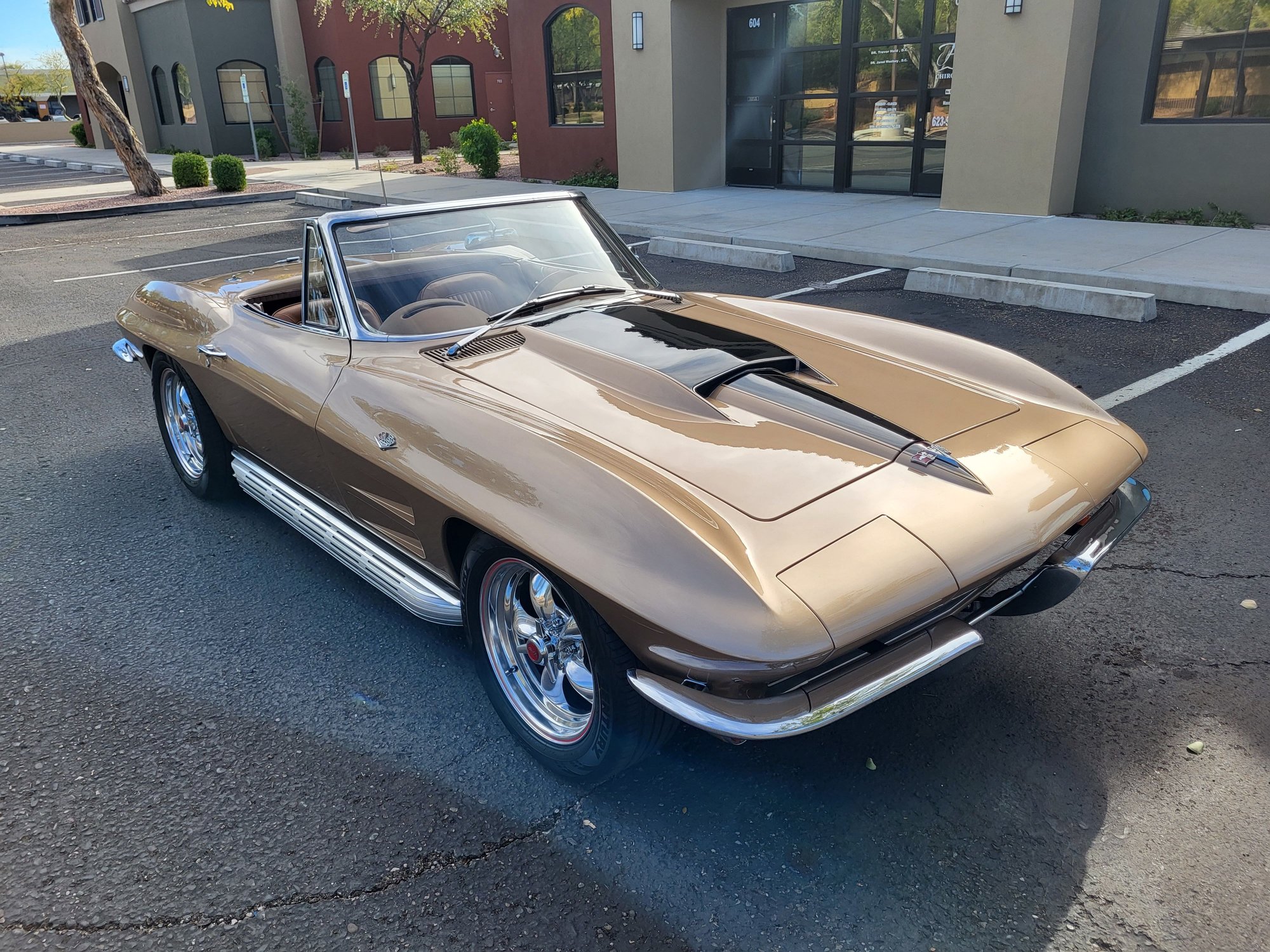

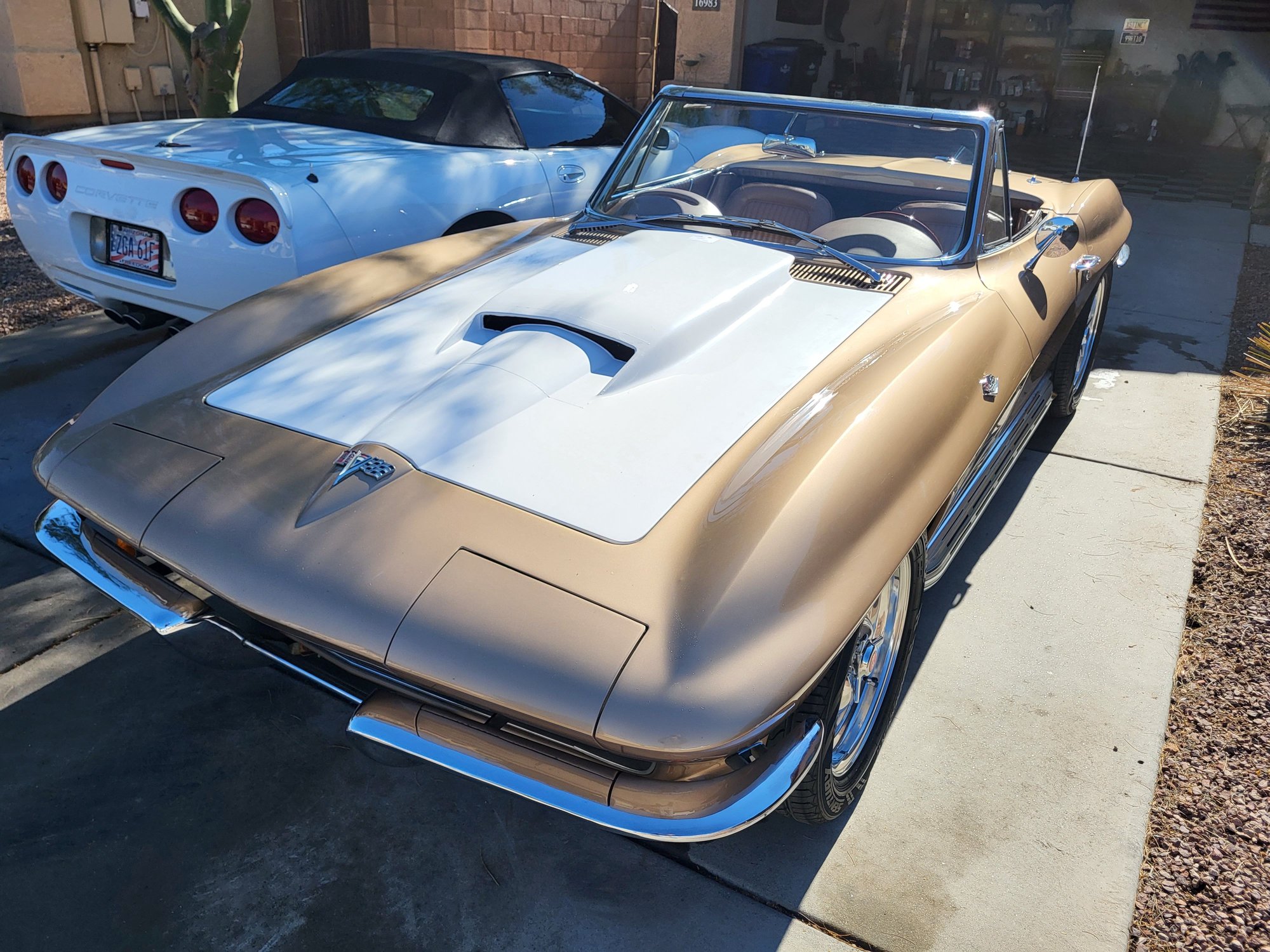

the 64 after I installed the hood, the gold is blended into the surround panel and cleared final coat to the ends of the fneders.
both had 20-30 year old paint on them (64 older)
