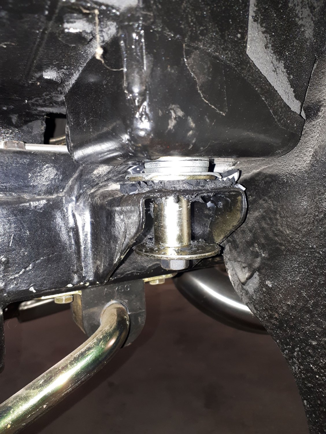

If you bought urethane body mounts check them. Getting car ready to go for safety, backed out of garage and found what was left of my body mounts in the driveway. Car has only left the garage when it went for exhaust. It has less than 1km on them.

just changed out the rear dual mount cushions & built my own & installed this morning
Just crumbled, can the manufacture be held responsible if this causes an accident ?

Likes: 4,507
Wow! So 1 km on the road. When were they purchased, and when were they installed?

They were installed in 2013 when I dropped the body on the chassis. The car has been in a heated garage while I finished it up. Here's what's left of all 8.
I also have poly in some of the suspension and they were installed be for the body mounts and still look like new.

Yikes! Is it possible those were old stock from the bad batch of that period? I haven't had any issue with Energy Suspension components, but the oldest bushing on my car is from 2017.
