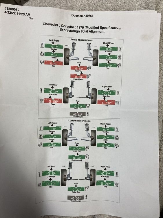

Op… i thought you said ball joints replaced and aligned? Do you have the printout mentioned earlier in thread?
i have ZERO track experience and my comments are to your loose darty comments..
i would look very closely at ALL bushings but particularly the rear strut and trailing arms.
i would also research heavily the experience of the alignment shop especially adjusting the rear. They will not have the correct shims you need to buy some. If you find the right guy stick with and tip well. Even chains may have some competent guys like i found.
I have basically OEM components and the factory best (reset in picture) alignment specs and have zero issues with street performance even hard turns. I am not saying more castor etc wouldn’t be helpful but I’m not sure i would change a thing on mine..it drives down the road and steers stable like a new car.
i thought my rear bushings looked worn but not that bad??? Guess wrong

Oh yeah! What happened to that alignment printout? Call the shop that worked on your car if you have to.
