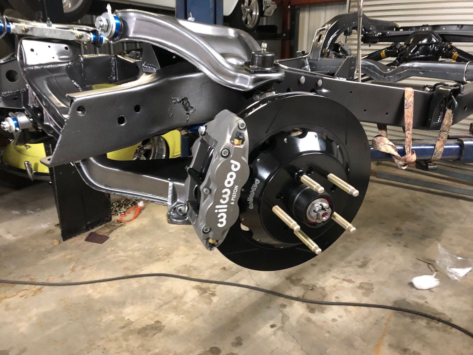

My buddy is the crew chief for an off road pro 4 truck they have Wilwood for a sponsor. His wilwood tech guy put my braking system together this is what I got
He said drilled and slotted were for looks mainly he was not a fan.
