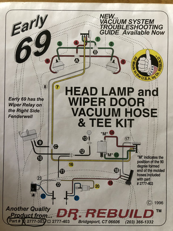

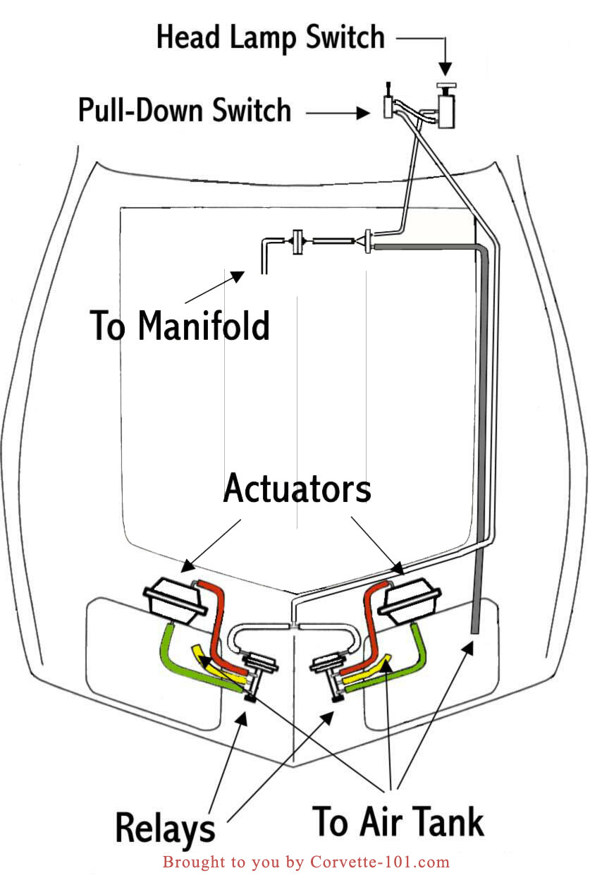

http://www.docrebuild.com/dr-r-web/DROOPY2.html
'68 and early '69 has ONE headlight vacuum relay, as above. Later '69 and later years have TWO headlight relay vacuums, as below.
