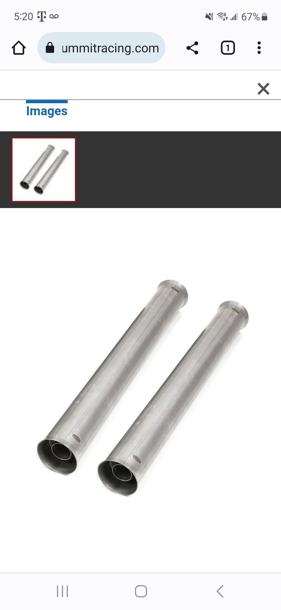

thanks wwiiavfan, i took a DA sander with some 80 grit to the outlet end and removed the burrs and a bit of metal and they went in with ease, I hammered the last bit with a wood dowel snug and they fit perfect... the inlet end is a bit bigger so they wedged in nicely.
Drivers side header is in so going to get some anti seize tomorrow and will slide the pipes on the headers before tightening everything.
Thesw inserts looked like this, no cuts on the end
Thanks again
