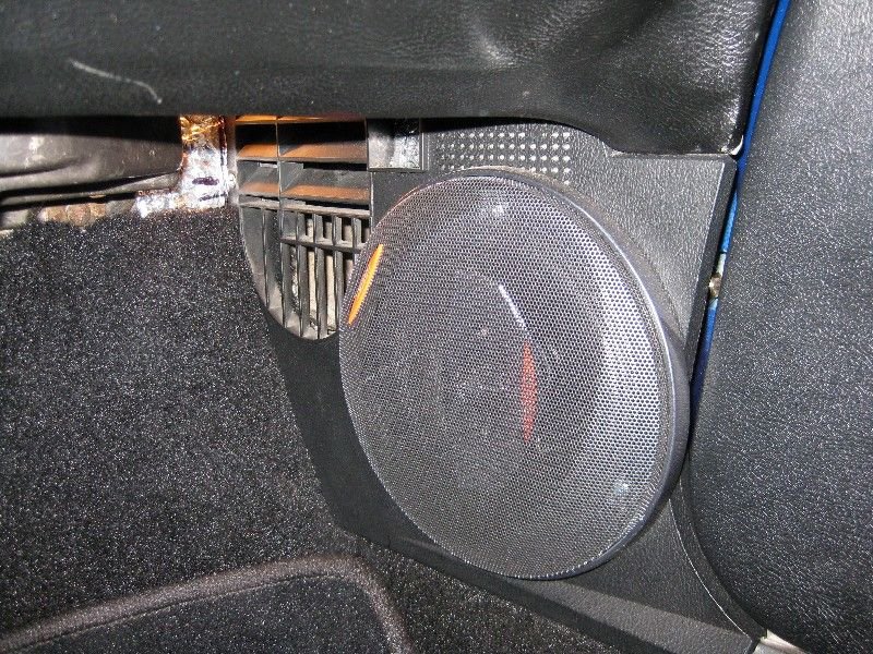

I actually put 6-1/2" speakers in the kick panels of my '73. They had to be mounted on top of the kick panels rather than behind them. I had to carefully measure the pocket in the bird cage to make sure the speaker magnet would fit. I also had to measure carefully before cutting the kick panels. This was back in 2009 and I used Boston Acoustics speakers model #SL65. I also put their S75 4"x6" speakers in the stock dash location and custom built a subwoofer enclosure over the rear wheel behind the drivers seat. I used the head unit to drive the dash speakers and installed a 4 channel amp for the others. Bridged the amp for 2 channels to drive the subwoofer and let the other two drive the kick panel speakers. All in all, I get great sound out of it. Now I just need to tame an exhaust drone so the sound doesn't compete with the stereo.
The speaker grills overhang the door panel just a bit but have caused no issues.
I sourced the entire system from Crutchfield.

Awesome, it looks great. Very clean install...
