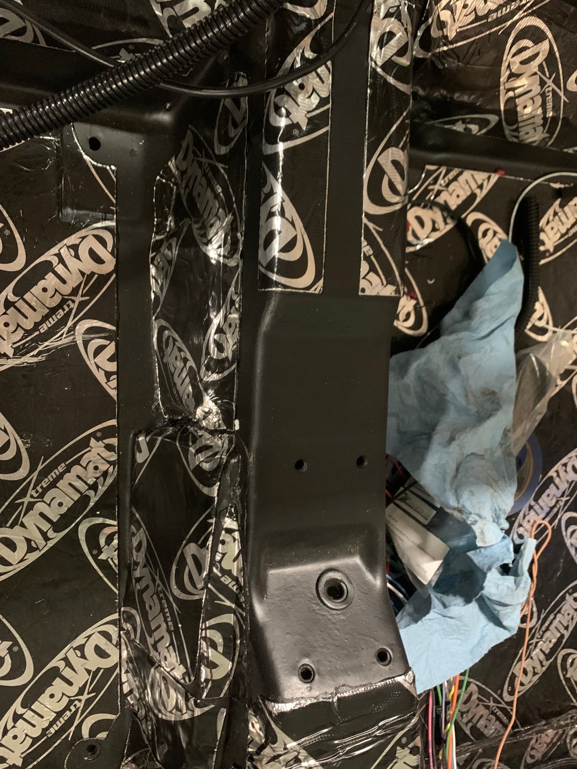

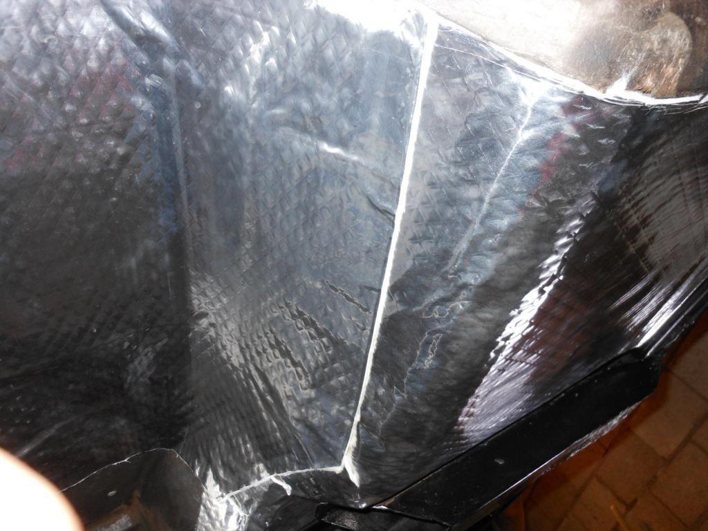

I'm doing both and yes you need it. The tunnel will get hot especially with headers.
I used 2000 degree adhesive /reflective material on the bottom side instead of the stock tunnel insulation. It is much thinner. Not sure how effective it is though...
I'm using dynomat and high quality carpet insulation in the cabin side.

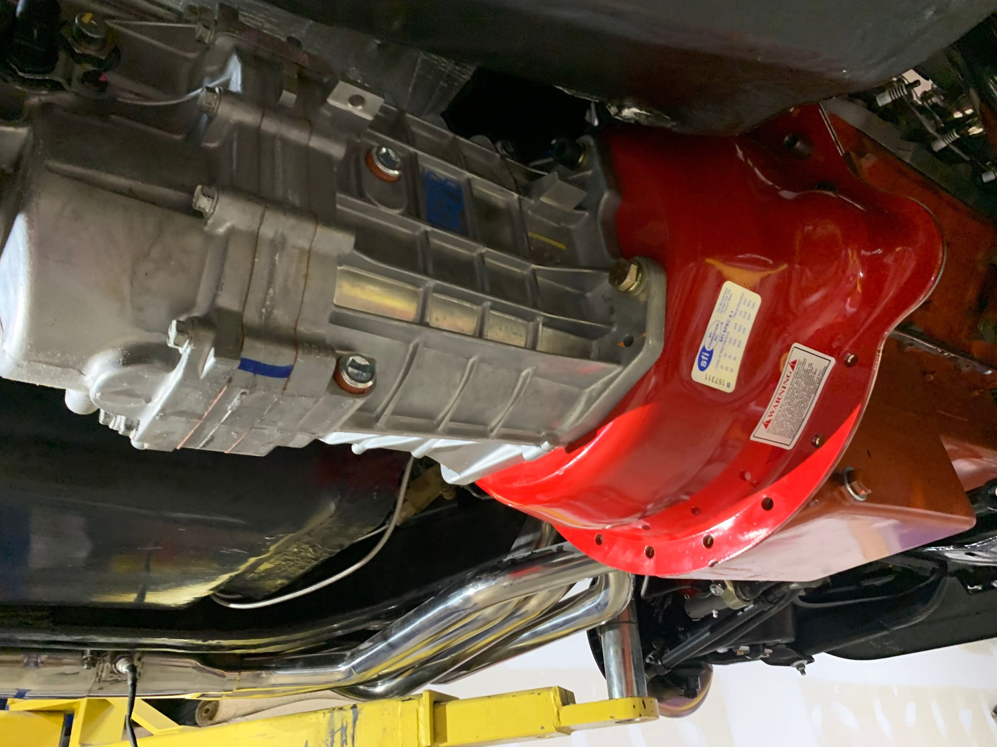

Horseshoe collar (or pool noodle) is #1, aluminum heat shield/bubble wrap on the BOTTOM of the transmission tunnel.
The factory "heat shield" was this foil-wrapped cardboard thing. 99.99% of them have gone MIA in the intervening years. Doesn't look real waterproof; I've got one
sitting in my garage! Impossible to install without dropping the tranny.
Thing is it would have to be installed PROPERLY to do any good --- on standoffs, not just shoved between the tranny & the tunnel. Create a layer of trapped air between
the pipes and the shield, the shield and the tunnel. Trapped air does the insulating, not the aluminum foil which merely reflects heat.
Once the tunnel heats up all the foil wrap in the world applied inside the cockpit isn't going to help. As another stated, the heat shields on the Shuttle go on the OUTSIDE.

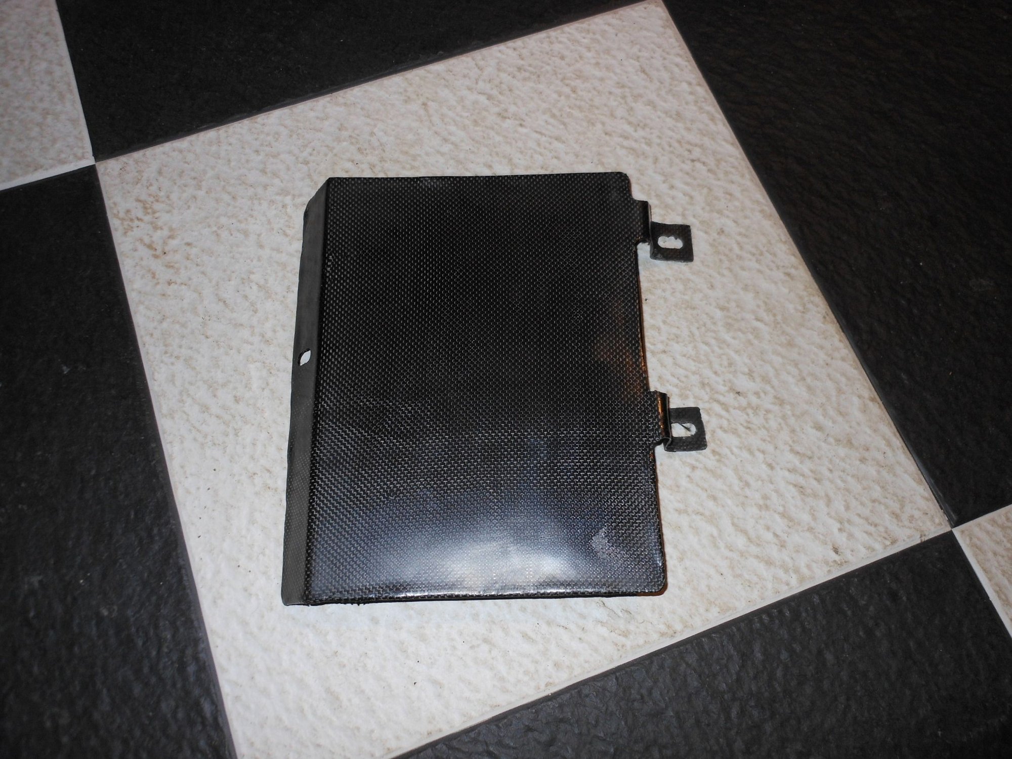

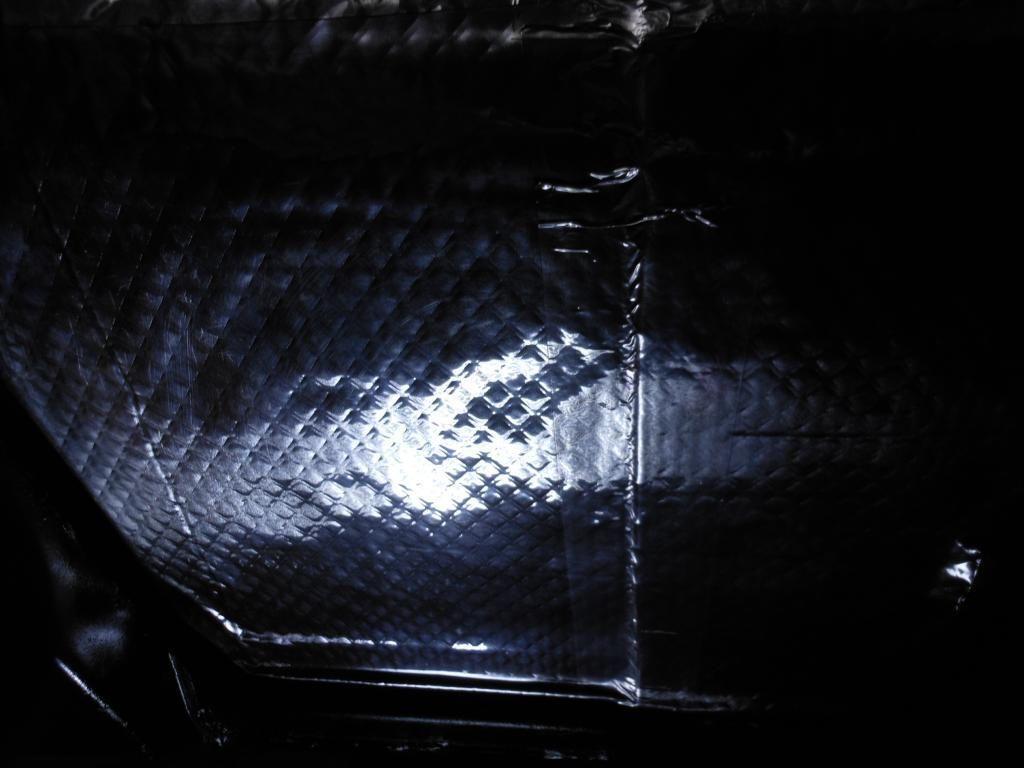

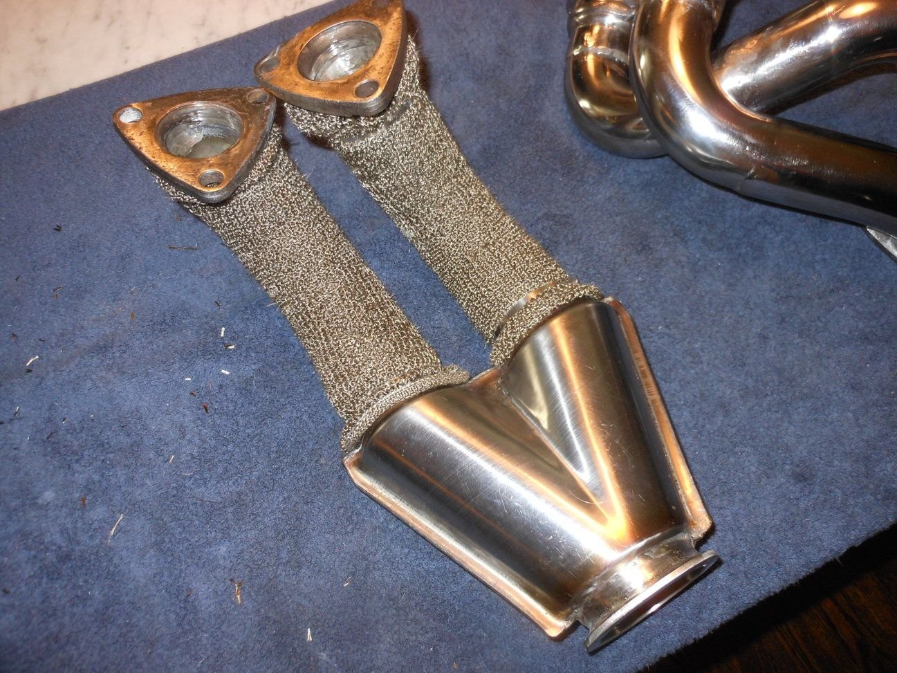

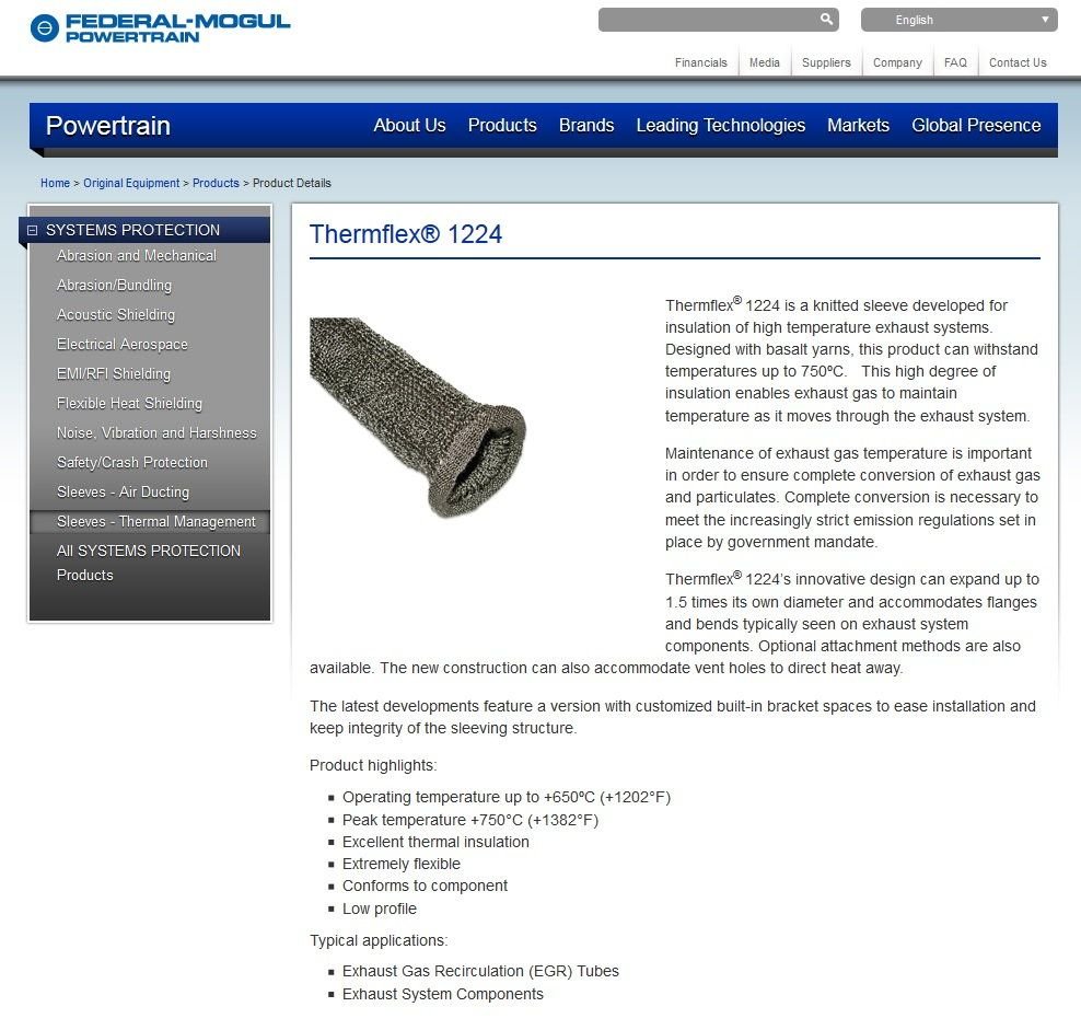

I used Lizard Skin in the interior- IIRC I was the one that coined the phrase- about the space shuttle!
Aluminum foil with an insulator and adhesive to the firewall/trans tunnel.

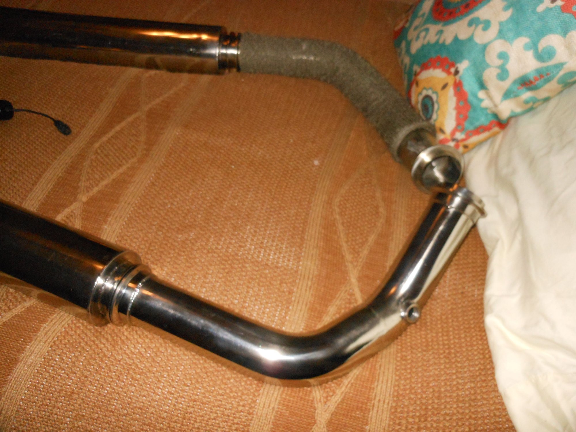

And some basalt "socks"-Federal Mongul Thermoflex on the stainless steel headers and exhaust-
Used 3M foil tape on the seams-

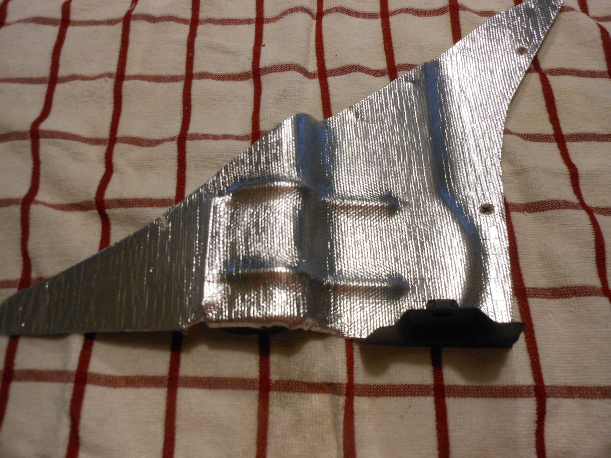

Sidepipes run under the splash shield- so I made it a "heat shield" as my Dry sump tank is above it.
And when I was playing with carbon fiber- I made the firewall heat shield out of it- don't know how well it works- but it looks cool!

Tunnel insulation is a good idea. So is replacing the foam heat shield that installs just behind the bell (or converter) housing on the top-side of the transmission. That kept the engine/exhaust heat from entering that tunnel area. The aftermarket foam replacements are pretty junky. You could make one yourself out of some more durable (and oil resistant) foam.

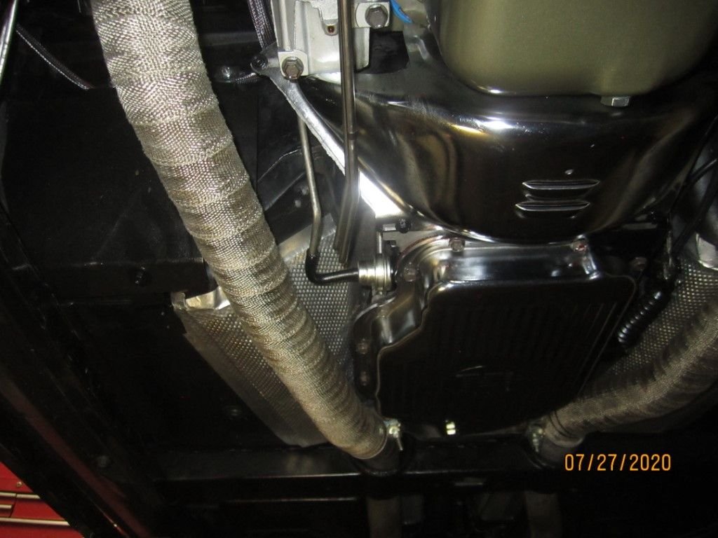

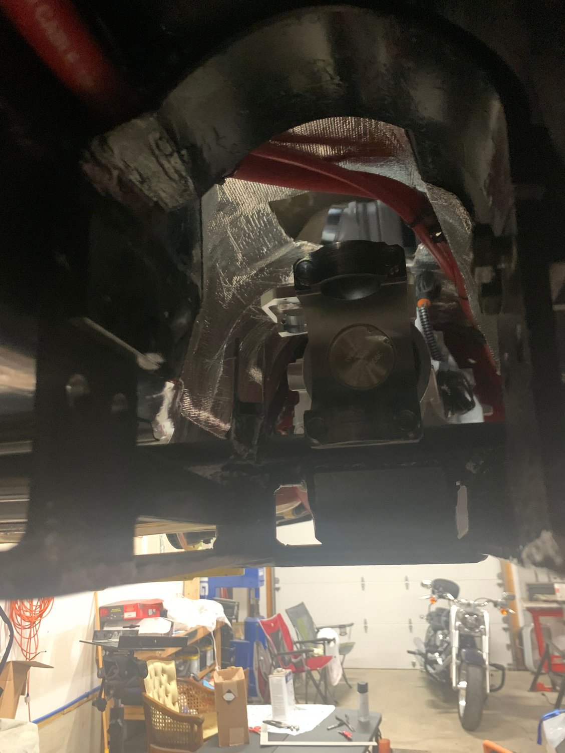

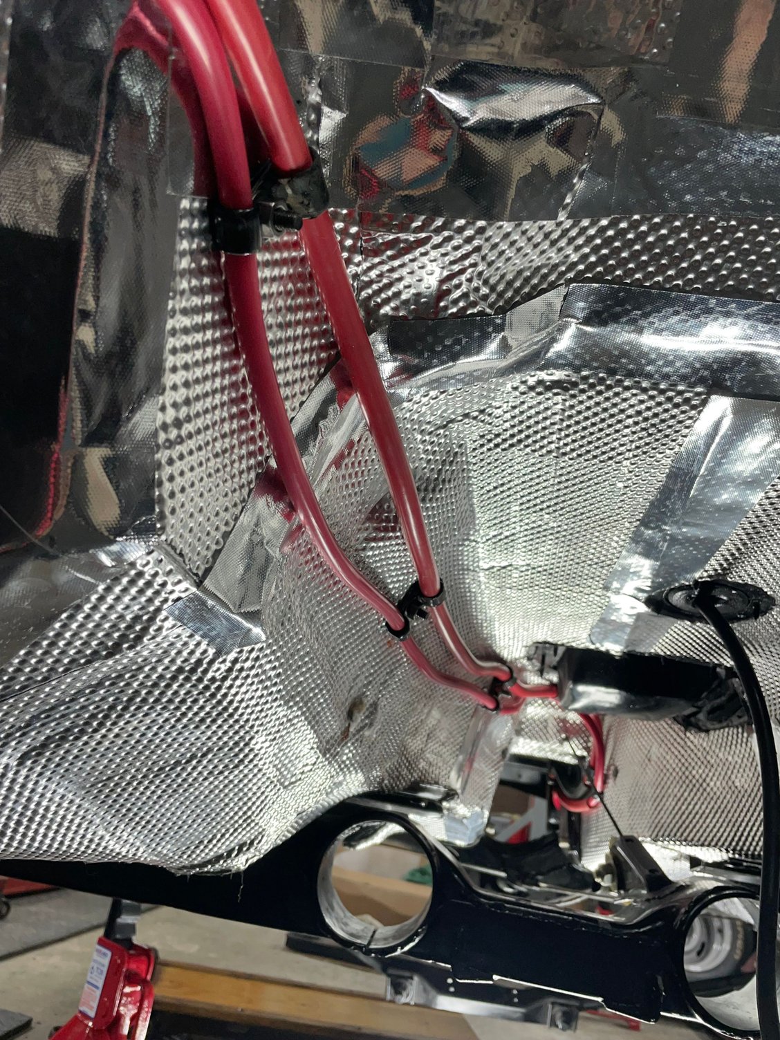

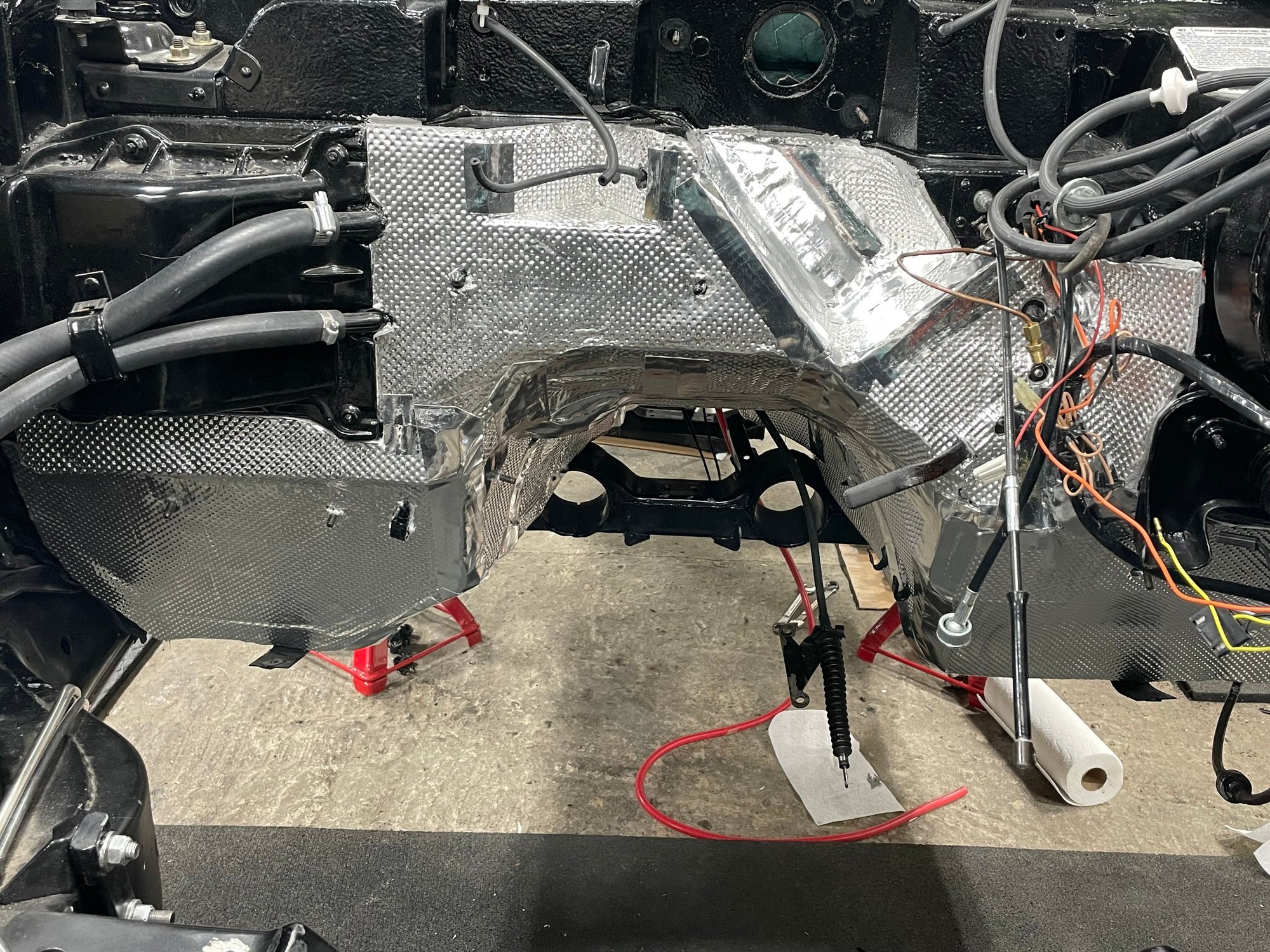

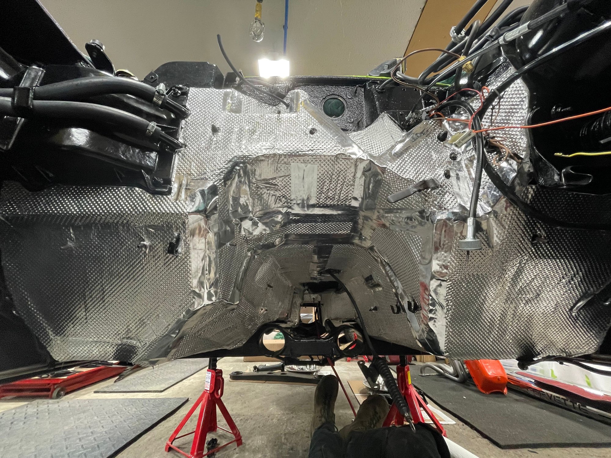

It's worth the effort to do the tunnel on the out side and inside. My Corvette is the second car I have insulated. The Corvette inside was done by the previous owner. It is pre cut and any must have come with the new carpet. I usde DEI in the tunnel. I second the 3M foil tape on the seams. I'm less than happy with the DEI tape I used on the seams

Originally Posted by lickahotskillet
Why are there TWO battery cables?
Very nice job on the insulation. If I ever drop my transmission this is exactly how I plan to do it.
The foil insulation under the carpet in my car was/is next to useless, as best I can tell, but don't try and tell anyone that.
OTHER things I did to reduce cockpit heat that had noticeable benefit: https://www.reddit.com/r/Corvette/co...ed_to_have_ac/
Very nice job on the insulation. If I ever drop my transmission…
Two battery cables: heavier cable goes to the starter. #4 cable goes to a BMW fuse panel to feed FITech, cooling fans relays, in tank fuel pump relay, under dash fuse block via horn relay, alternator feeds this board, likely head light relays.
