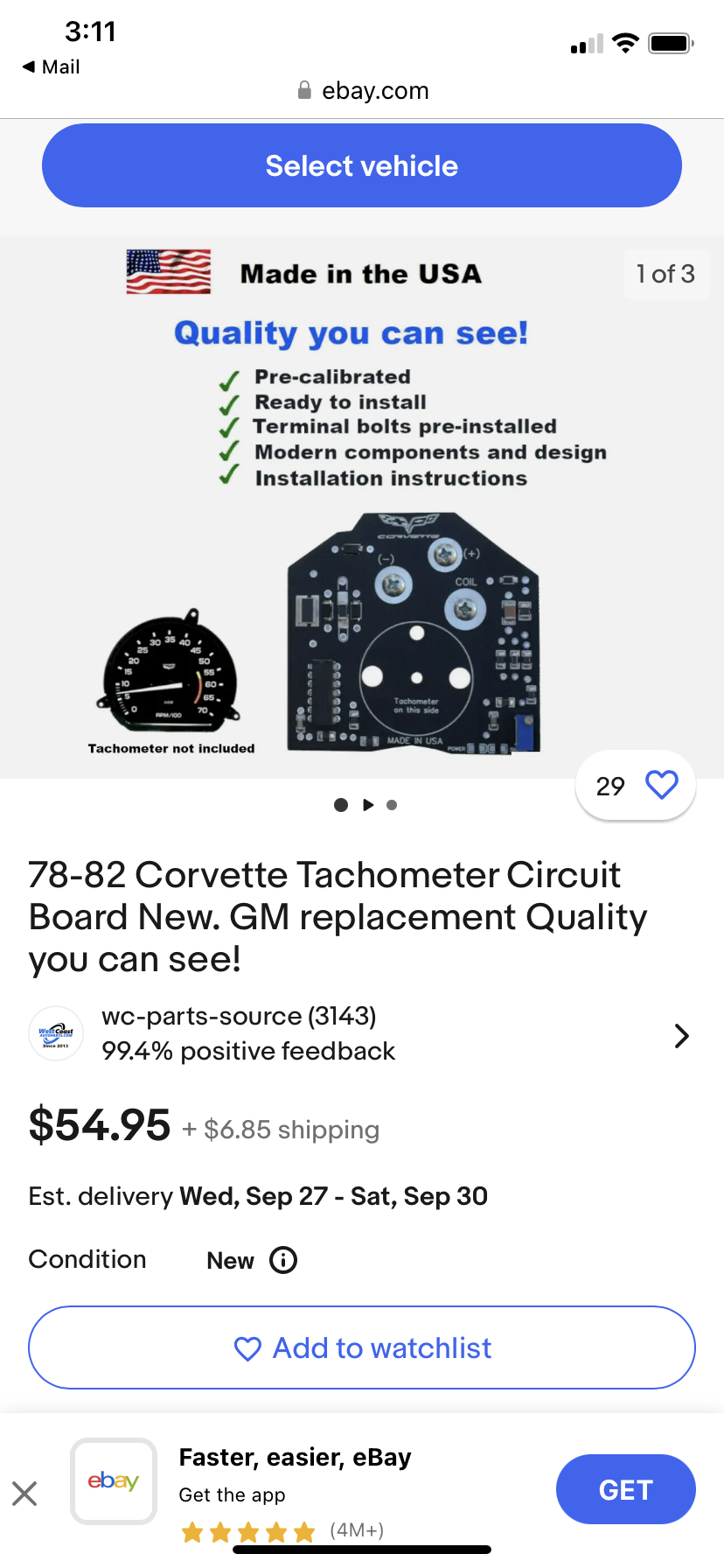

New alternator no change. Voltage spikes probably toasted the board. Ordering a pre calibrated board. Last thing I want to do is reset that needle.

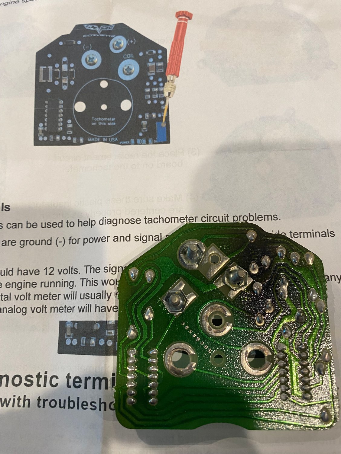

New board worked. I noticed the new board has a potentiometer for calibration if needed. Old board had a burn mark.
