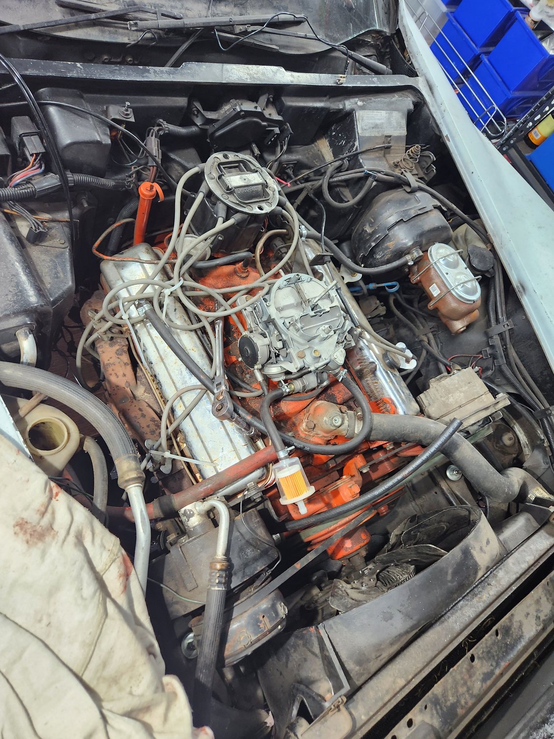

Can someone help me identify this engin block I am assuming it's not original it doesn't have a 3rd belt in the front.
Top of engine bay
# in front of block

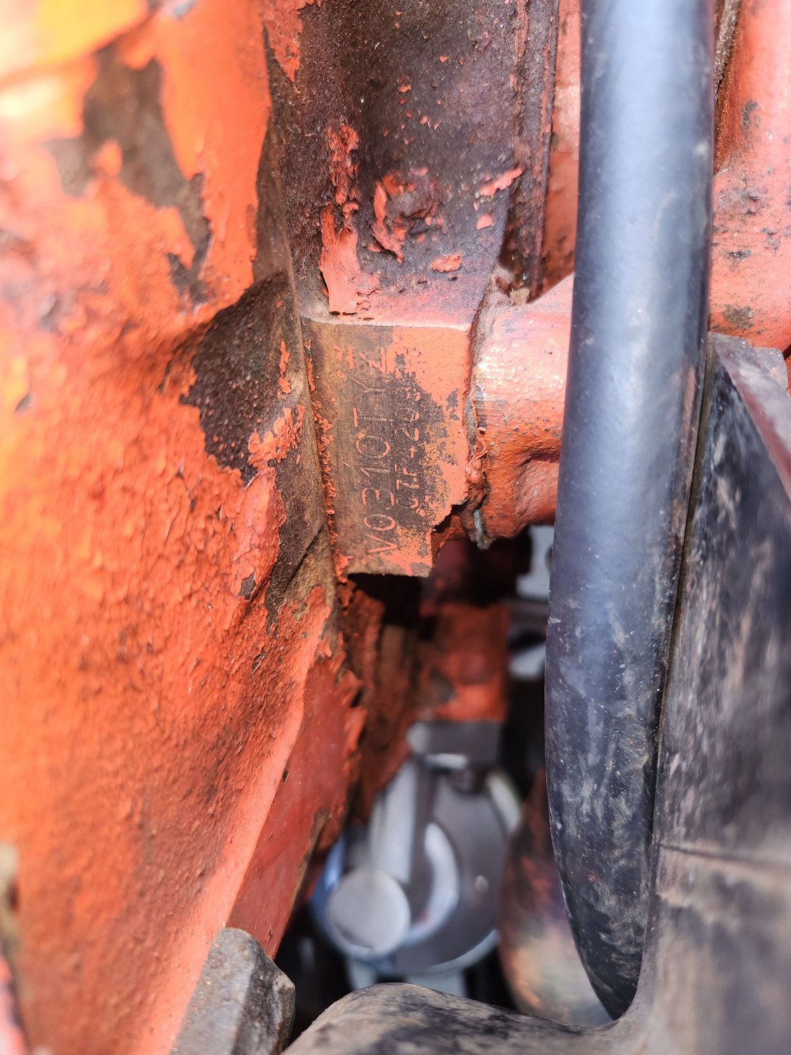

Lime book:
Truck
TYZ 75 350 160 4B,AT TR
TYZ 76 350 165 4B,AT TR
TYZ 77 350 165 4B,AT TR

Originally Posted by BKarol
Lime book:
Truck

The small pad further identifies it as a 77 truck engine. 76 and earlier small blocks have a longer pad, almost as wide as the head. The 4bbl truck 350 was basically the same engine as the 73-80 Corvette's base L-48 350.

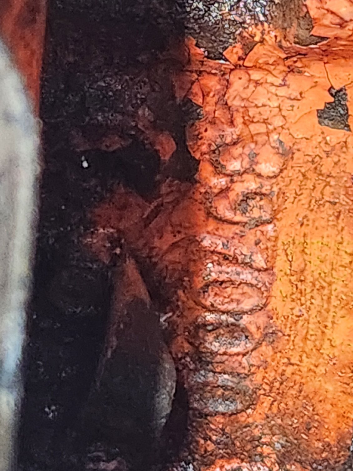

This is back code didnt find anything in green book! I will try and try agin to fiuger this out!
What’s to figure out? It’s a truck motor from 1977, rated at 160-165 hp, originally installed with a 4 bbl and automatic transmission. What else do you want to know?
Between the engine code TYZ and the second digit on second line being 7 it is as already stated by gbvette62, a 77 truck.

3970010 is one of the most common and longest running GM small blocks......it went from 1969 to 1979 in anything from trucks to Vette's and Camaro's.....
Can be 2 or 4 bolt main but most were 4 bolt.......
