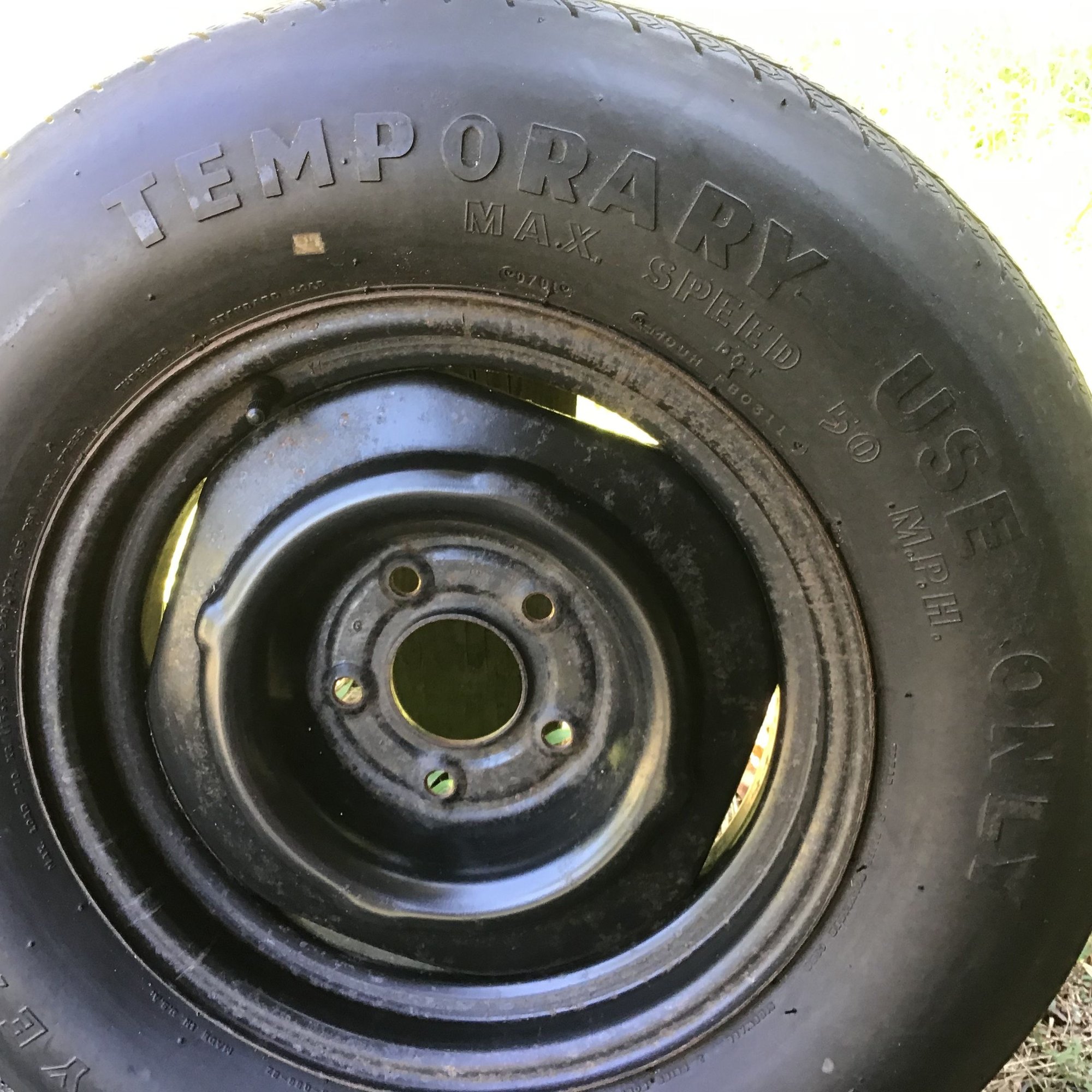

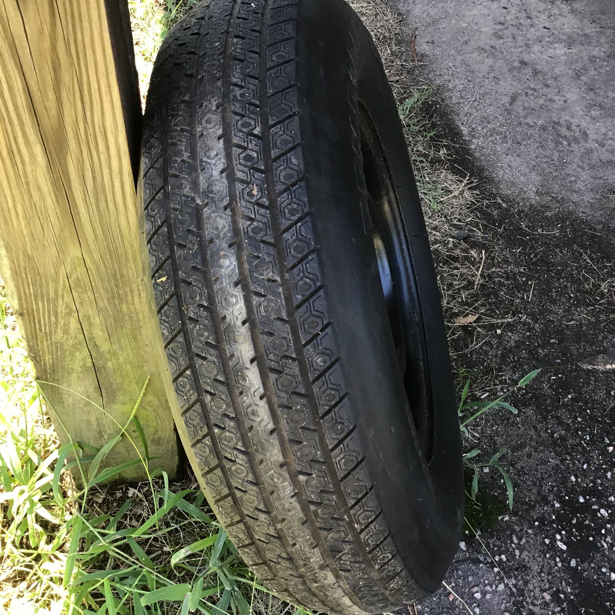

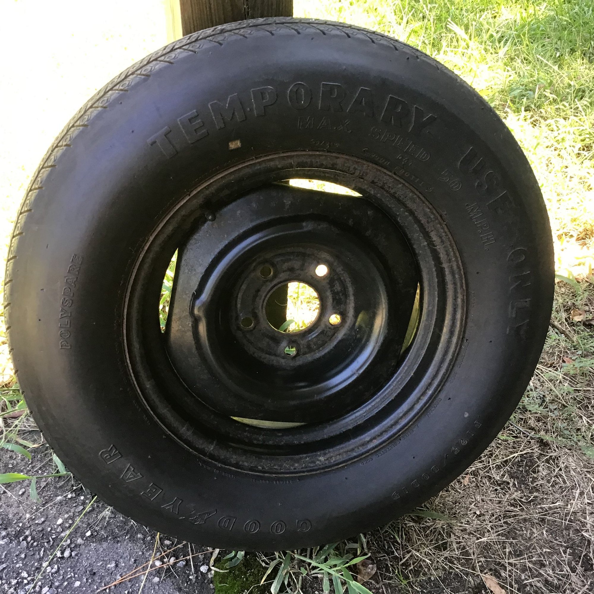

I’m removing spare tire cover,so I can get to the differential pulled spare tire out,I’m assuming this is original.
Old Sep 18, 2023 | 02:19 PM
SEVNT6's Avatar
SEVNT6
Posts: 7,985
Likes: 3,333
From: Omaha NE
For an '81 that's stock...

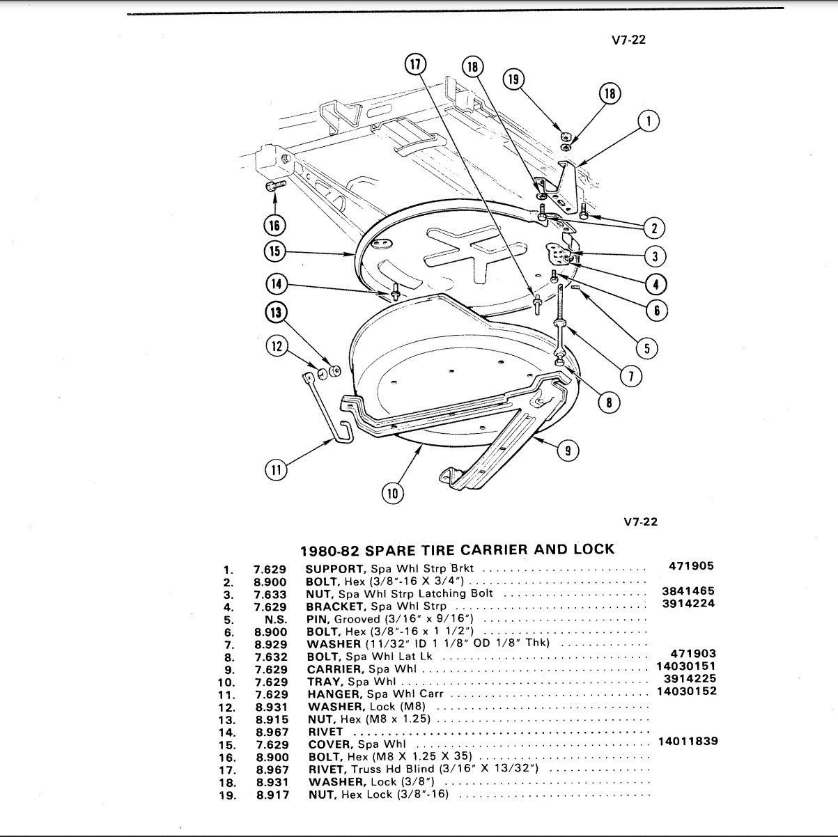

Ok,got the whole thing down except the upper piece,their are two shiney head one on each side toward the back,it’s like a screw of some kind,but only has a tiny hole in center,and can’t pry it apart without tearing cover up,it has 1/2 inch slot where the top slides,will get a picture,but need to get it off,although I could cut the head off.

Is the tiny hole designed for a torx bit, 6 sided hex?

It looks like the top section is riveted to the frame on an '81:
On the earlier cars (like my '78) it's bolted. Possibly not good news for you?

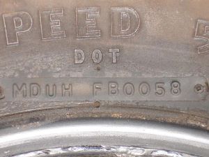

Look here for the date, week and year.( In this case 5th week 1978). Yours looks like 31st week 1981?

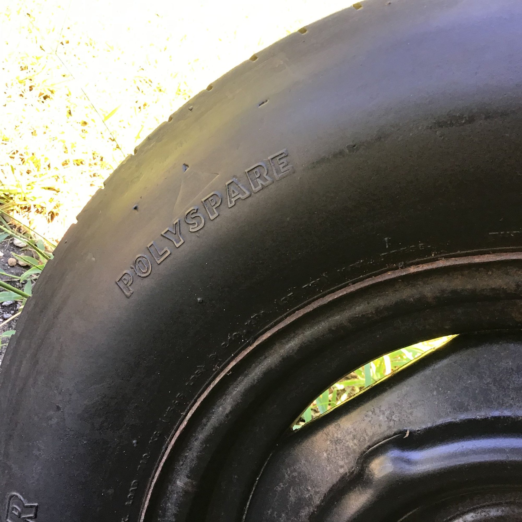

The original "space-saver" tyres were 195/80D15. I found quite a few options available in that size over here, for various applications, both car and light van. I went with a light van tyre, just to be safe, the downside being that it is a good deal heavier than the original, clearly very thin(!), tyre
Interestingly, my original '78 tyre did not carry a date code that I could see, but the wheel did, and is documented in an NCRS paper.

No doesn’t look like torq.more like a square,could be a rivet though.
Old Sep 19, 2023 | 11:32 AM
mikelino's Avatar
mikelino
Joined: Nov 2008
Posts: 28
Likes: 13
Yes, those are rivets. Take a 3/16 drill bit and start drilling into the hole. The rivet heads will pop off. Watch your head. You can re rivet or use a couple 1/4 inch self tapping bolts to reinstall.
