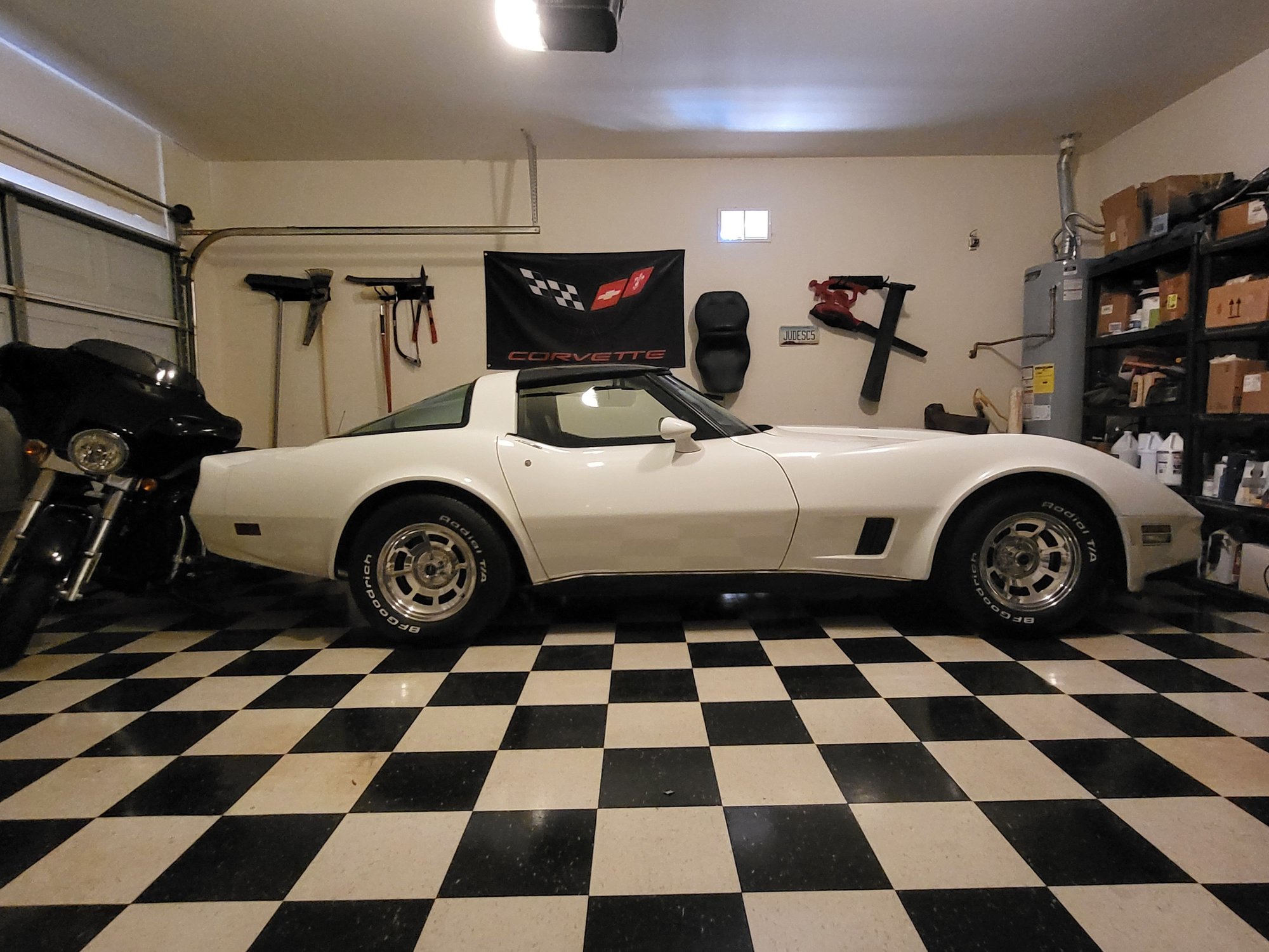

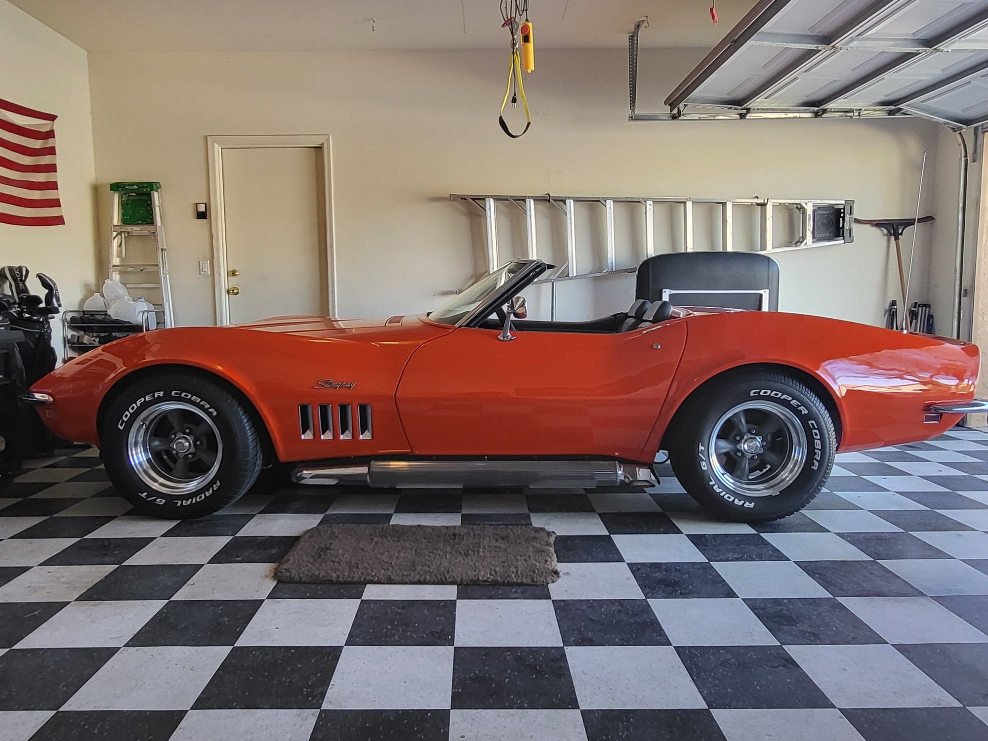

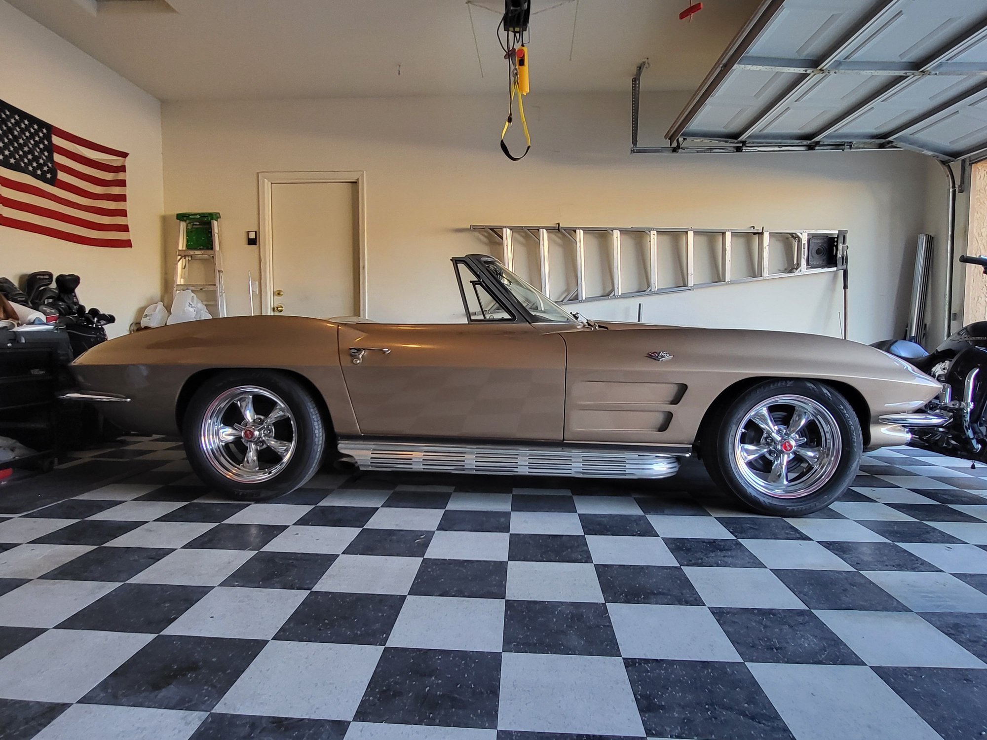

all front ends lowered with cut replacement springs.
The 80 was a full coil
The 69 was a half coil
The 64 was about 3/4 coil
The 69 and 64 were both one time cuts and got me where i wanted the height to sit... the 80 took three cuts in and out to drop it enough, some replacement coils just sit to high for me and that one did.

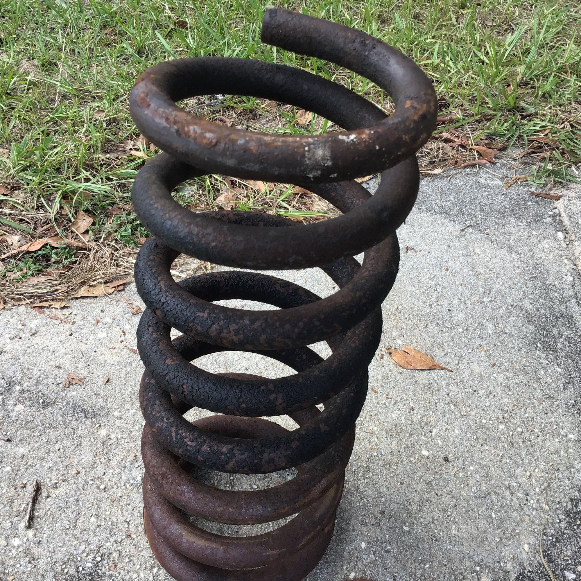

I've always cut equal amounts off top and bottom to keep the same spring end index though not sure how important that is, you will want to index the coil end at the top spring pocket, I drop a screw down the hole in the upper control arm and turn the spring till the end of the spring hits the screw then back it off a touch.
I also use the rule of them "half the height cut gives twice the drop" so stand the spring upright... if you want a 1 inch drop then measure 1/2 off spring height and that's where you cut preferably with a cut off wheel... again if I'm taking a 1/2 coil off I take 1/4 off both ends but that's just me.

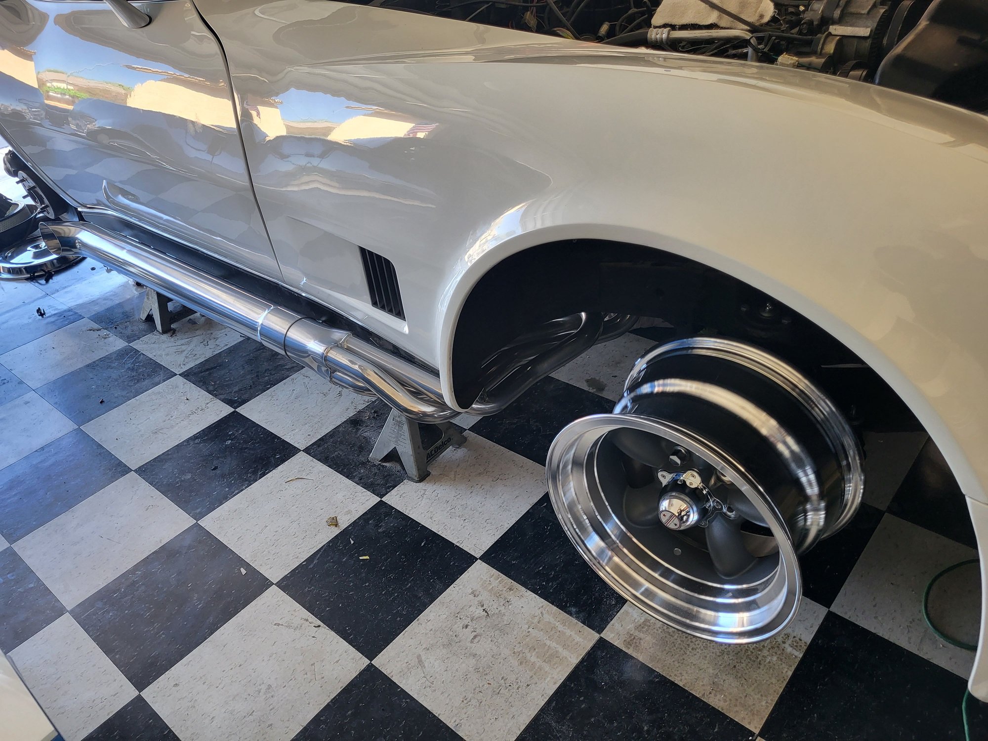

coming along, if it wasn't for work and travel I would be done but no rush, will drop rims off Friday for tire mounting, pass side header and pipe finished and just need to install the drivers side pipe, got a Boregeson PS kit I'm doing as well, just needed to be sure drivers side header would go in first.
