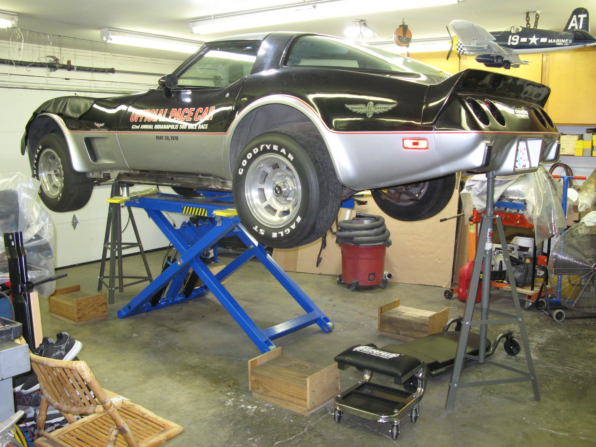

Would you work underneath this?

NO - period !

Those kind of lifts are adequate for suspension/brake work but their design blocks off a lot of the area underneath the car.
I looked at a lot of different lifts and when it was all said and done I chose Quick Jacks.
biggest bang for the buck I found, got mine on sale at Costco for $1299

Assuming those little risers are secured to the outriggers, you should be fine. If not, forget it.
I’ll stick with my 2-post, thanks. And yes, they do make them for low ceilings, but mine is full
size.

I would the company that makes it builds good stuff .

Those risers are rolled on the bottoms so slide over the outriggers. I saw these lifts being used for Hot Rod magazine project cars and liked being able to get the car up for bodywork/painting plus brakes and such. And don't need bolted down. I considered Quickjacks but get about 3 times the height with this. I would love to have a 4 post lift but no room.
I will pick up some 2" X 12's and make another set of blocks to set the car on. Then slide the jack out and be able to get underneath for most anything.

Spent $180 at Harbor Freight to help ensure I live a long life.
