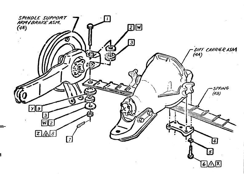

The rubber mounts (#3) on the diagram

From what I have experienced, like you said, it's a pretty straight forward/simple operation. One additional piece of advice is to place a clamp or something similar (large vice grips) on the spring before jacking it up. This will help prevent the jack from slipping off the spring as it (spring) is obviously at an angle (sometimes significant) while jacking and releasing.

Clamp a board to the spring (steel spring only) to keep the jack from slipping up
