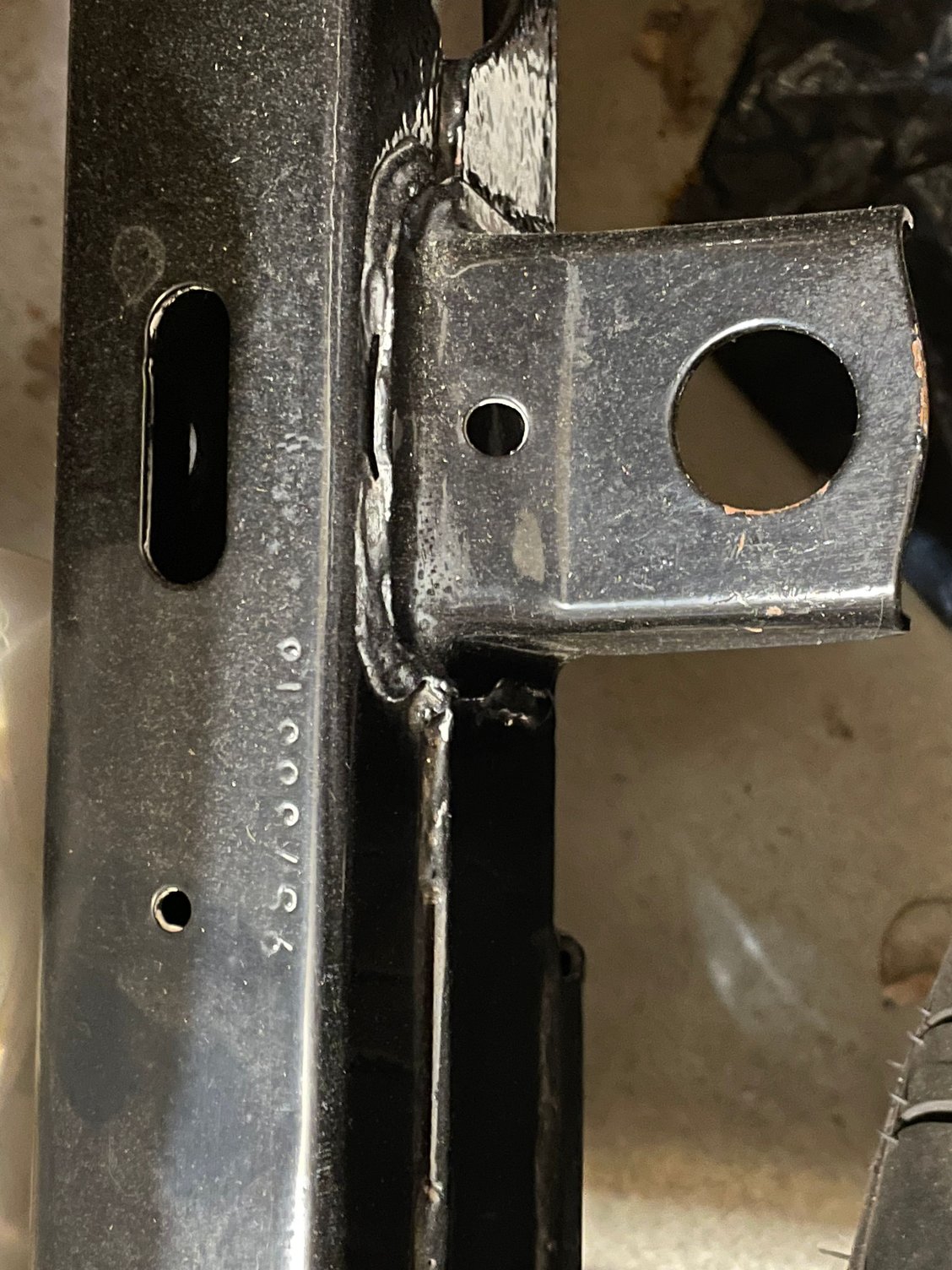

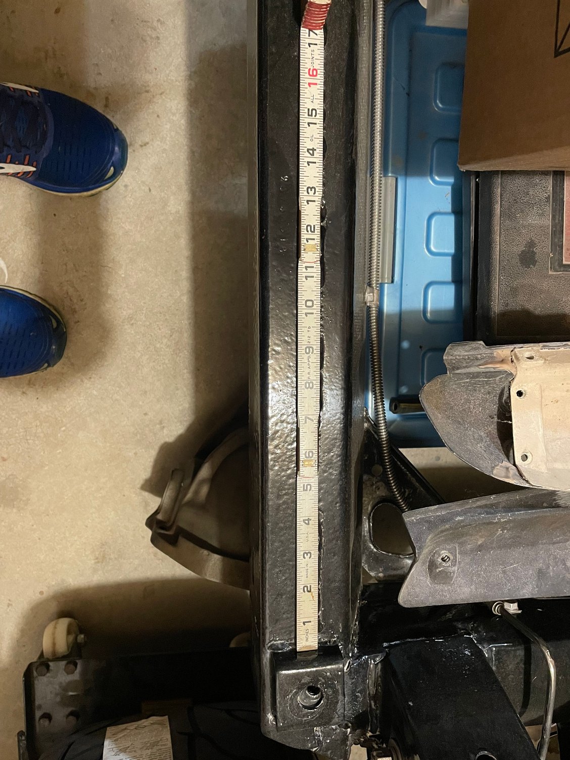

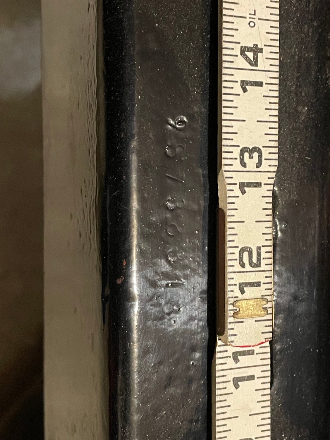

This is of my 69. There are two locations for the stampings, one on the left main rail, about a foot forward of the #3 mount and another on the aft frame section, near the #4. Note that these are partial VIN numbers.
On left main frame rail, forward of #3 body mount
Closeup of main frame
Secondary location, also left side near #4 mount
