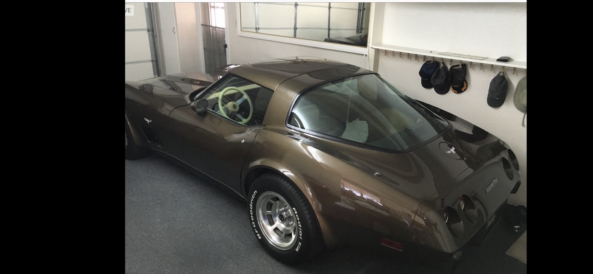

have had since new- never been missed with- one headlight opened yesterday- with fingers raised other- then they closed- now nothing- even over ride switch does nothing - any help appreciated
