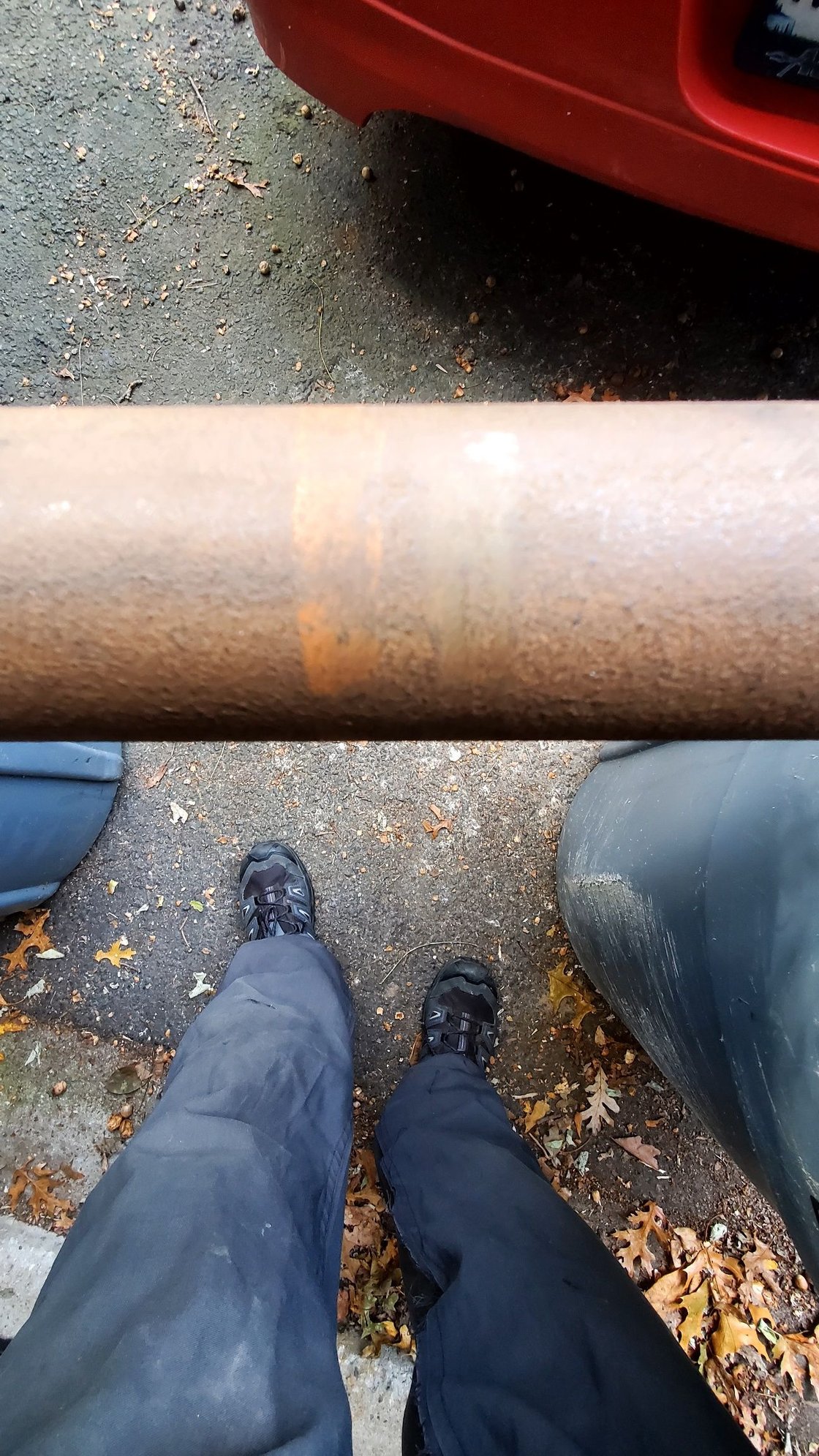

I had my drive shaft out to get the tranny out. I noticed what appeared to be an orange and green-ish band.
Is that factor or the work of a previous owner/shop
Old Oct 26, 2023 | 02:39 PM
GTR1999's Avatar
GTR1999
Joined: Aug 1999
Posts: 15,205
Likes: 4,034
From: Connecticut, USA
Factory
Old Oct 26, 2023 | 03:04 PM
Corvette-ZL1's Avatar
Corvette-ZL1
Joined: Mar 2022
Posts: 1,159
Likes: 492
Originally Posted by GTR1999
Factory
Agreed. From what I understand, it guided the installer on the assembly line to put the driveshaft in the correct way, else it would be unbalanced and cause excessive vibration.
Old Oct 26, 2023 | 08:07 PM
Rowdy Rat's Avatar
Rowdy Rat
Veteran: Marine Corps
Joined: Dec 1999
Posts: 3,612
Likes: 843
From: PA
I’m going to guess that you have a 1968 or perhaps a very early 1969. Driveshafts of that era use the various color paint rings to identify the driveshaft (much like the C2 Corvettes).
By late 1969, the driveshafts used a stencil to identify the driveshaft and a paint mark (not ring) to indicate the direction of installation.
Regards,
Stan Falenski

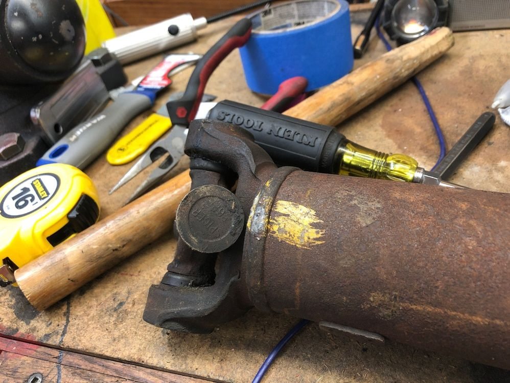

Old Oct 28, 2023 | 11:24 AM
interpon's Avatar
interpon
Joined: Jun 2019
Posts: 7,680
Likes: 2,480
From: Indiana

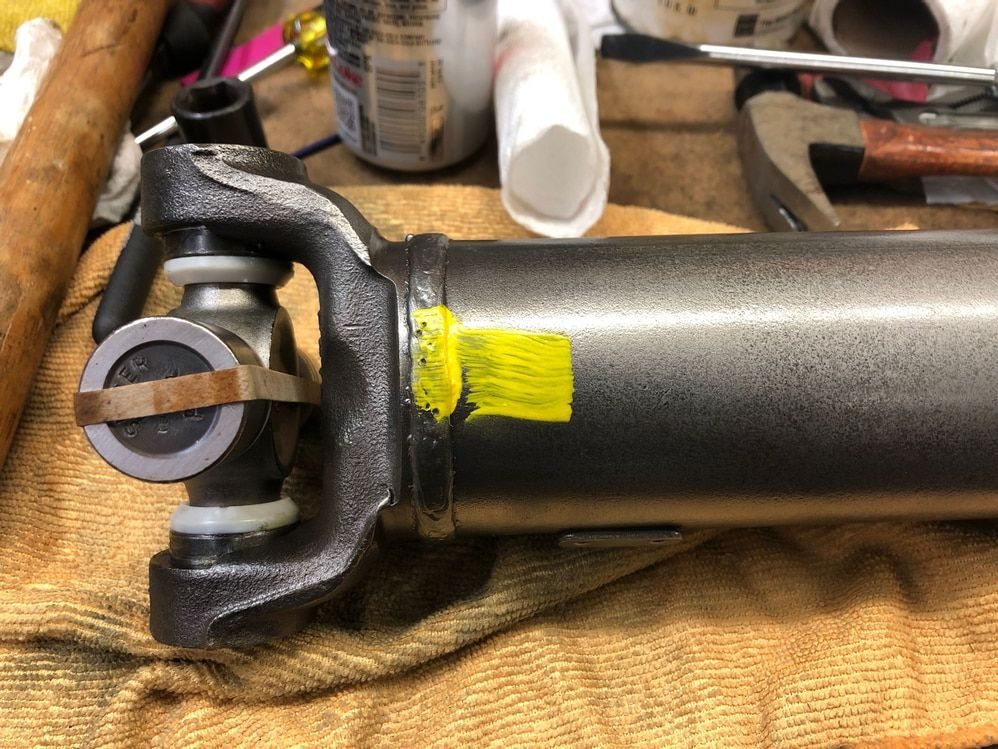

On my 79 some pics tell me tranny weight side..but for the money i would have it balanced with yoke..
i think it would be cool if you repainted and or labels
https://www.corvetteforum.com/forums...-please-2.html
labels..pics show the only yellow markings i had in 79..i think they were differential side panted and my weights were transmission side AND a rectangle weight ihad on differential side
https://www.corvetteforum.com/forums...abel-talk.html

Old Oct 29, 2023 | 07:57 AM
Rowdy Rat's Avatar
Rowdy Rat
Joined: Dec 1999
Posts: 3,612
Likes: 843
From: PA
I can’t speak for the later C3s (like the 1979 shown), but I can tell you that the later 1969 through 1972 used a similar paint mark on the end of the driveshaft to identify the differential end. This paint mark was to be matched to a corresponding paint mark on the differential pinion yoke. The balancing weights are all rectangular in shape and are spot welded to the driveshaft tube. I’ve never noted the orientation of the weights, but on the 1970 that I am working on, it is on the differential end. As previously mentioned, there is also a stencil of the part number of the driveshaft assembly painted on the driveshaft tube. This assembly included the driveshaft, installed universal joints, and probably the transmission yoke; it was never offered as a service part. As mentioned by another poster, this assembled configuration is how you should balance a driveshaft.
Regards,
Stan Falenski
