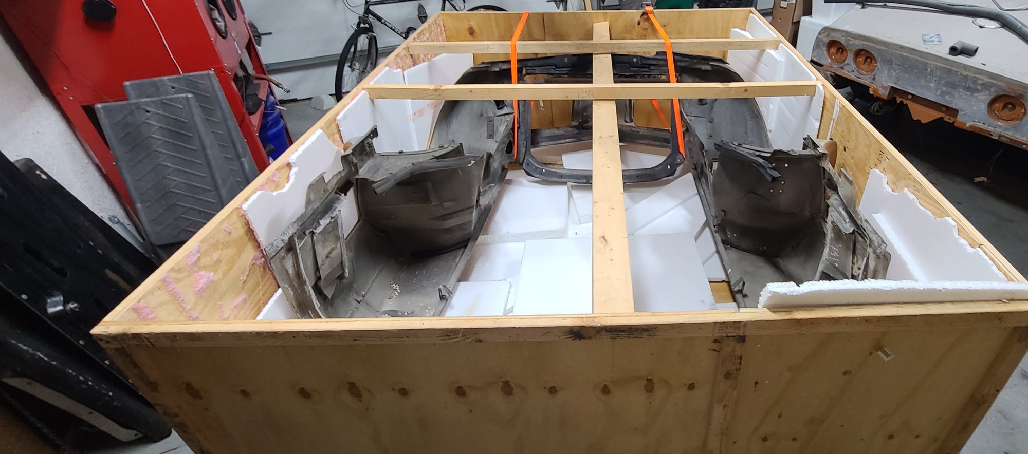

I purchased an entire front clip from a '72 and had it shipped from California to Florida. I purchased it from SoCal vettes in California.
This is it, upside-down in the crate

Impressive! Looks complete. Looks like it includes the radiator frame also. The shipping container looks bullet proof and looks expensive also.

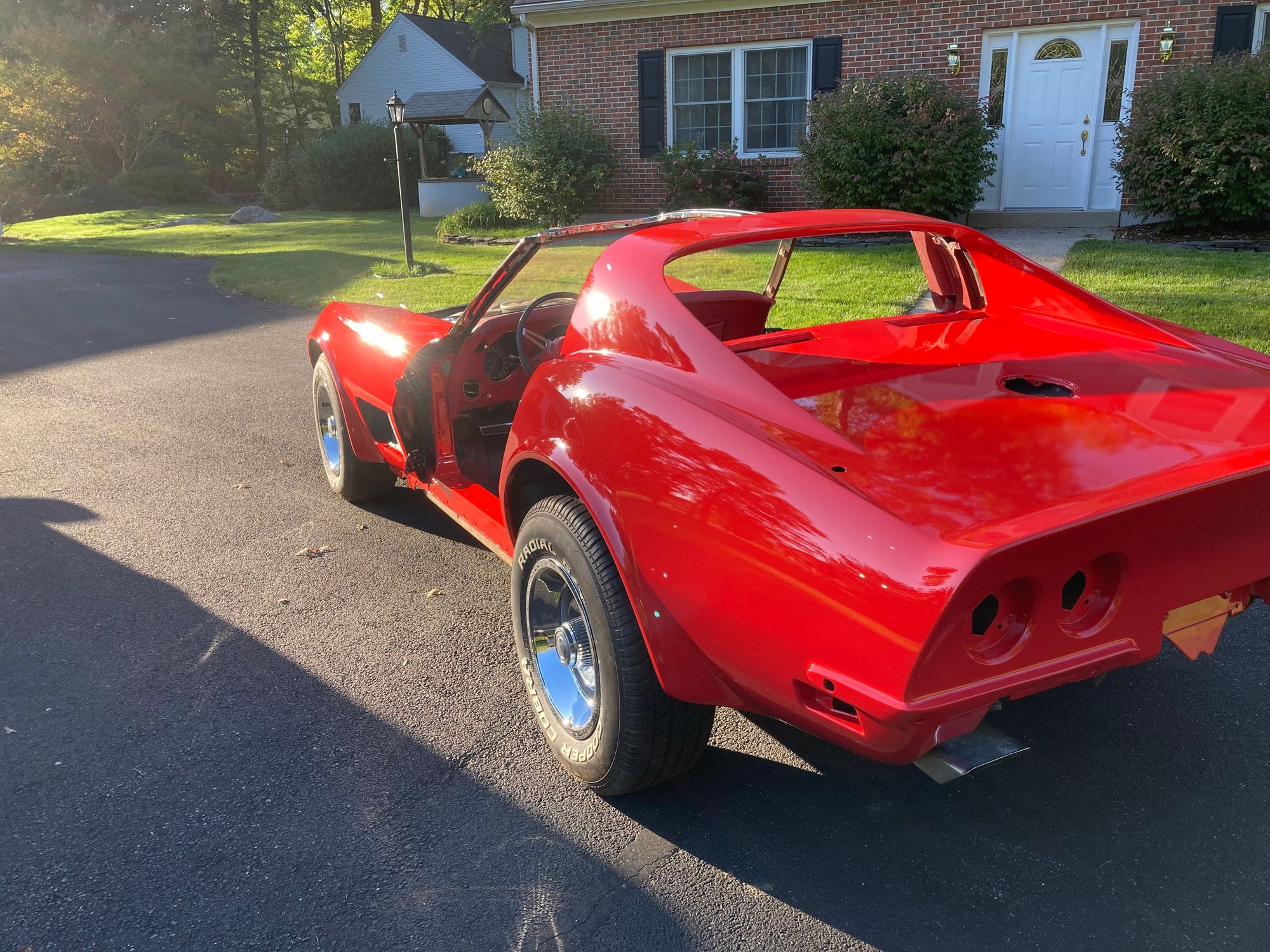

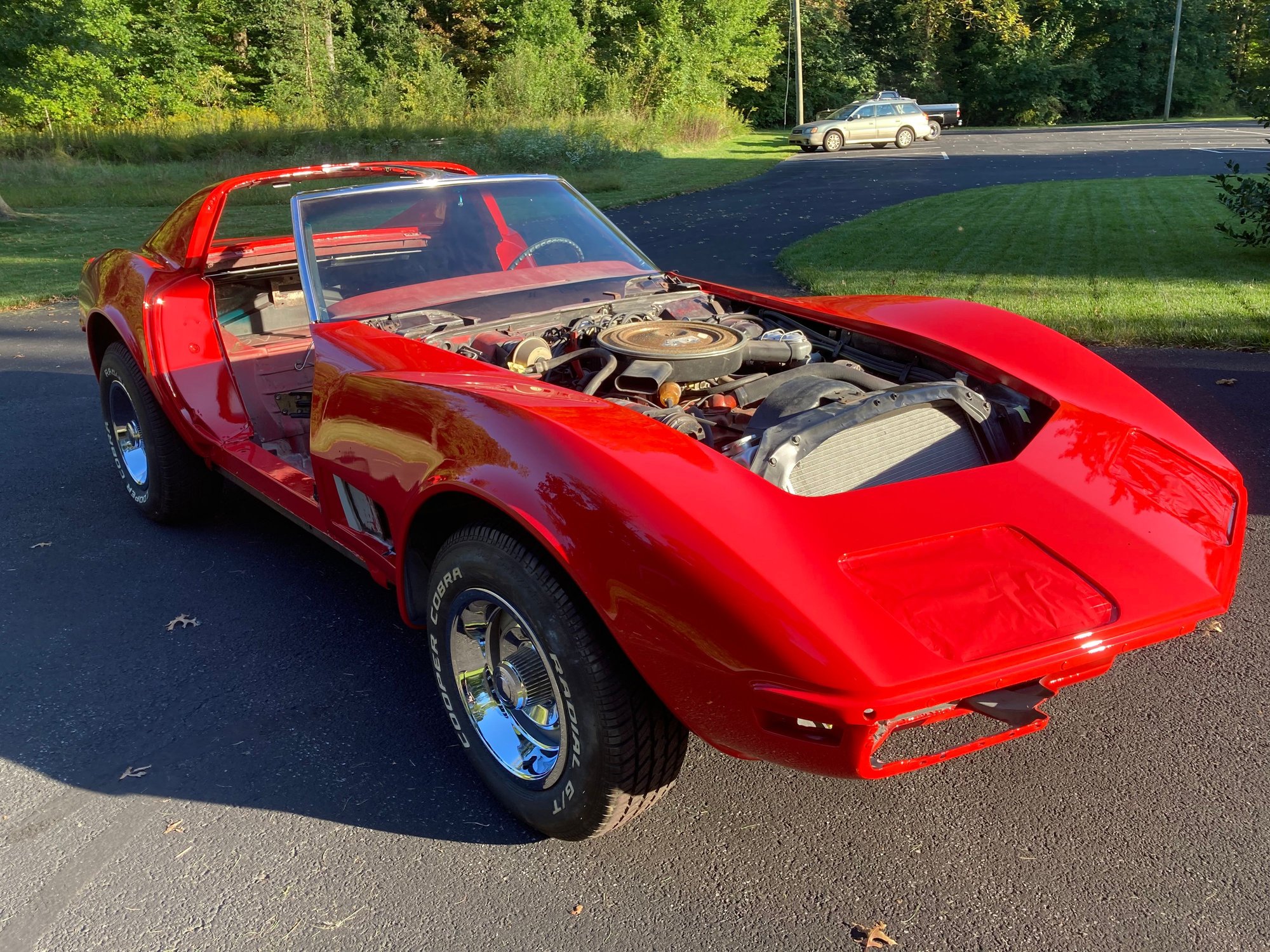

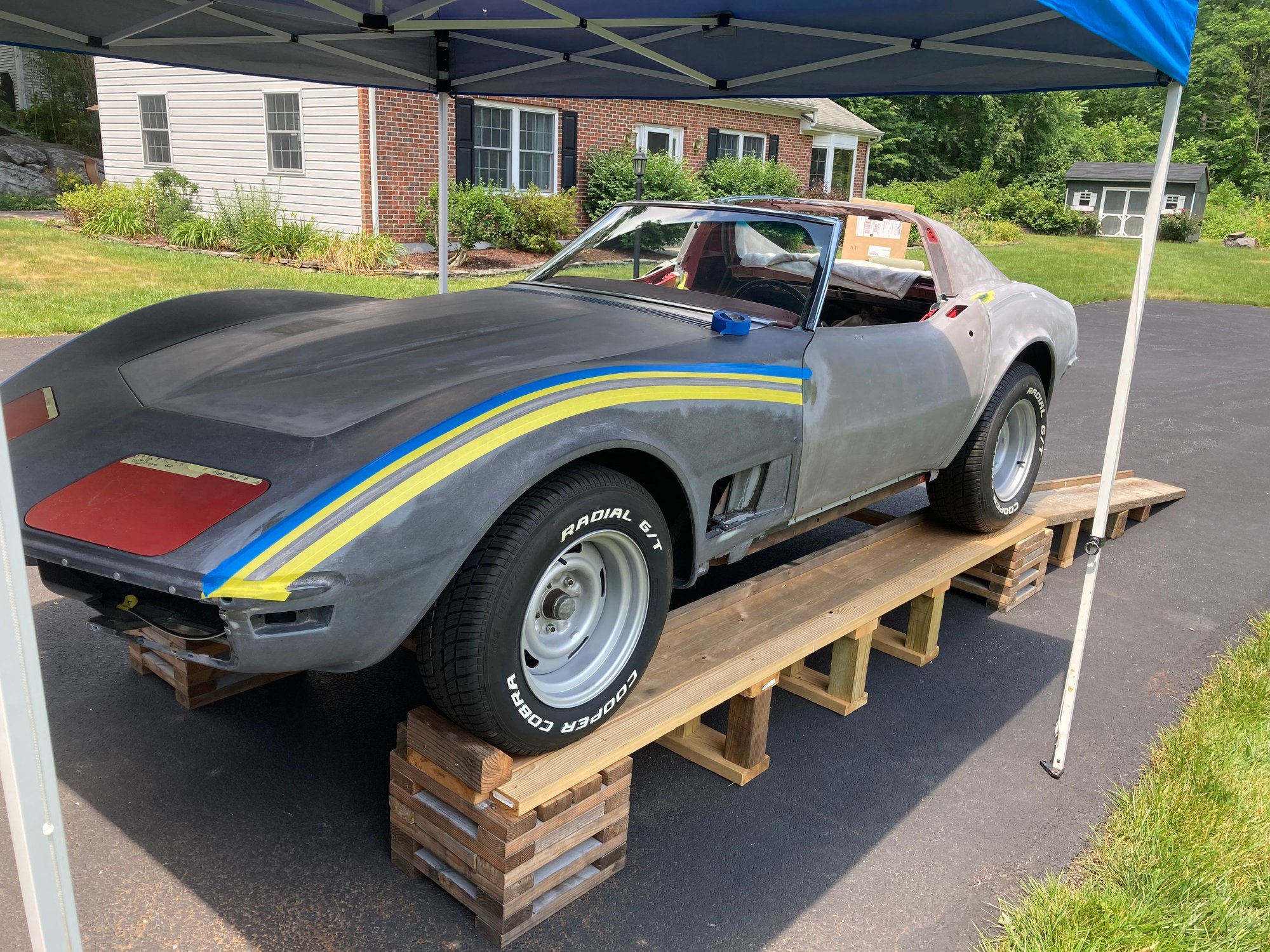

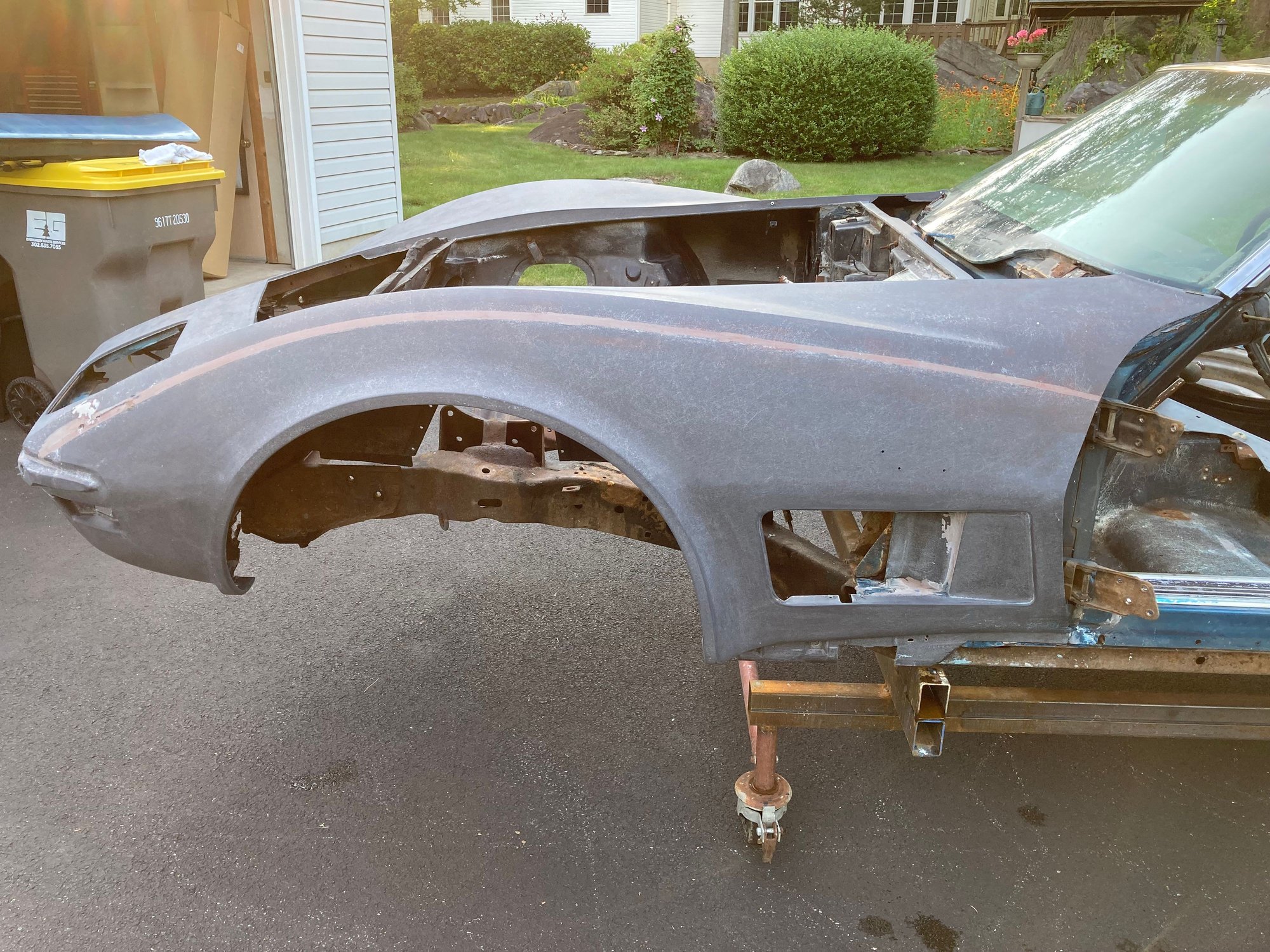

First let me tell you I'm no expert, but I recently finished the very thing you are going to attempt and if you are willing, I can tell you what I did, what it took, and what I used. It took a long time to do this and unlike many others, I did not use one screw to hold things into place. I also did not use VPA to bond things. I used it as my filler. I'll stop right there, so if you want more info, just let me know. Many other members have helped me get this far so I thought I might be able to pass along the things I learned.
Good Luck,
Mark

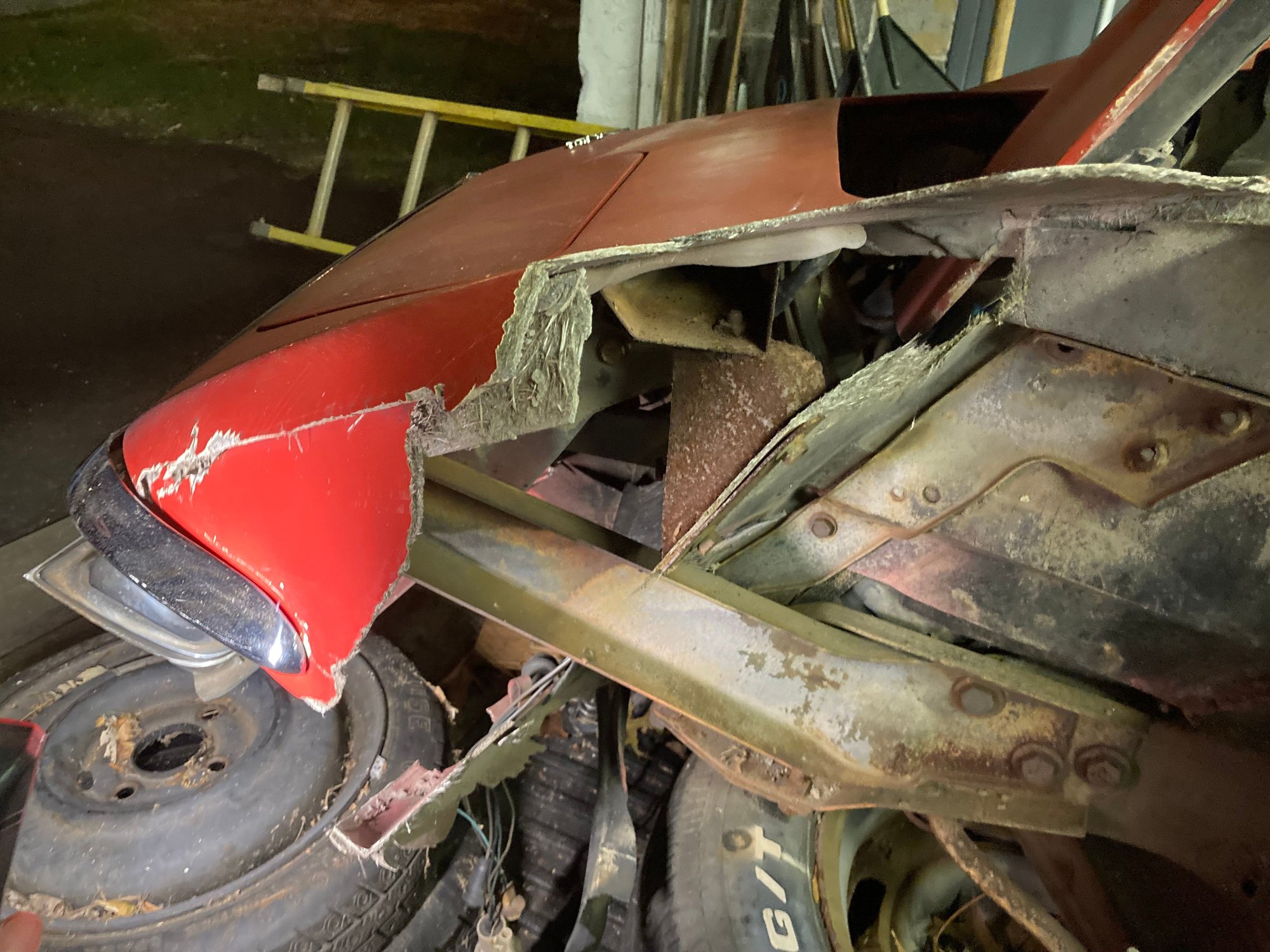

Here is a photo of what I started with.
The previous owner swerved to miss a truck, hit their bumper, snapped a ball joint, and drove the tire into the driver's side door.
Here is the front clip after having the paint stripped and before I removed it from the donor car.
Here it is after I finally managed to bond the new clip into place.
Just another shot of the replacement clip after bonding.
Grinding out the old fender/hood surround bonding seams.
Spotting in some epoxy after blocking out the Feather Fill G2
This is where I am now.
Needs to be cut and buffed, but so far so good.
Good Luck,
Mark
Awesome work, just beautiful. Spot on. thanks for sharing!
Can wait to see the finished product!
Good Luck,
Mark
Wow, that looks fantastic. I'm always trying to learn as much as possible from those who've already done this. Did you also do the painting?

Hi Tewski,
I pretty much did the whole thing from start to finish. Lot's of lessons learned with this one. I've done two other cars, but they were metal. One was an 87 Squarebody Chevy truck and the other one was a 67 Camaro Convertible. Working with fiberglass certainly had a steep learning curve. I relied heavily on the advice I found on this forum to get this far, but I could not really find too much information about replacing an entire clip. Probably because you must be out of your mind to do this. No offense meant...I knew what I was getting into. My wife says I have a disease when it comes to these things and I think she is correct, but I love a challenge. That's why I documented the process and materials I used.
If anybody wants to use it to help plan their repairs I will gladly send it to them. They can see what a relative "Newbie" did and adapt it to their needs.
You mention using VPA to bond the clip into place. The VPA 870 I used, made by Evercoat worked really well when I filled the bonding seams on the surface and I used it everywhere I needed some filler work, but man that stuff kicks fast! If that's the stuff you are planning on using to set the clip, you might want to investigate or mess with some on some scrap pieces first. I'm certainly not a pro so take any advice I offer with a grain of salt. It's just based on my personal experience.
God Bless,
Mark
