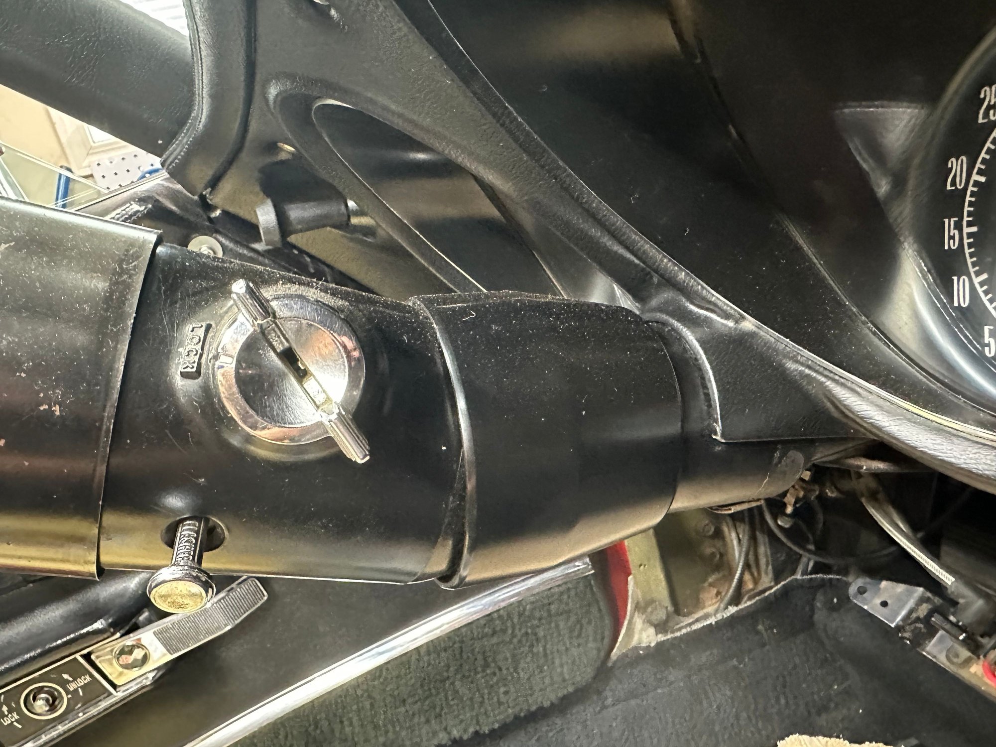

I was doing work behind and under the dash subsequently lowering the steering column. When I out it all back together and tightened the steering column back up, there is a half inch gap between the last column hub and the instrument board. Did I accidentally pull out the column a bit? Is that possible?

Check the 2 bolts securing the column to the interior floor.......they might need tightening up. Also check at the rag joint if anything pulled loose.
