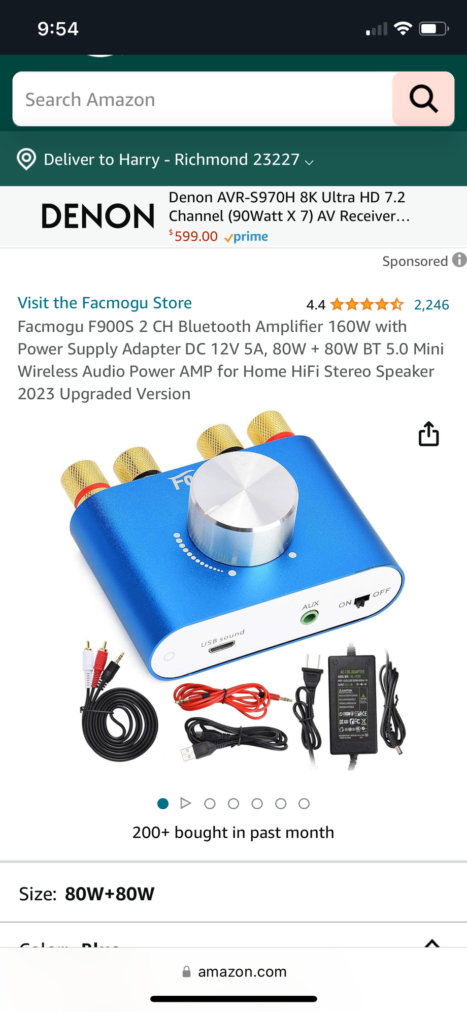

I have asked a similar question on a different thread. The information above was from member “pig farmer”. I myself have been out of the car stereo part of the hobby since about 1980.
”Pig farmers” info educated me enough to move accordingly. I was looking for a simple solution. I am more of a gear-head than the audio performance part of the hobby.
My 68 has a Blaupunkt system circa 1980s 90s. I have removed the amp and now waiting to remove the radio itself after I find a nice enough stock non functioning radio to fill the space.
I am looking to setup a low technology functioning sound system
based on the idea of a simple Blue tooth speaker that I use with my phone in the garage.
I found this compact amp Blue tooth receiver.
There are quite a few options available. I will probably choose the path of least resistance.
There’s a YouTube video review I viewed. It looks like it’s going to be a low effort upgrade that will meet my needs for my quick cruises.
