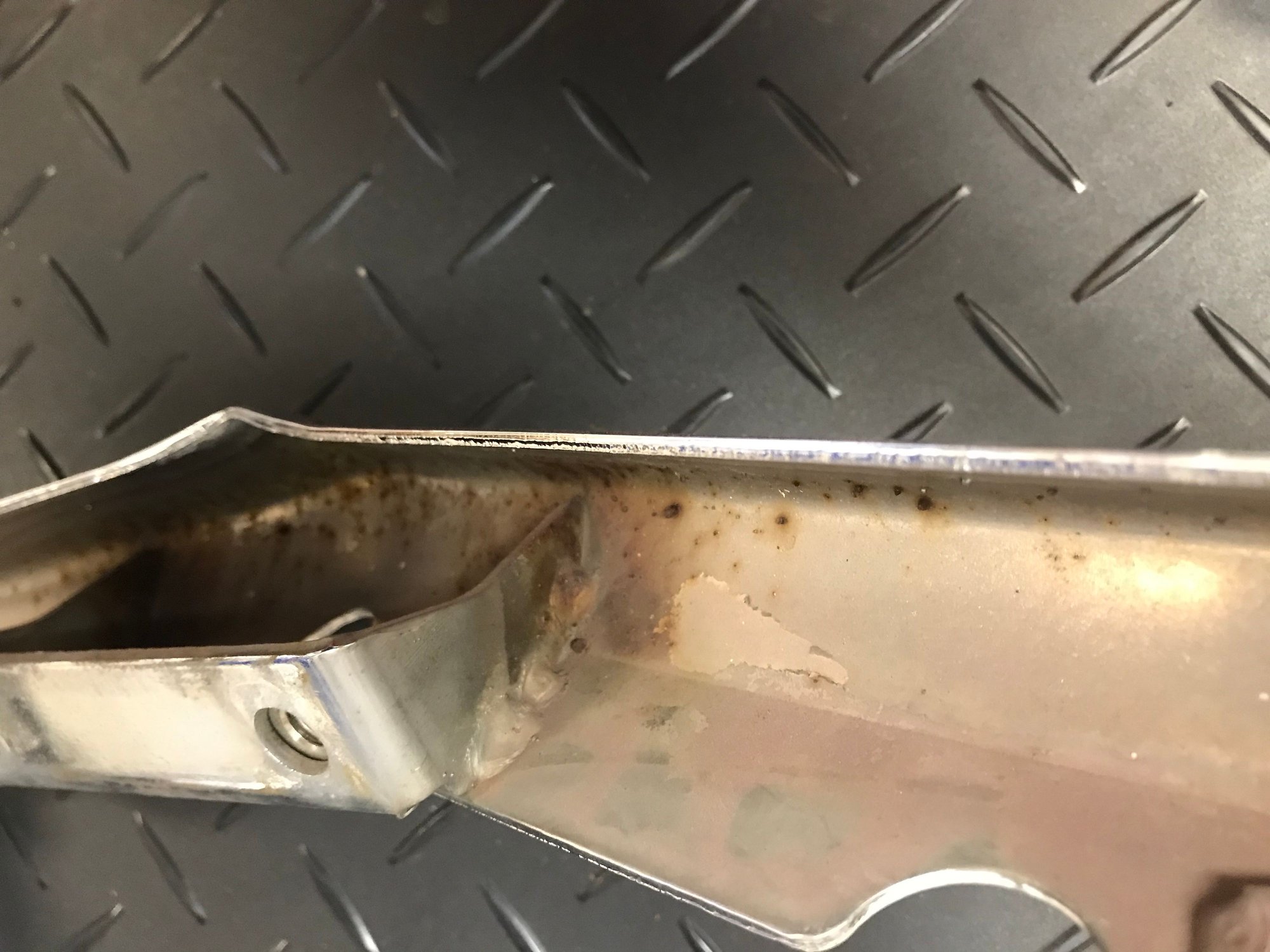

I have lots of pictures of a E'69 original front bumper that I can share with you if that is of any help to you. I know you have a '70 front bumper but I believe they are similar from 69-72. Glad to share pics with you if you shoot me a PM and I'll give you my email address. There are several places on the inside where the welds are located and on the upper lip of the front bumper that will show you if what you have is an original or a reproduction. Weight is certainly one hint what you have is original.

original weld for center support

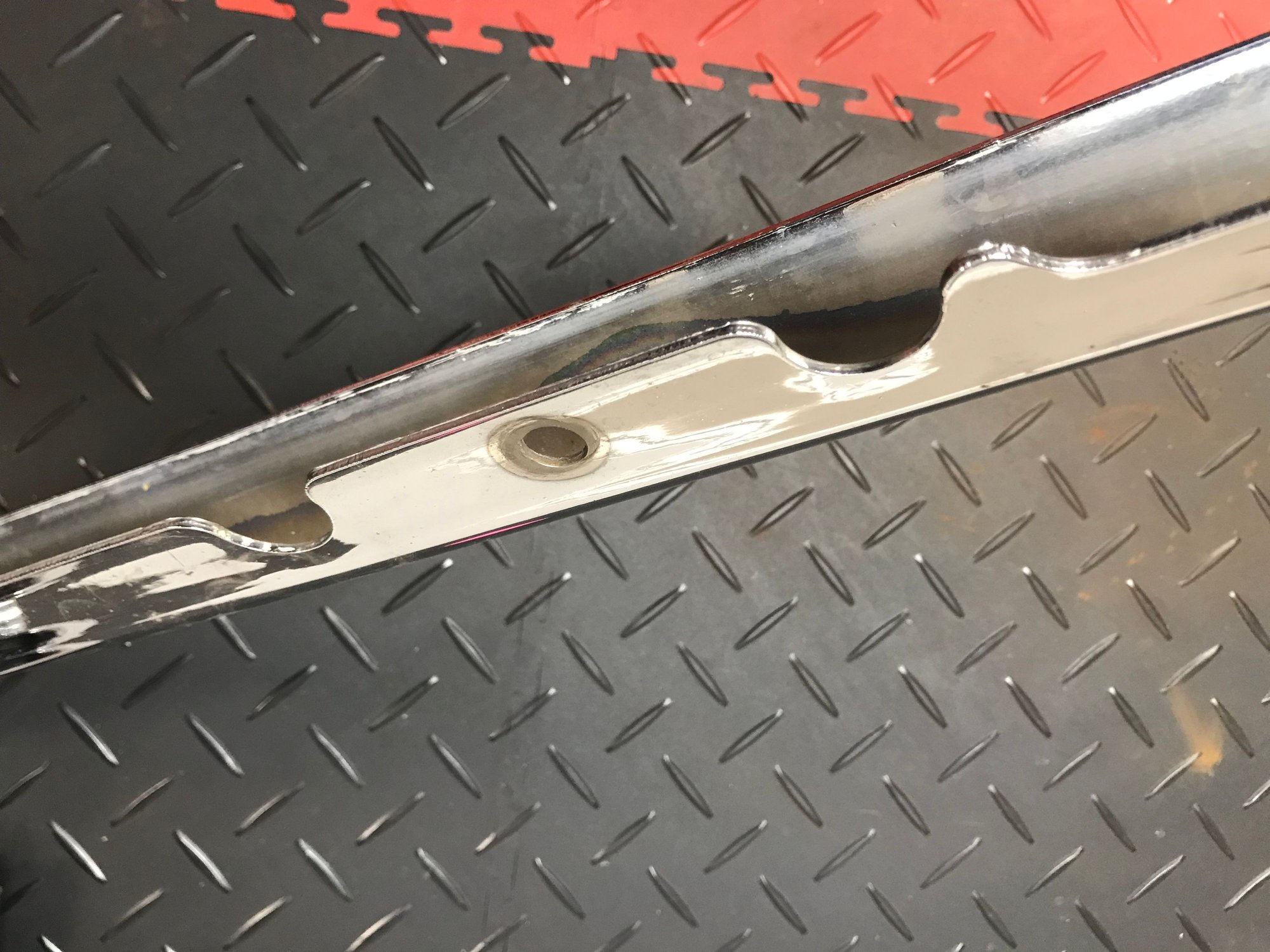

round circle area where the bumper was originally hung for plating

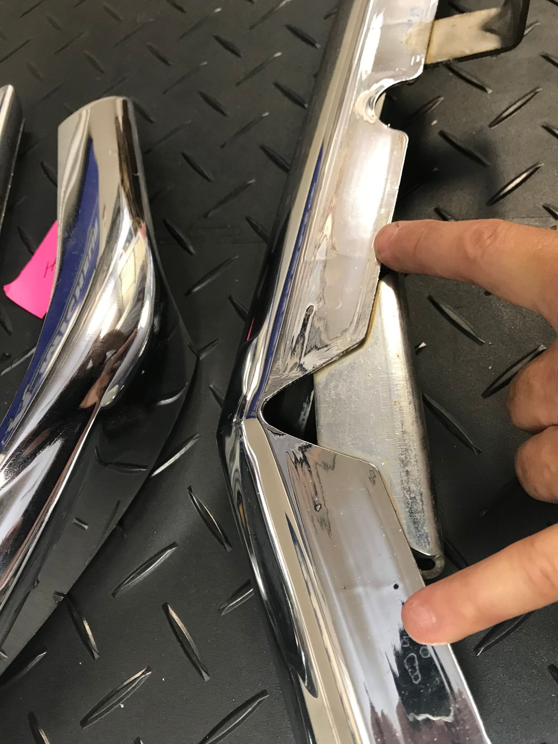

You would probably not see these depressions on a reproduction. I would assume the repros would be polished out and smooth prior to plating.
