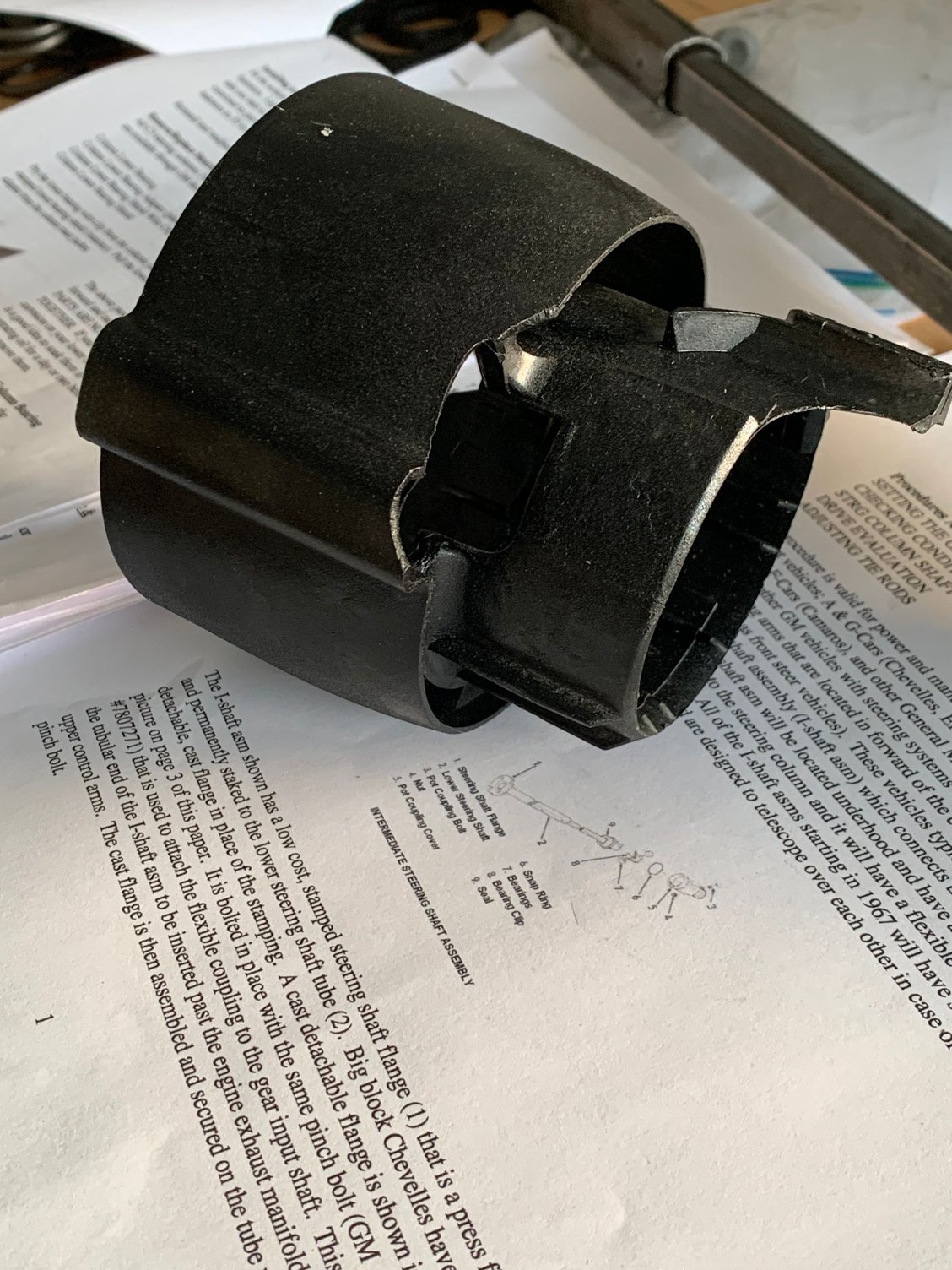

Hello, I need help identifying this part. It’s broken and I need a replacement. Thanks.

if it is broken, where did it come from on the car? Or was it just laying on the floor? Maybe a little more info might help someone help you, as in the year, coupe or vert, big block or small block, etc.. Just trying to help you out.

Looks like the upper collar for the steering column.

I apologize for not giving more information about the part. My grandad gifted me a 77 Corvette (late) and I’m attempting to do a restoration. I’m currently rebuilding the steering column but it seems some parts are missing and broken. I’m in no way a mechanic so I’m YouTubing everything. Any hep would be appreciated.

Thanks for the reply. I’ve printed all of Mr. Shea’s papers that are available. I was working on the steering column today and I accidentally dropped the housing part I posted and it the plastic broke a bit.

Cyanoacrylate cement works very well on most plastic parts. Only use freshly opened, and let it sit for a day before handling the part. If you have all of the pieces. It is even possible to build up missing bits using the gel version, CA accelerator and a Dremel to smooth it.
