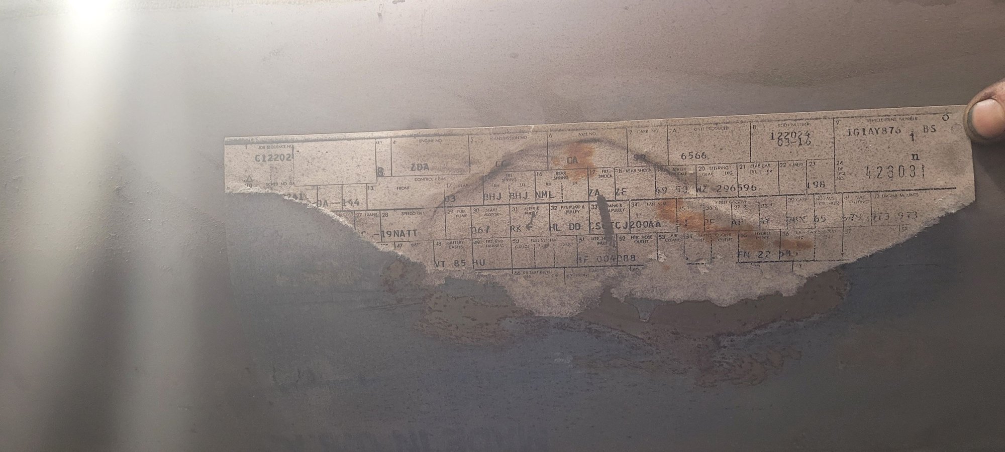

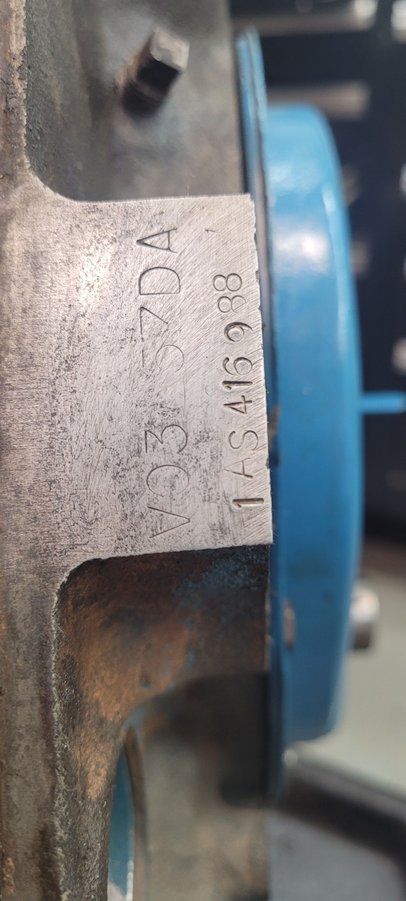

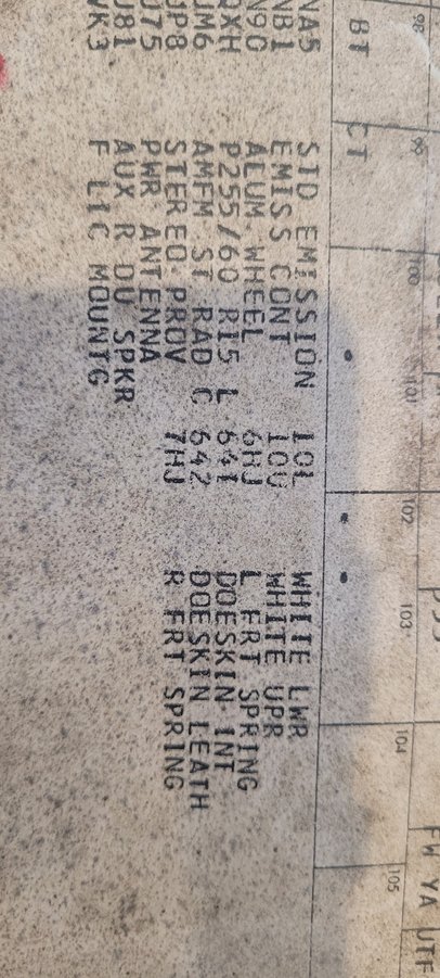

Finally getting back to this. Sorry for the delay. Had reconstructive surgery on a bad foot (clutch foot) so it's been difficult to get around the car. Attached is the other part of the build sheet from the gas tank. I am also adding a picture from the block stamp.

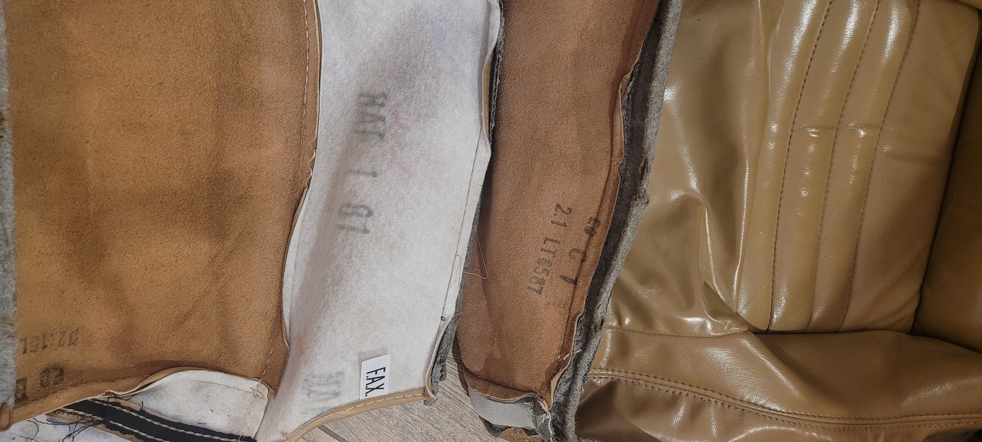

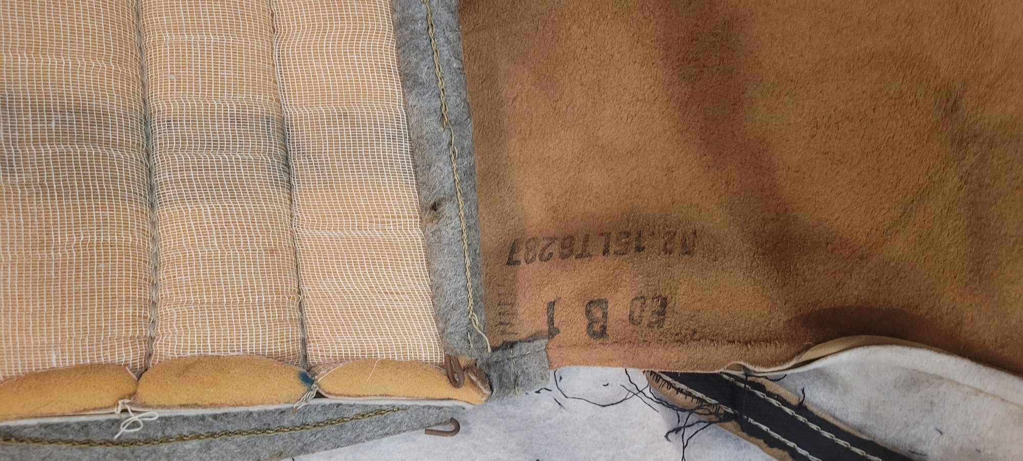

Couple photos of the leather. With some codes.

ZDA is an 81 engine code but VIN is 1980
Engine Codes

The partial VIN on the engine block looks to have been restamped after the originals were sanded off. But does match the windshield VIN. It's really crooked, though, like it had been stamped by hand, one letter at a time. The factory had a "gang stamp", which aligned the numbers. ZDA is not just a 1981 L81 engine, but an 81 4-speed. A very rare bird.
Do you have a rear swaybar BTW? It looks like it says "Gymkhana" on the bottom part of the build sheet.
Whatever. It's a mix of parts. Drive it and enjoy it!

it is so odd that everything points to 81 but the VIN it carries is an 80. I agree the numbers on the block always looked sketchy. When I pulled the car apart I noticed that some of panels were stamped 81. The seat covers also have 81 stamped on the reverse side. It does have rear sway bar and it is the original 4 speed in the car. Seems it could be an 81 that someone an 80 VIN plate on? Now I am curious about the history. That will send me down a rabbit hole trying to figure it out.
I bought the car as a project with the kids to pass time during COVID. First Vette and the price along timing was perfect. We have fun with it.

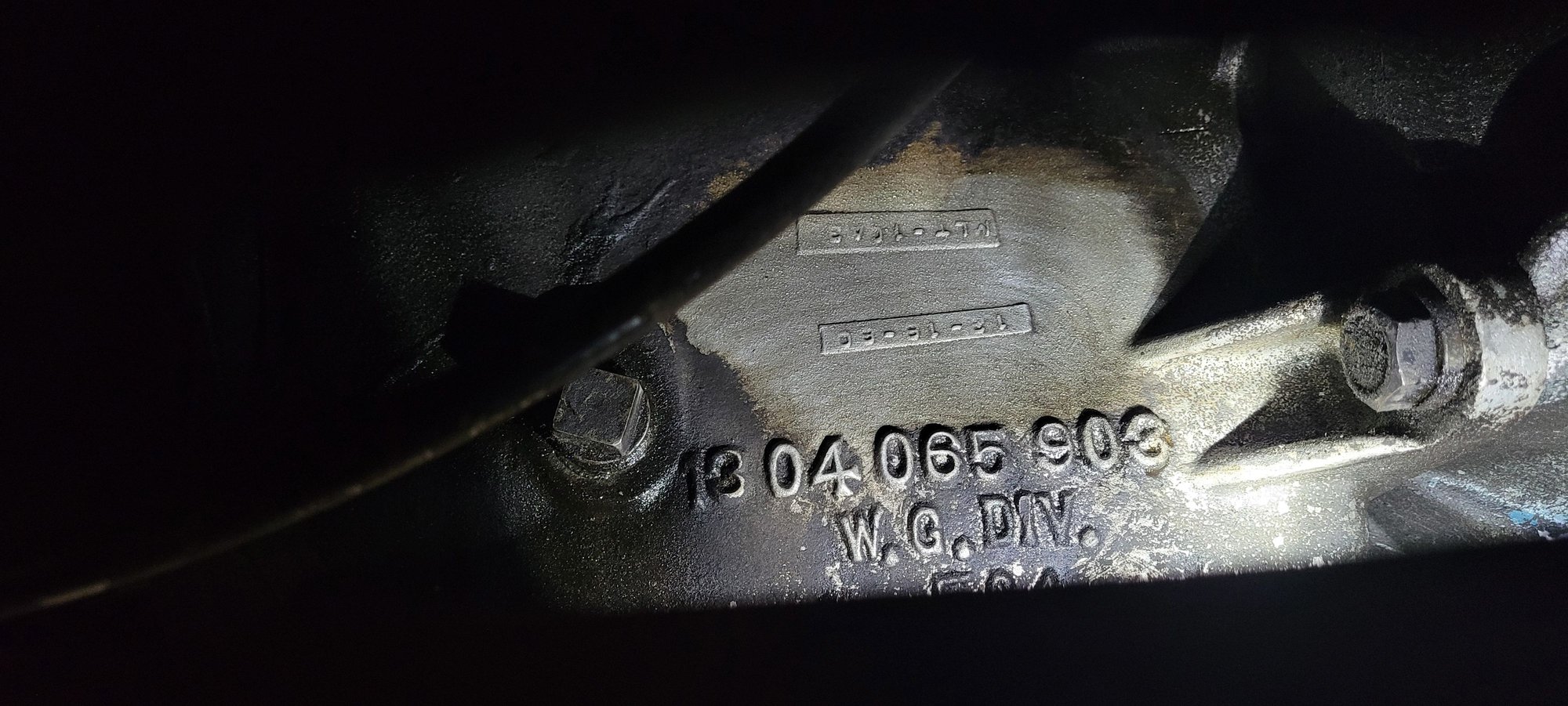

Just to add to the confusion, one more picture.

Adding to the 4 speed photo, partial VIN stamp is ##. This does go along with the VIN on the build sheet but not the windshield VIN.

Seems you may have solved it. An '81 Corvette with a '80 VIN tag, papers and a restamped engine.
If I were in your shoes, I would order a copy of the build sheet for both VIN's. Help verify what you have.
You should run both VIN's thru NICB before spending a lot of money on this car.
