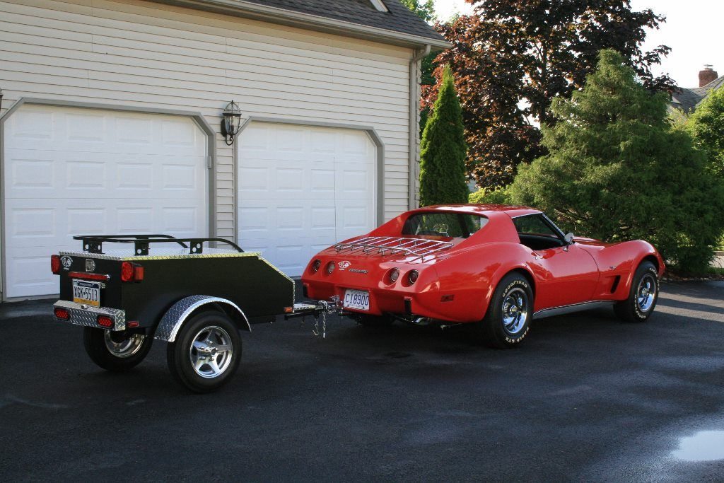

Much easier and safer solution...
AND you can keep the spare tire for the road!
