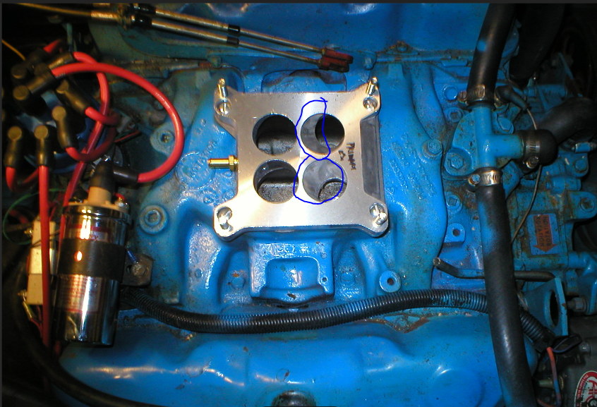

If you used the stock intake and bolted an adapter......that is a large portion of the problem.....the other part is that the ECM is no longer controlling timing since you removed the original carb........so yes, you need a new distributor.
So this is your problem with the carb:
See the two blue circles? They are partially blocking off airflow that is crucially needed for proper fuel metering......you cannot tune this carb out to run correctly on this adapter.
You have three options:
1) Have the original carb refurbished and reinstall......this will assume that the rest of your setup is untouched and functioning......DO NOT buy a refurbished unit......have it done by a Pro Carb builder......unfortunately, our Q-Jet expert here, Lars, does not service these carbs as he has no way to test an electronic one......pretty much no one does. Anyone that refurbishes it will be guessing on their finished product if it functions the way it should.......the carb is a 4ME, it is not like other Q-Jets, it is computer controlled....and only came one year on Corvette, 81-88 on other GM applications....the last carbureted car ever produced (1988 SS Monte Carlo) had this carb......my personally opinion is that they are troublesome and not worth repairing......and spare parts will not be available forever.
2) Convert the car to Pre-1981 specs......this is a very common mod......and relatively simple, all you need is a Pre-1981 Q-Jet for Chevrolet V8....and a Pre-1981 distributor.....the carb would be a nice core found on E-Bay and sent to someone like Lars.....the distributors are available new in the aftermarket. Right now with the carb disconnected.....the engine has zero ignition curve, and this is important.
3) Install a 2101 Edelbrock Performer intake........this option will also require a new distributor......but the carb can freely flow with this intake and function as intended......if you have never done one, this should be performed by a skilled technician.
I recommend option #2...and if you had your car at my shop...this would be the way to go......I would also clean up all the vacuum lines and remove the smog equipment.......

Thank you very much for the quick reply!
Since I have already bought a new carb, I think I will go for option no. 3. I googled up a new intake, the 2101 Edelbrock Performer intake you suggested, and I found it around $200-$250. If I buy this and get a new distributor, will it be all I have to do ?

You will need intake gaskets (Fel Pro 1204) bolts (ARP 12pt or similar)......but yes, once the intake and distributor is installed...timing will need to be set, and idle mixture......from there that is the best it is going to get if there are no underlying issues....the new intake will be non-EGR...that is fine.....toss it.
