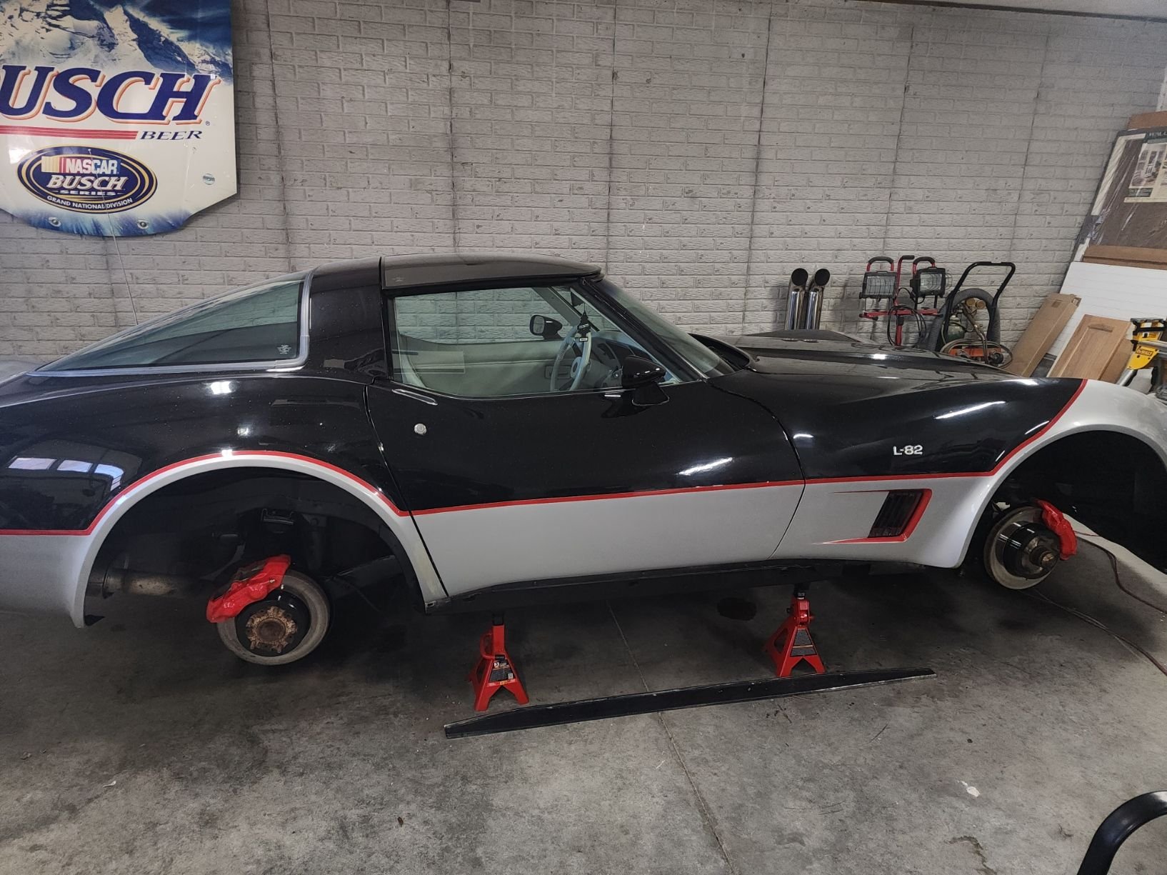

I am starting to get some work done on the ol' girl and am having a blast doing it. I am going to start the header/side pipe install this coming week-end and wanted to get the car cosmetically 'prepped' so it's ready to go.
Before:
After:
All done and ready for the fun stuff:

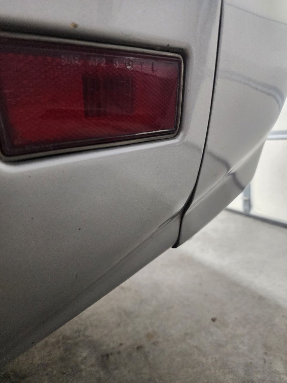

Also, I noticed the rear section is a bit wonky near the bottom on both sides. It fits nicely everywhere else, just the bottom seems off a bit. When looking at photos of other similar C3s, I don't notice this gap:
I admit I haven't crawled underneath to look yet, but is there some sort of bracing that needs adjusted or is possibly missing?

I had the same problem with the hood on my car back in the late 90’s. It turned out I had fist sized holes in the rocker channels at the #2 body mount location. Before you go and invest any more money in the car check your front body mounts (especially the #2 mount location) and top of your windshield frame for rot. Hopefully your rubber mounts are just worn out (collapsed).
