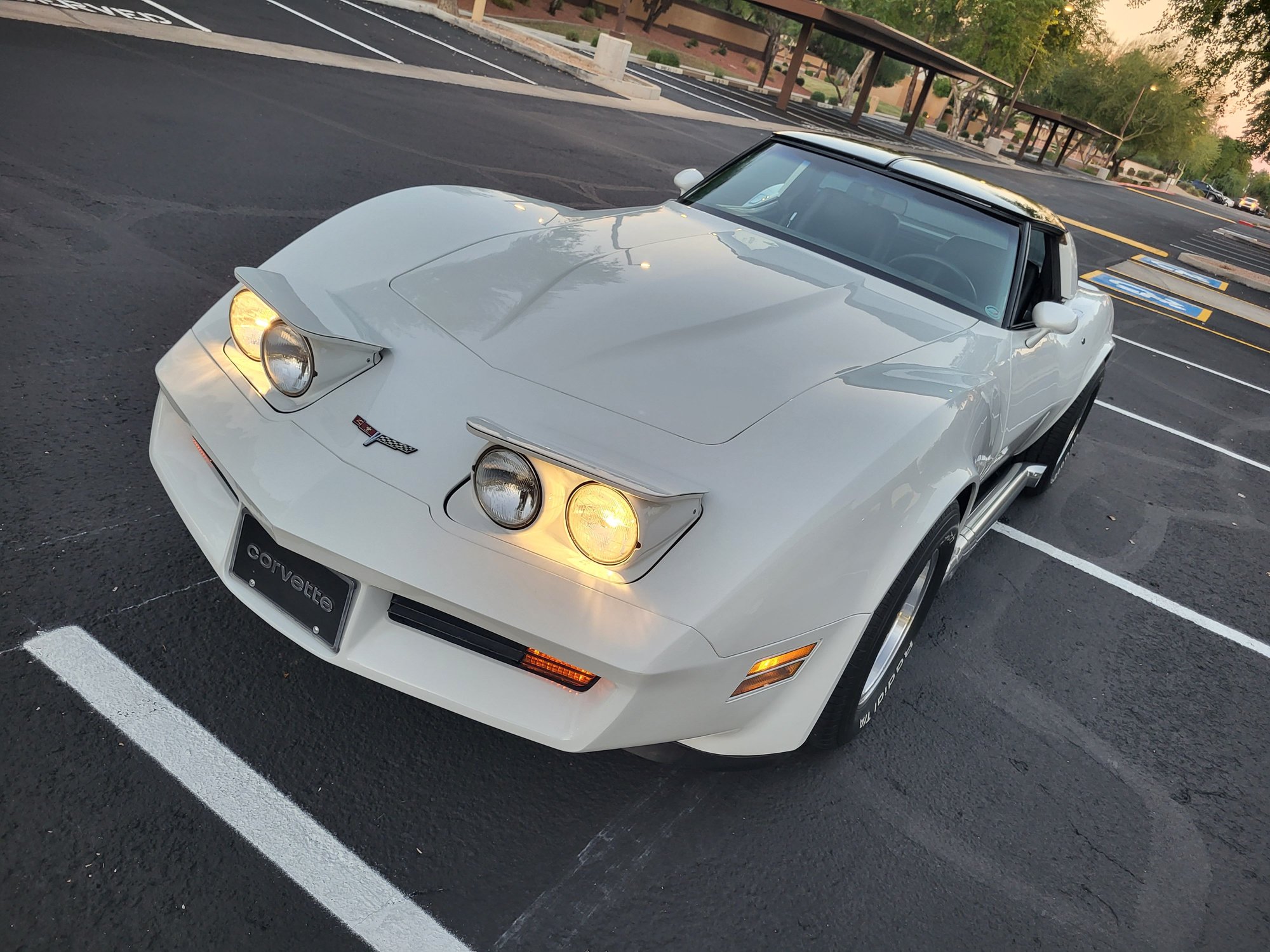

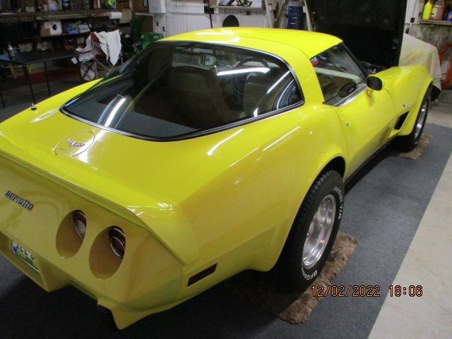

15x8.5 with 3.77" backspace part number 1055861 torq thrust D, no spacers or mods, 255-60s all around on both... one Coopers and one BFGs and no issues with either though I don't track my cars.

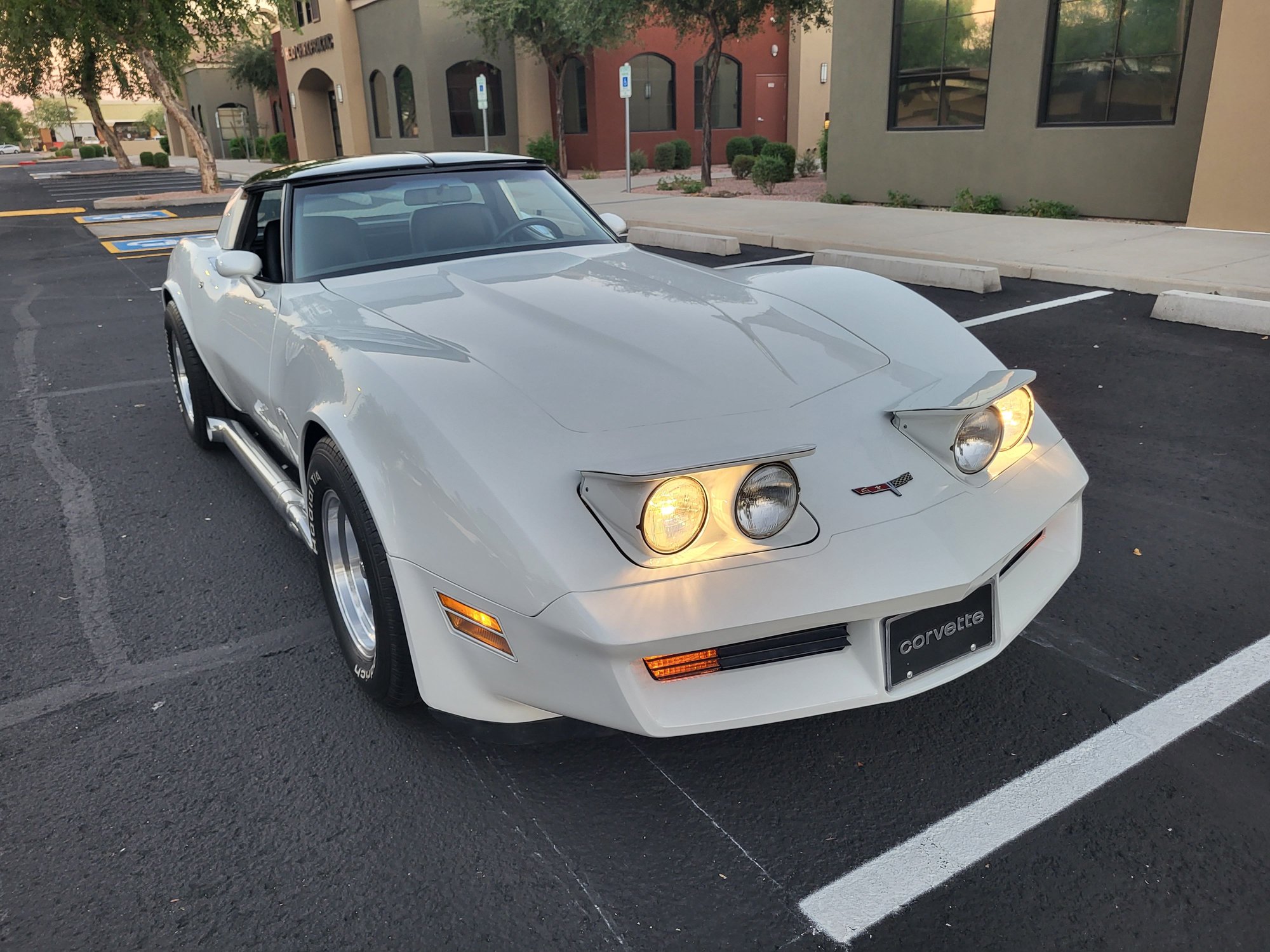

and they do look a bit proud to the outside. Can't exactly roll the fenders on C3. And your saying they don't hit? Looks like a good size bump would test that.
I'm still thinking 4.5 offset.

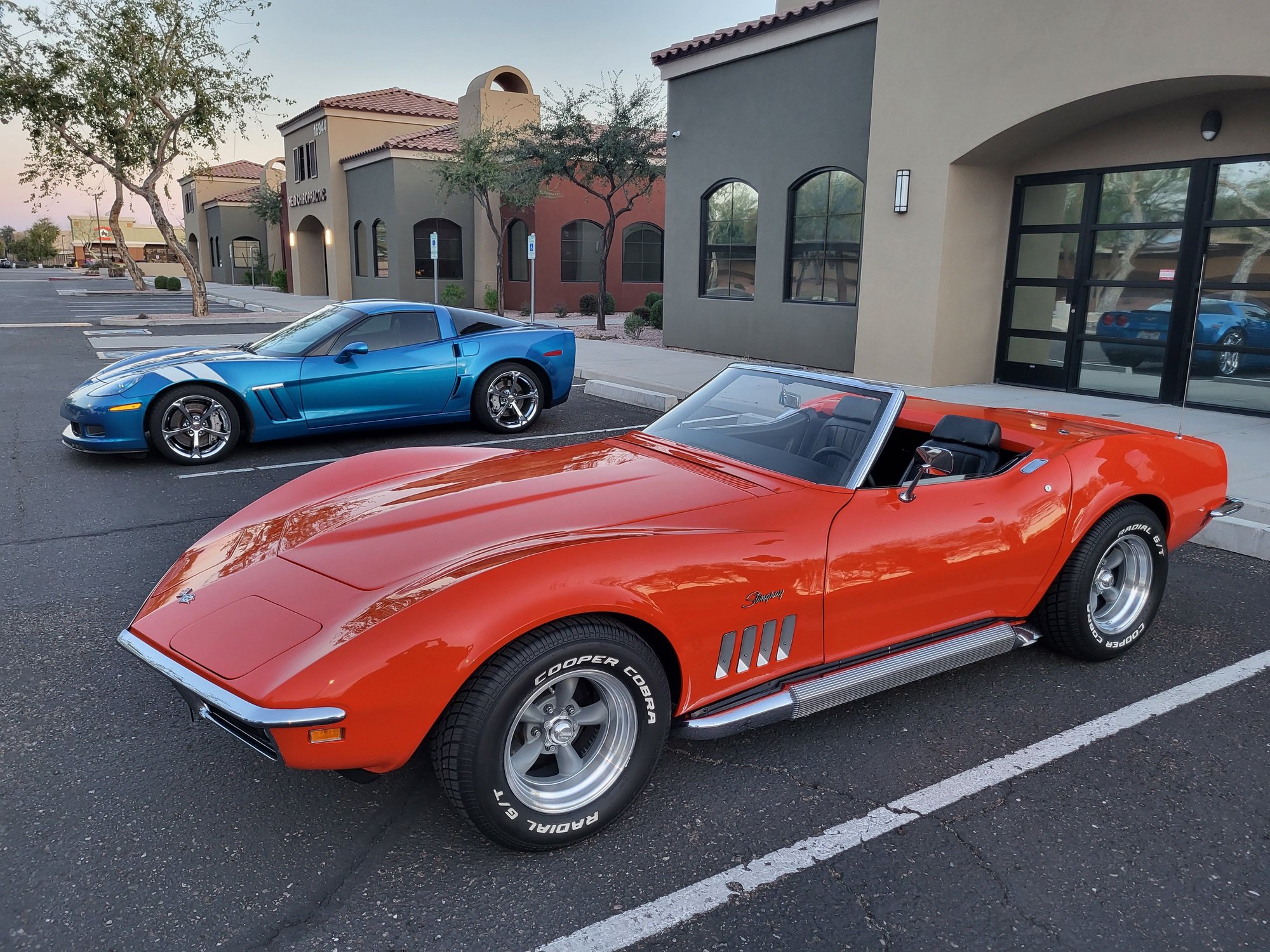

had them on both for some time with no rubbing at all ever, not even at compressed suspension... the 69 was closest at the front of the front wheel and had about 3/8"- 1/2" clearance, a 245/60 is actually the recomended but discount let me try a 255/60 and cleared fine... the 80 not really close at all but again both with 255s... both cars were lowered a bit as well, frankly back in the day when Dunlop had 265/50s I used to run them.
been using these for a while and "Wheels for less" had this wheel package as the C3 corvette package which is where i purchased the first full wheel package, now i just use discount tire. These rims were on a national backorder last year and found my last set at classic industries, i personally cant imagine a 4.5" backspace not rubbing the frame but don't know... never used that backspace.

Perhaps a bit deceiving in those photos, they dont stick out very far

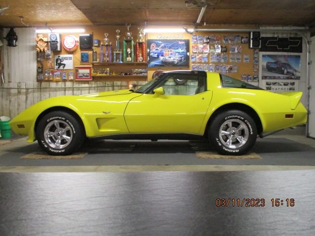

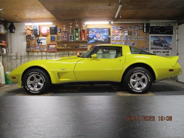

My '79 with 15x8 Ridler wheels, 4-inch backspace, and 255/60/15 Cooper Cobras. Tires even with fender lip. Top picture is with mint, laminated original blue tint glass tops. The second is with the fiberglass tops to save the glass tops.
Very pleased with looks and performance.
