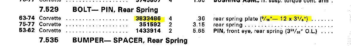

Can someone please verify the thread size of the Differential spring mount bolts.
I want to say they're 9/16-12 But want to make sure before ordering a time-sert kit.

9/16-12 UNC is correct for the 4 center bolts, 63-77 type of thing

Thank you Mooser
