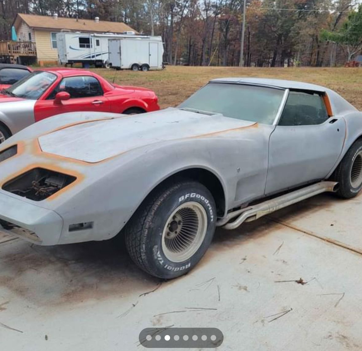

Hey everyone! For a while I've been dreaming about buying a restoring a C3, mainly including paint, general mechanic maintenance, and refinishing interior trim.
I've been window shopping on fb marketplace and I've come across a few listings that sparked interest. I've been wanting to pick up a few tidbits of information as I don't want to make the mistake of buying a complete rust bucket.

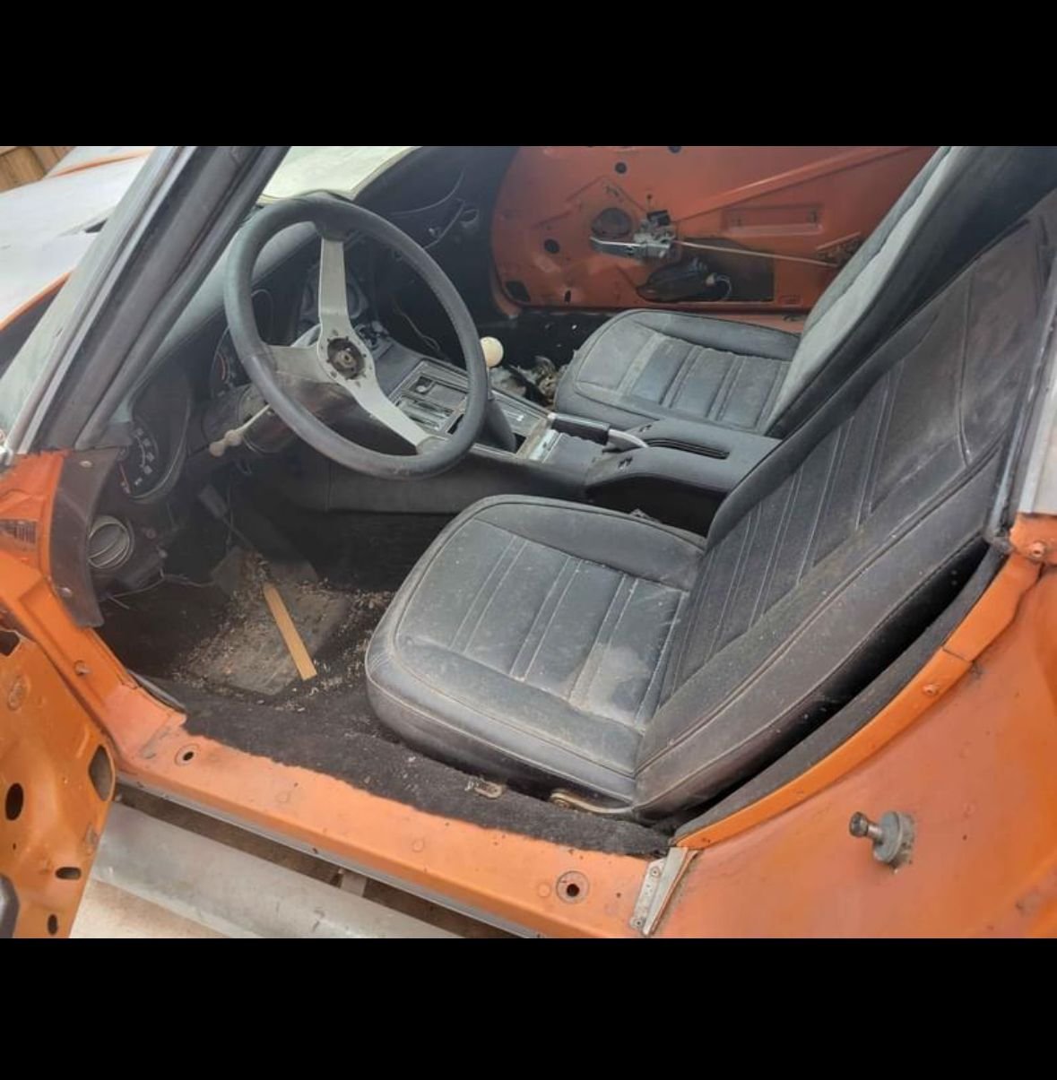

I have a listing that I found interesting, and is a '74 4 speed. Exterior body panels look to be aligned well. He's got the door panels off and only that, the rest of the inside is intact. The paint is still pristine on those doors but it looks to me like there is a layer underneath that could degrade. My question is whether there are any addition spots on those doors that would easily reveal rust.
I've done research an seen good spots to look for rust on the birdcage and the frame, but nothing mentioned doors.
Any help is appreciated!

Welcome to the forum. Typically, doors are not an issue unless they were submerged. Any surface rust is generally inconsequential. Dig deep on the birdcage and frame!

Doors can be replaced, but the birdcage at the hinges can be a problem. Do the doors line up? Behind the kickpanels are the #2 body mounts, which are usually the important tell in that area, but inspect around the hinges, too.

The photo you put up shows nothing of interest. Body mount number 2, behind kick panel. Body mount number 3. Small plate you remove inside forward edge of rear wheel well and look inside. Body mount number 4, often badly rusted. Behind rear wheel, just look up. Windshield frame. Upper corners. Lower corners.
general condition of the frame.

I have seen c3's have a lot of rust at the bottom of the doors from leaky window seals (or stored / abandoned with windows down a little), but the A-pillar mounts and birdcage were solid...
Take all the advice from above...don't be afraid to hit every inch of the frame with a hammer...You will hear the bad spots...

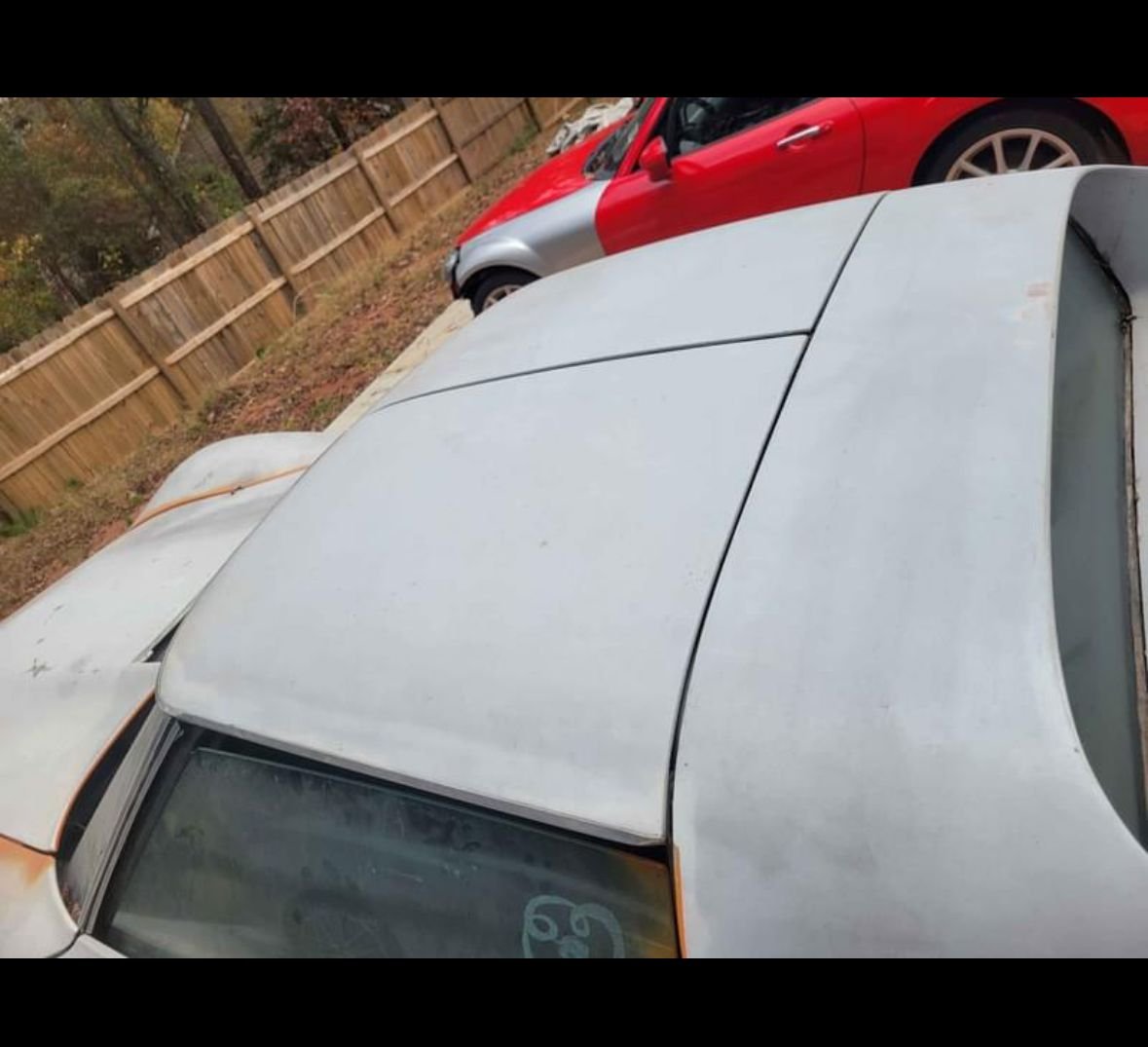

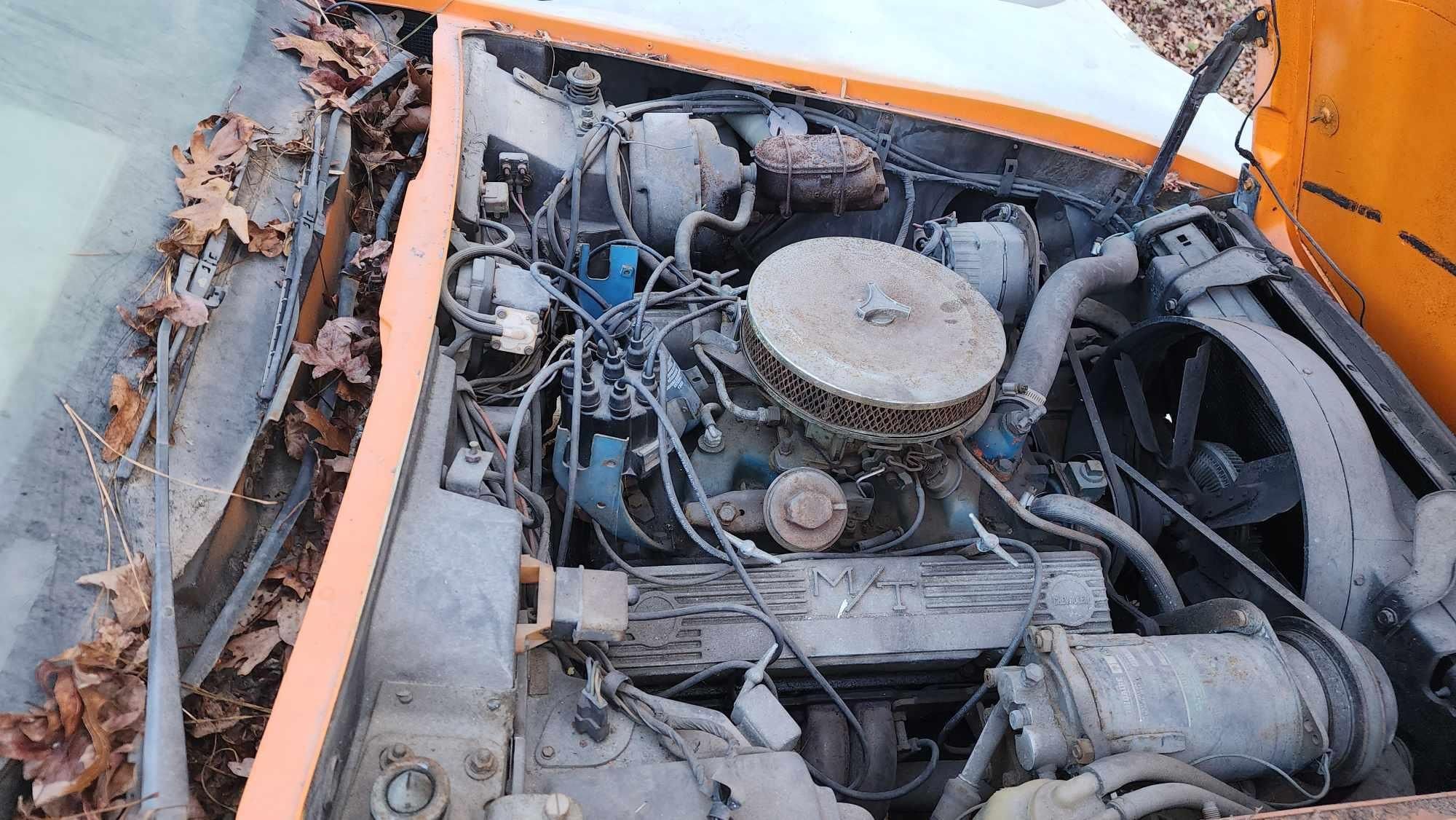

I agree, I’ll get more photos uploaded once I schedule an in person meetup. For now I’ve got some more seller pics. I’m waiting on a photo from the seller of the rust behind the kick panel.
Engine bay looks to be completely untouched, but it is missing headlights and taillights from the pics.
hard to tell of any rust In the windshield bottom area
Weird paint job as well🤔 I can’t quite tell why it was so lazily painted over
Hard T tops? They look well aligned. I’ve heard birdcage degradation will make leaky t tops and wonky doors.
Supposedly has 15,000 original miles
let me know if I should run away from this one

That engine compartment is far from original, but the mods are old, such that the grime and corrosion match.
Hard T-tops? Are there any other kind?

interesting, i think I picked out some things here or there that are aftermarket like the valve covers and possibly the vacuum distributor. I’m not too knowledgeable on the engine bay layouts of these cars.
You think the modifications would be a good thing? As the vacuum lines would maybe possibly have been redone

Depends on what you want. Mods usually mean that the car was driven, so that's good.
If it is like most other C3s that look like that, every rubber component will need to be replaced. Vac, fuel, and brake hoses to start, and likely every suspension bushing.
Ask the seller for a clear photo of the trim tag. Likely Ontario Orange, that someone was repainting. Is that new primer on top, or was it scraped down to primer?

That engine bay looks atrocious! The plug wire routing is a joke at best. The ign. shielding is missing. And on and on it goes. Didn't even bother to sweep away the leaves before taking the photo.
Run Forest Run.

Vacuum lines are the least of your problems, that car needs everything done, everything... Look at the concrete under the car, it's been sitting there for years... Go find a running/driving car to start with... Walk away from this one...
