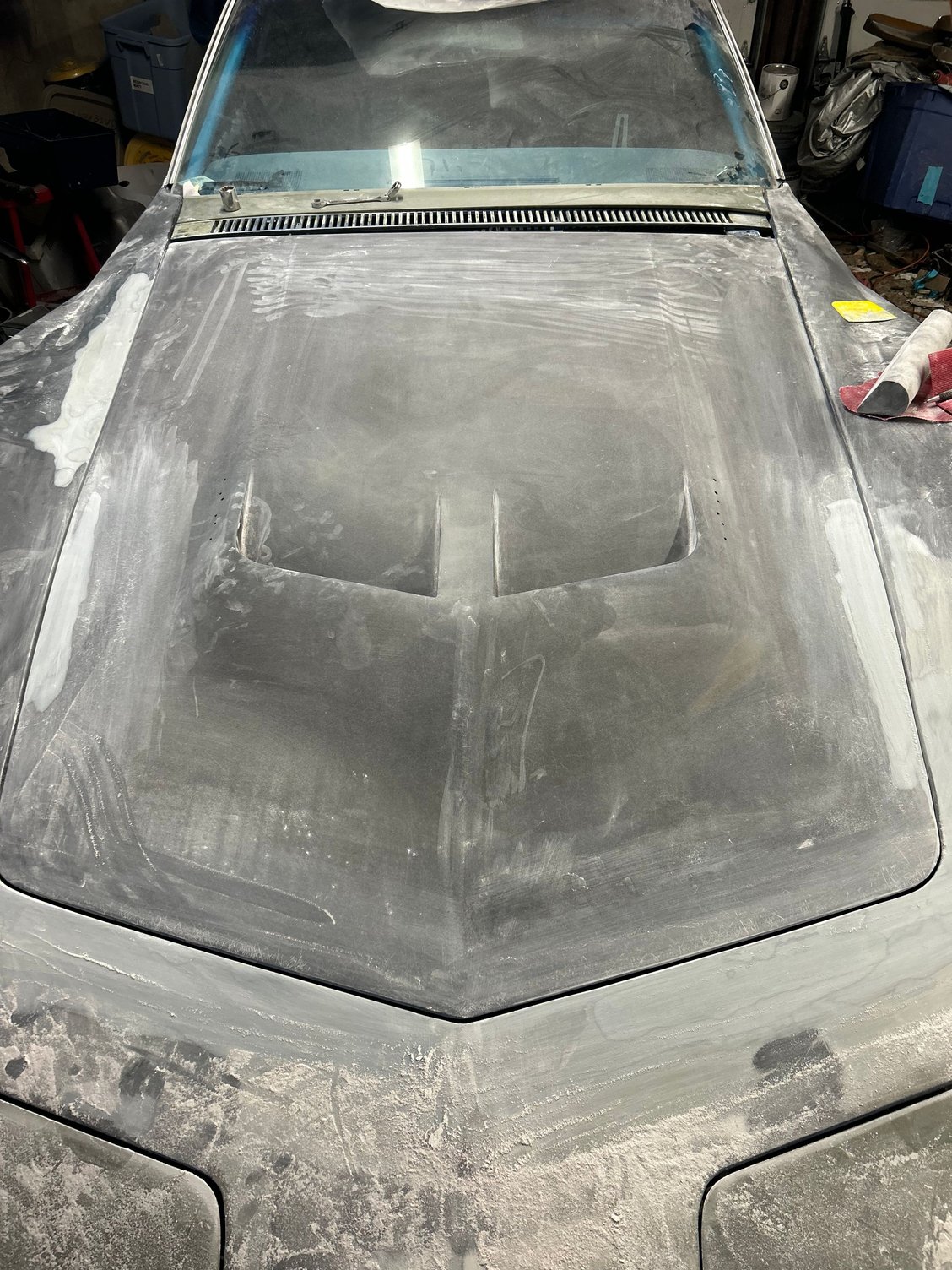

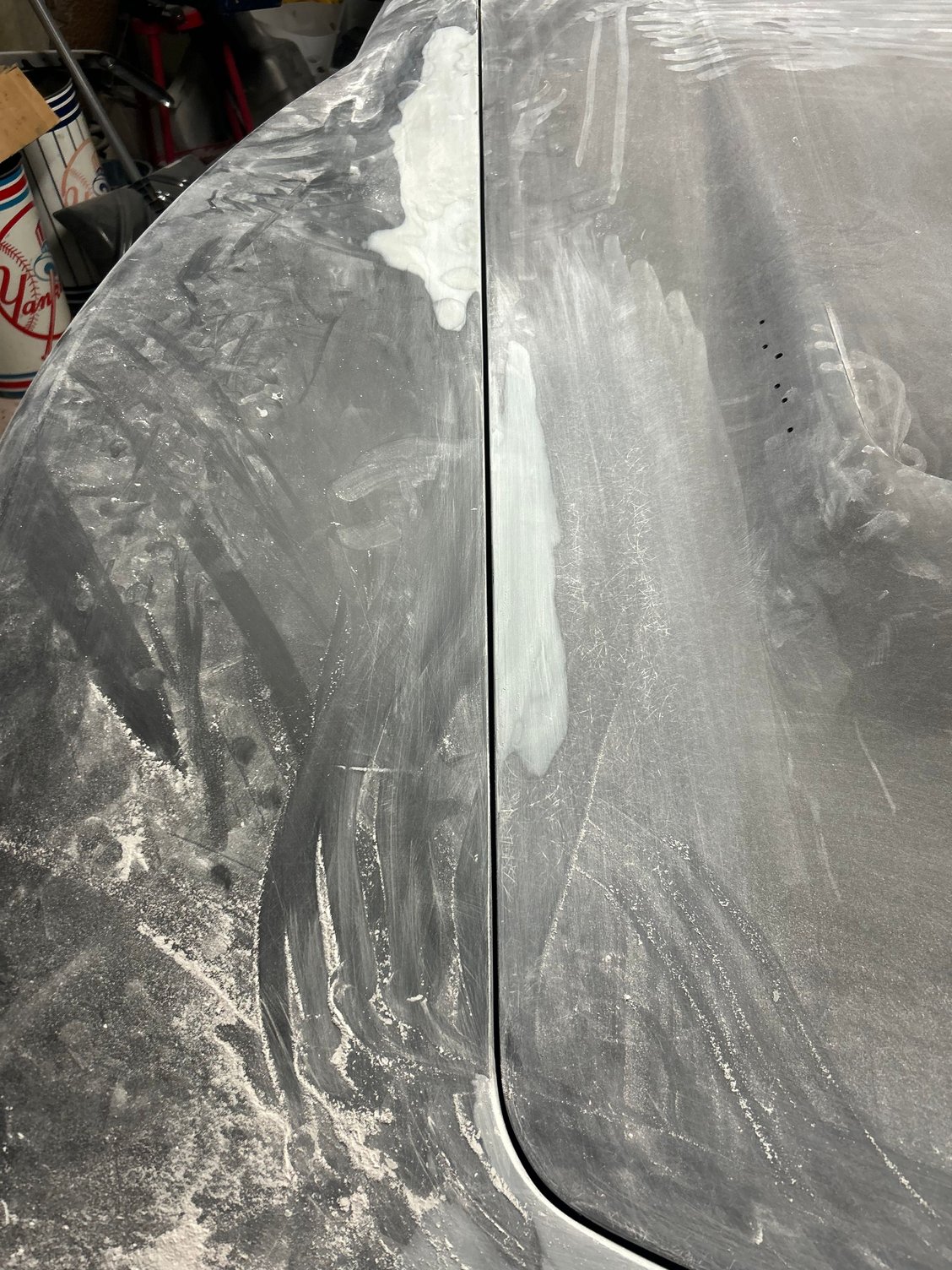

Well after a long while I’m finally making some progress I just retired and spending some time in the garage after taking the whole car apart and frame off and putting it back together.. replaced the front fender and now to the gaps
highs and lows are getting there

That looks pretty good. I thought I was OK but got a chip on one of the front corners. Primer, paint and clear will build up a bit and the clearance changes with hood position. Suggest you run a feeler around that area while you open and close the hood to see what room you've got. Maybe the thickness of a business card or a little more.
Also scribe your hinge position on the other side for future reference.
