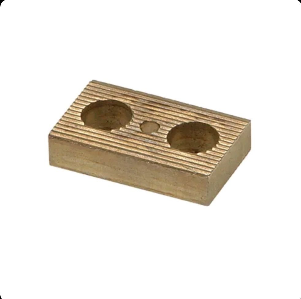

I just rebuilt one using the 5speeds.com kit and it definitely requires some force to get into reverse. I assume that's how it should be since it doesn't have a reverse lockout? As for hitting the left side of the console, do you have this spacer between the body and shifter handle?
The shifter handle that mine has is also slightly "bent" away from the shifter body.

You have to over power the spring to get into reverse. Also helps to place it in 1st gear before hand.
As to hitting like said above make sure the spacer is in the correct spot.

The shifter needs the spacer and you might need longer bolts to get a good grab I used the fake shifter for a hurst it looks like the real one but it’s not I wanted the OEM a look I have NEVER had a problem
