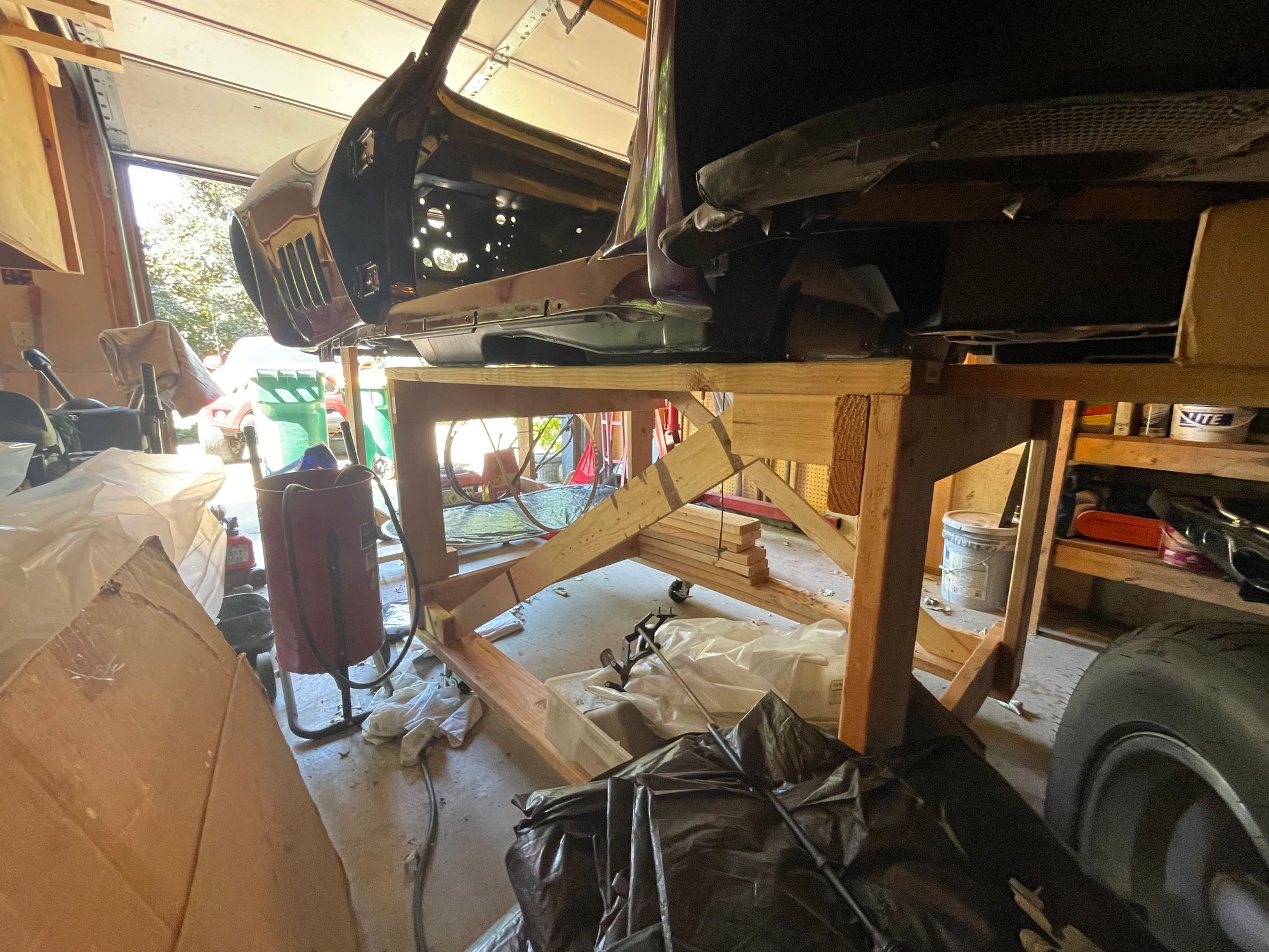

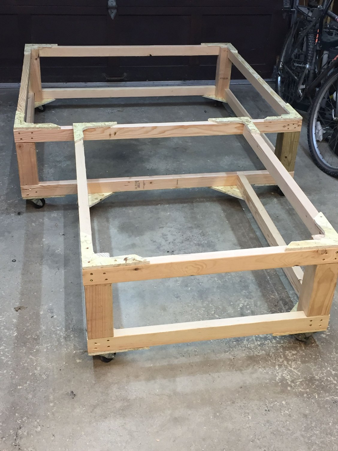

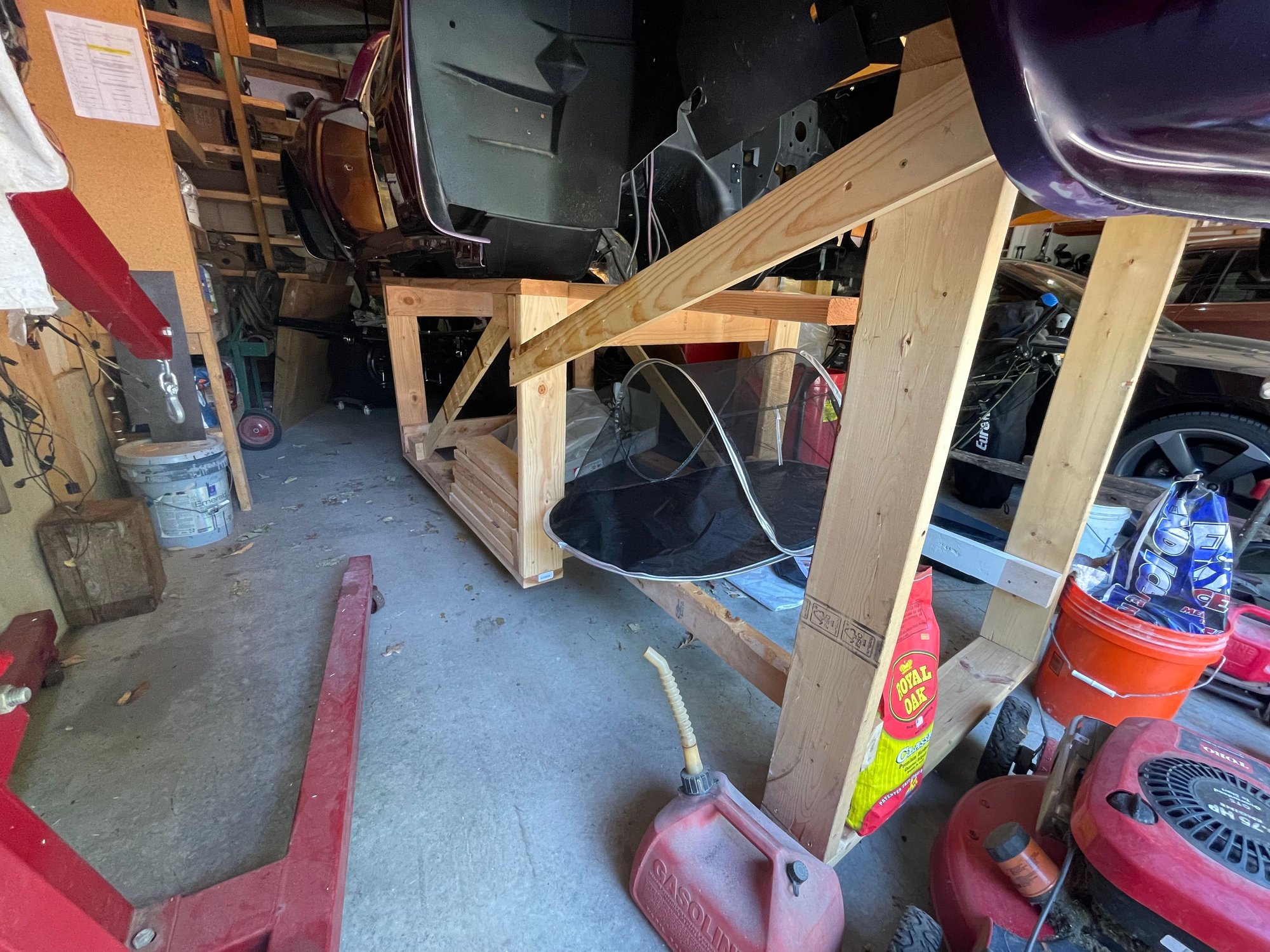

Default I built this one for my '71 and it works wonderfully.
Originally Posted by VancouverL71
I seem to recall seeing plans for a body dolly for the C3 body but can not locate them on here. Does anyone have plans for one? I plan to remove the body off a 1969 I just purchased but need some type of a dolly first to hold it once off. I will likely fab it out of metal but even wood plans would be helpful.
Thanks, Pete
It was very easy to build and the plans were perfect. It's not heavy and rolls very easily and the body doesn't shift when moving it. Detailed plans and materials are in the attached pdf.
