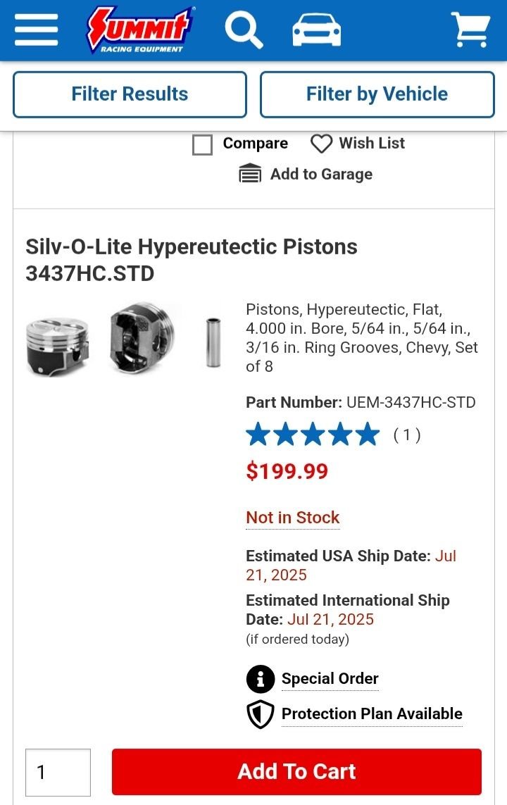

A set of hyper flat tops/ rings
that's what I'm running. Cheap as chips to rebuild a gen 1 350.
I purchased STD. Bore hypers
Honed my cylinders. In they went. Yes his block if the crank is good and it has no cracks can be rebuilt on the cheap , make decent power and be dependable. The most expensive part will be decent heads. And even thous have come way down in price.

@4-vettes thanks for posting those! I was actually just doing some research on which pistons would be appropriate to buy as replacements, although I'm obviously going to wait and check the measurements first to find out if anything is over or undersize.
