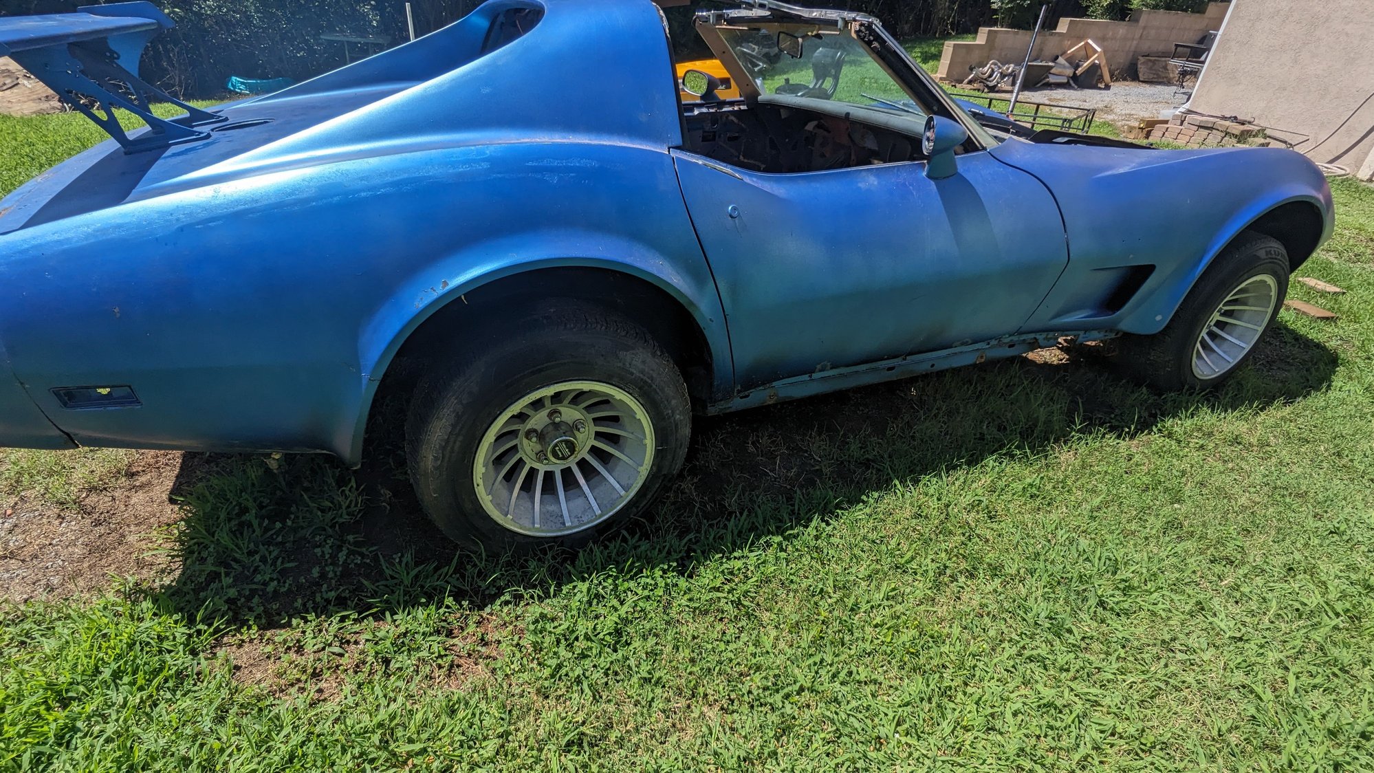

The bodywork is...sort of in okay shape? I guess it depends on which spot you're looking at. The rear bumper is absolutely trashed, the wheel openings are cracked, the firewall and some areas of the floor have holes in the fiberglass, the rear window fell out while pressure washing it, and most of the rear of the car is covered in what looks like gouges into the fiberglass surface. It also had a giant wing spoiler when I got it and from what I can tell somebody thrashed the thing.
It was originally a Dark Blue with Tan interior car, which I'm sure was probably very attractive. It seems it was poorly repainted black at some point, then a very 90's Fox Mustang metallic teal, then a very 90's metallic blue which it currently is. Plans for the interior are to get seats and windows in it and a working dash with gauges and worry about the rest later.

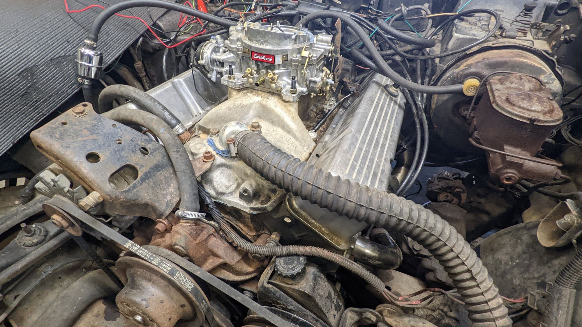

I pulled the 305 late last year when I found the cylinders full of coolant, so my current idea is either a used but ready 350 or maybe a 2000's Tahoe LS. I'm not afraid to get into that world but it depends on availability and price I guess. It's not really a priority as is though. I spent forever looking for a replacement steering column for it after the rack and sector came loose while trying to reconnect the ignition switch to it instead of the crappy push button wiring. Oh, yeah, I forgot I replaced the dash side harness with a used one off eBay after I realized most of them had melted or been chewed through. Again, super budget.

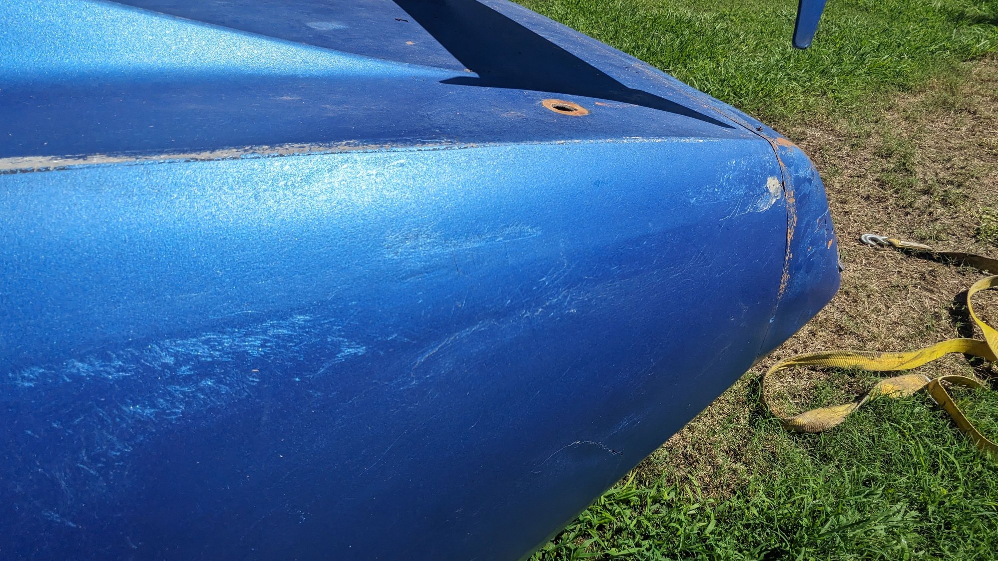

Really nice crack in this quarter. Also I really admire the commitment to absolutely no masking on this paint job. Masking a rectangle is perhaps the easiest shape possible to cover with tape, but no. We don't have time for that.
All jokes aside, these are some good detail shots of the body damage. It seems like it's gouged down to the fiberglass? seems to be the case all over the rear of the car.

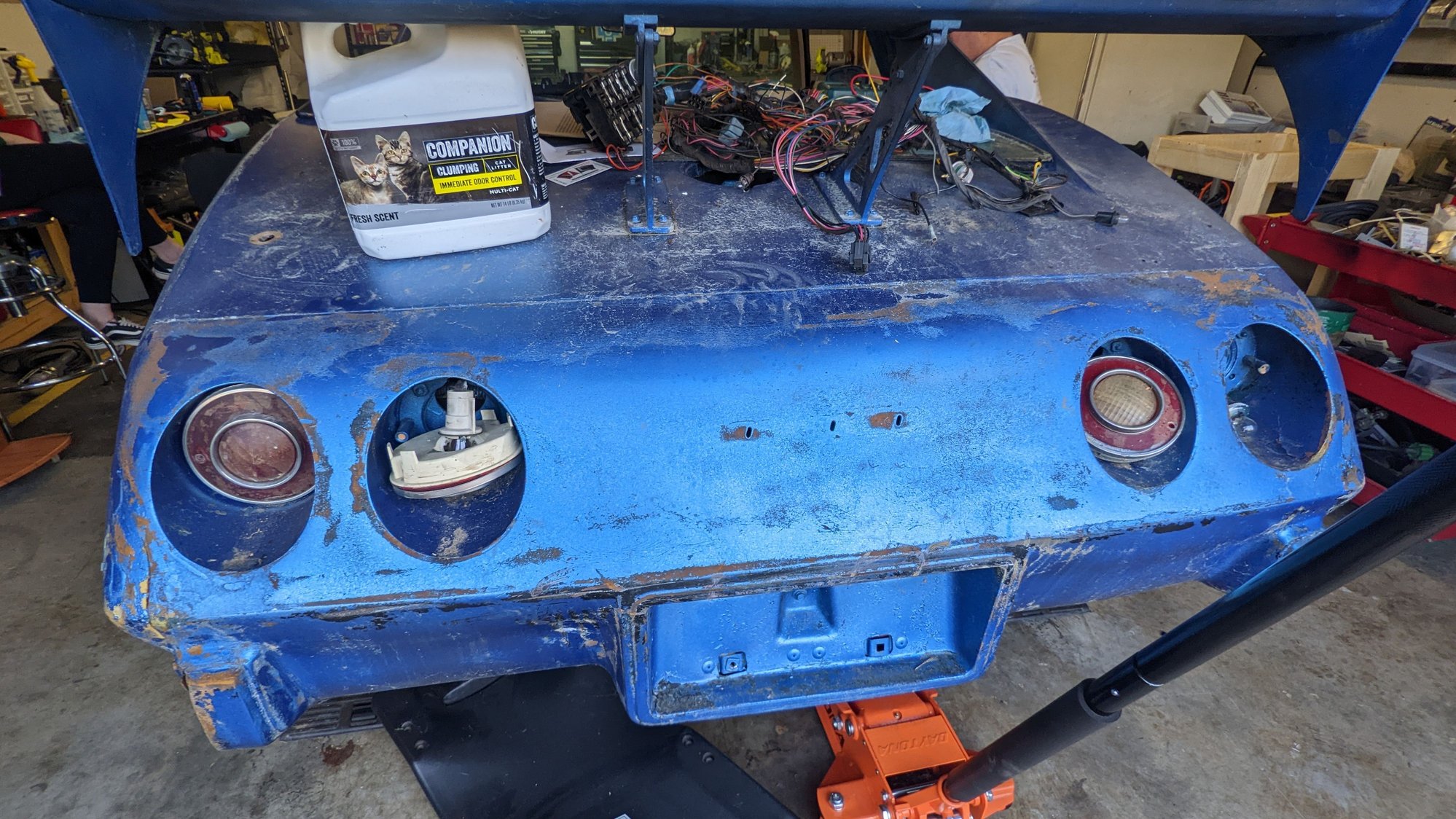

The nose has seen better days, if it gets replaced it will be with a fiberglass alternative I think.

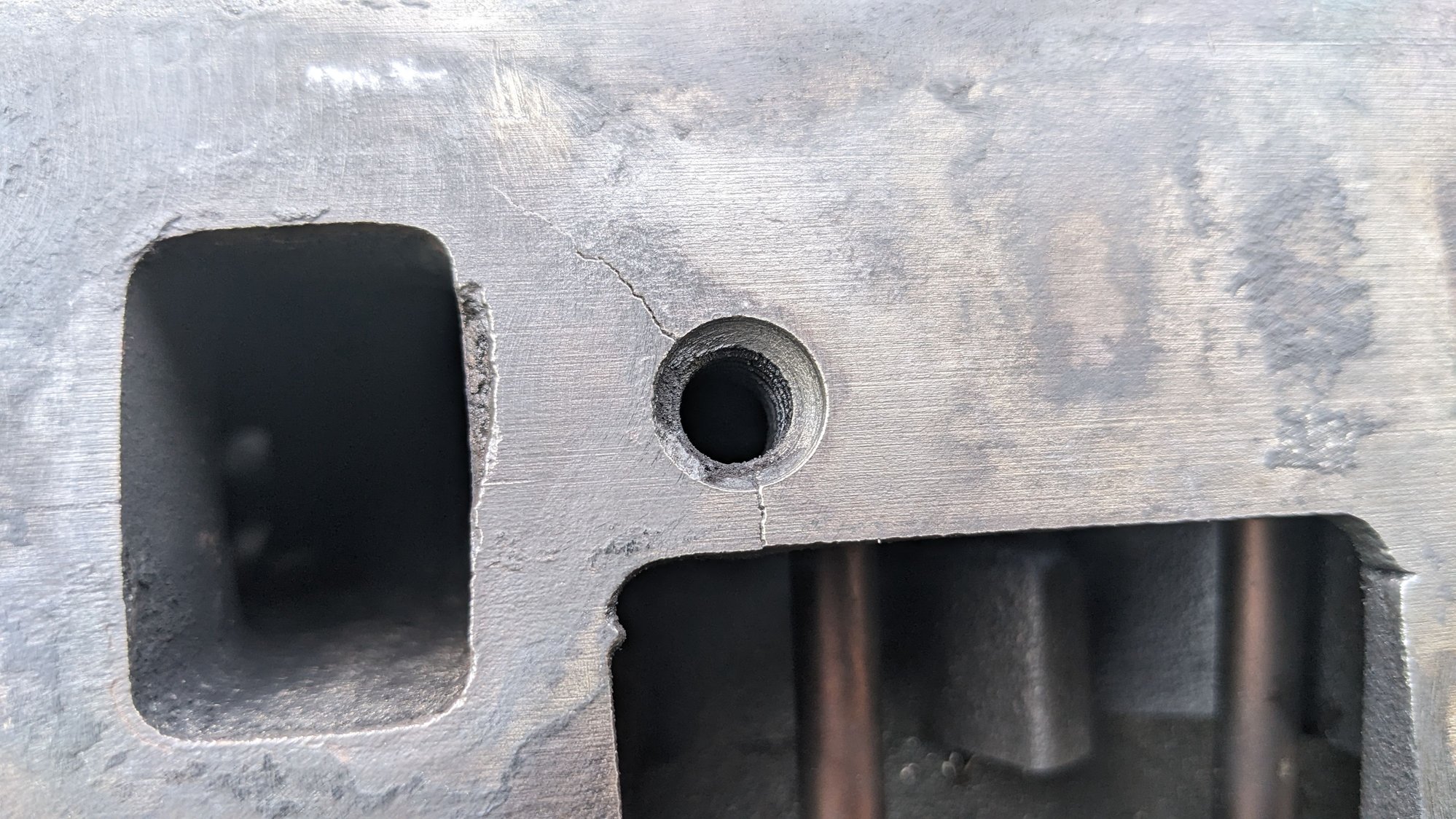

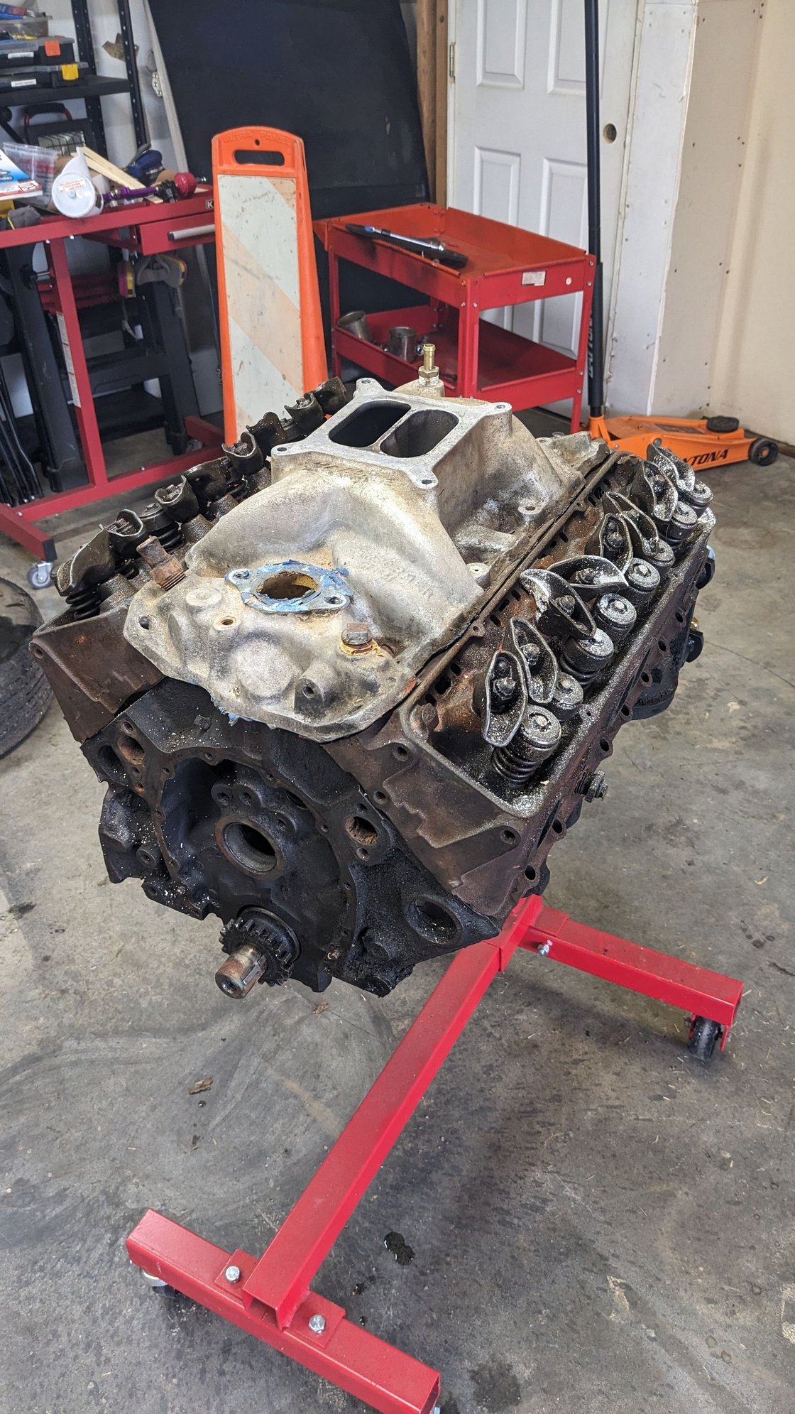

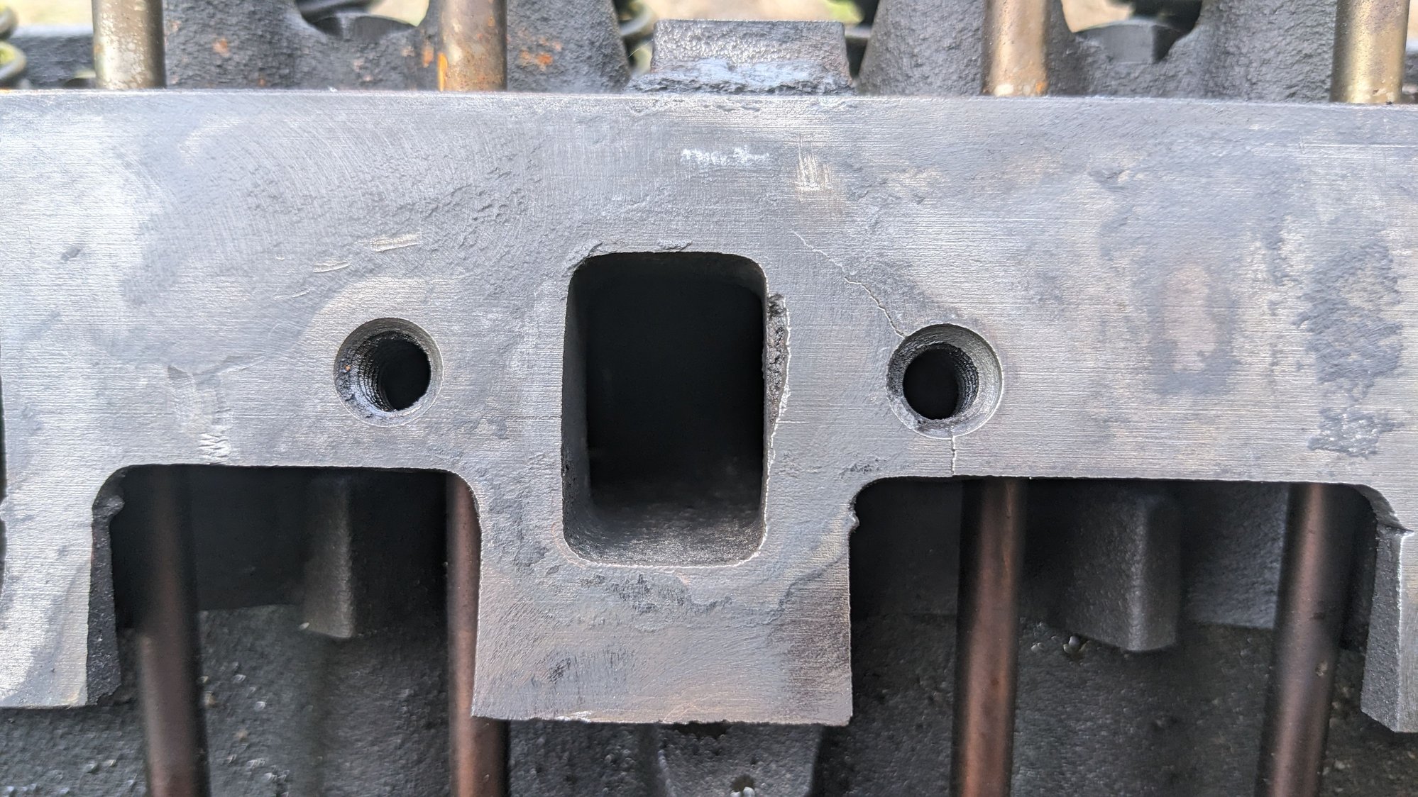

Update! As usual, a million things got in the way of progress on the car. The main obstacle for me is that the car is at my dad's house 4 hours away so I'm only able to work on it for a few days/hours when I visit. I struggled to find a decent motor to replace the 305 with, but I managed to find two off Marketplace over the Christmas visit. The first is a 4 bolt main block with heads, no internals besides a crank that the guy told me was junk he put in for storage. It looked like it was in fairly good shape and I liked the idea of a clean slate to learn about engine building, so I picked it up. Apparently it had been in his father's C10 and after 40 years of parking under the same tree, the tree landed on the truck. He pulled the motor and gutted it to rebuild but ended up using the new parts for a different build. Not sure what the plan is for it just yet. My initial thought was to find a machine shop nearby and have them clean it up at a minimum, plus take any critical measurements to aid in the process of building it. Timeline for this would be well over a year, making small progress each month and hopefully assembling it over a few trips as parts are ordered. Definitely would build it for performance but if nothing else, it's a backup motor for my dad's Light Blue '77 if tragedy strikes. These are all phone pics, next updates will be with the good camera lol.

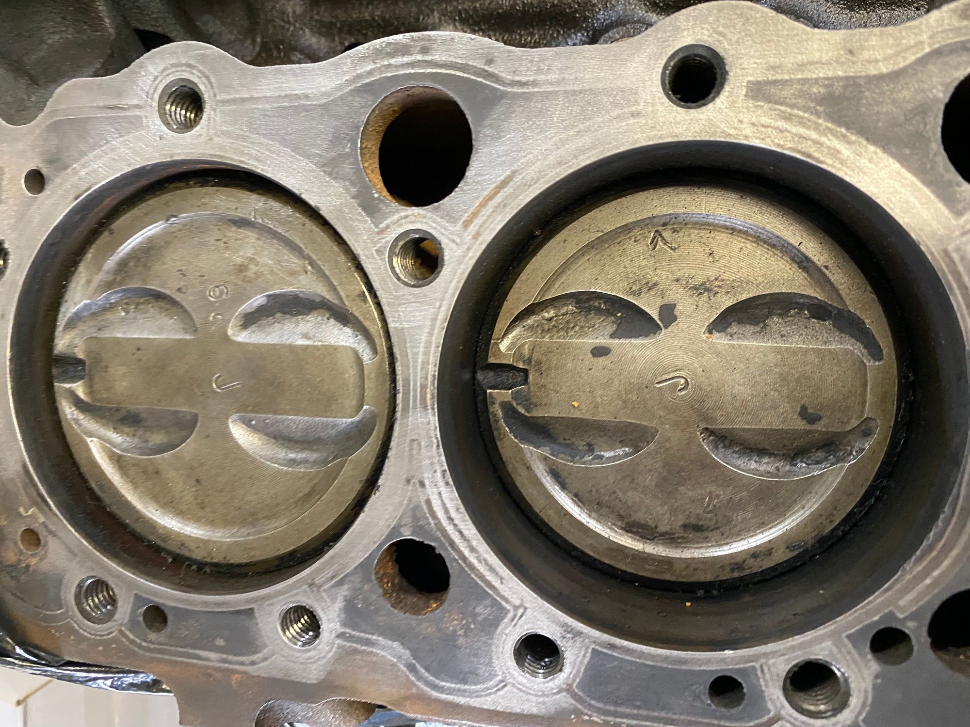

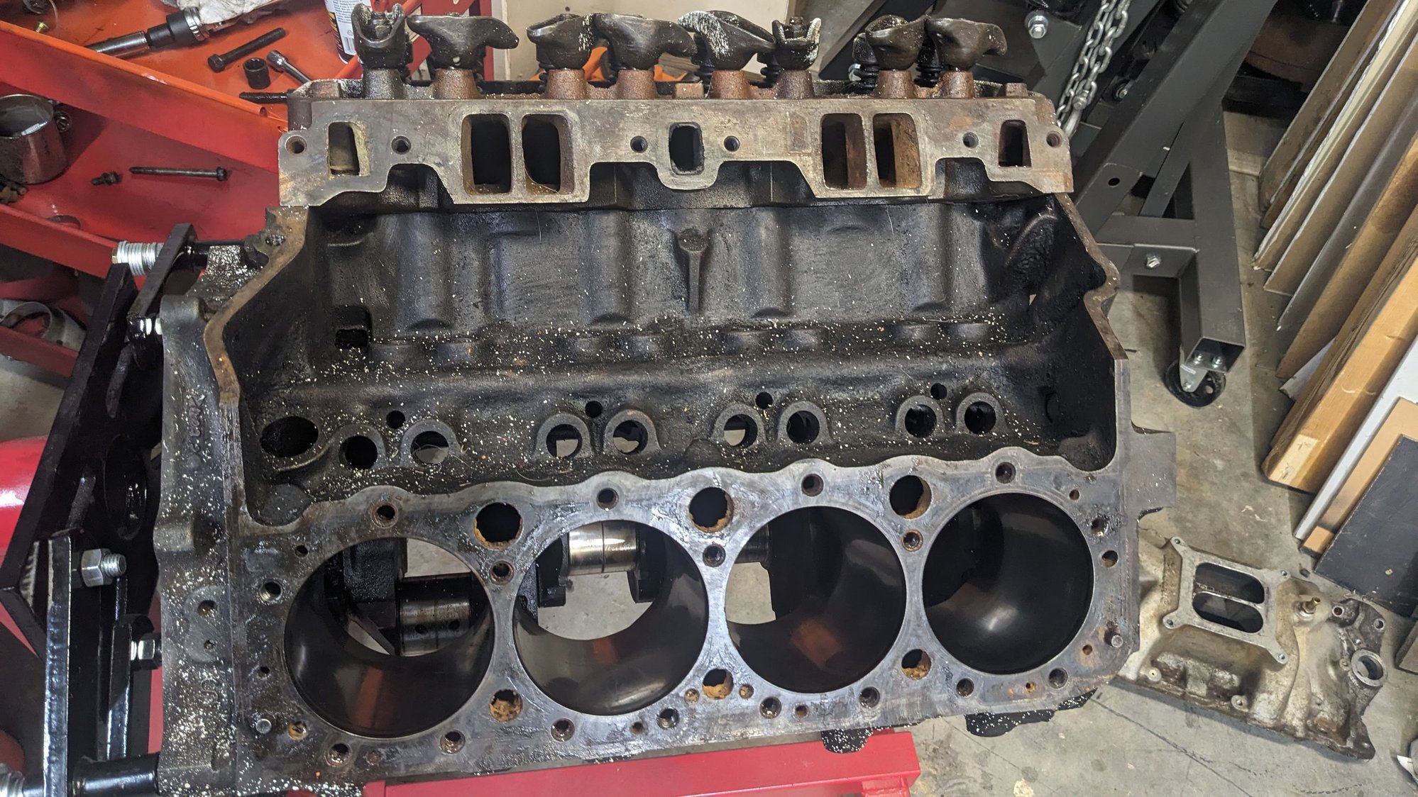

4 Bolt block. Intake manifold stolen off the 305, kept it for weight savings. The entire motor is a grease pit outside but not too bad inside. Apparently the white dust is fake snow from being stored near some Christmas decorations.

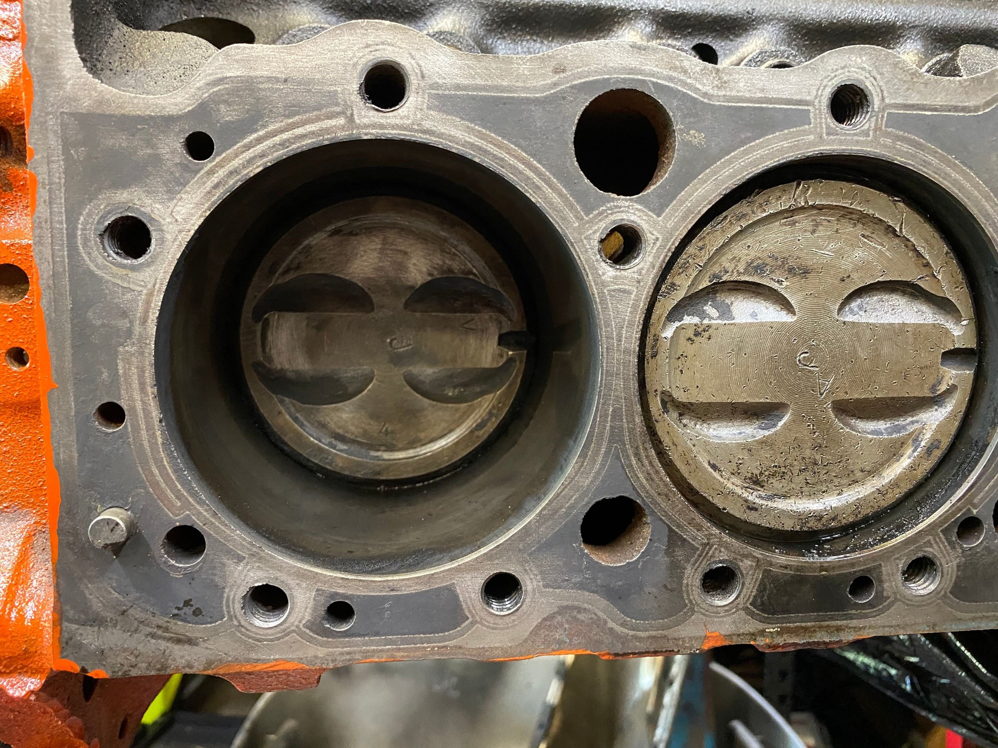

Only wear I saw in the cylinders.
What do you guys think?

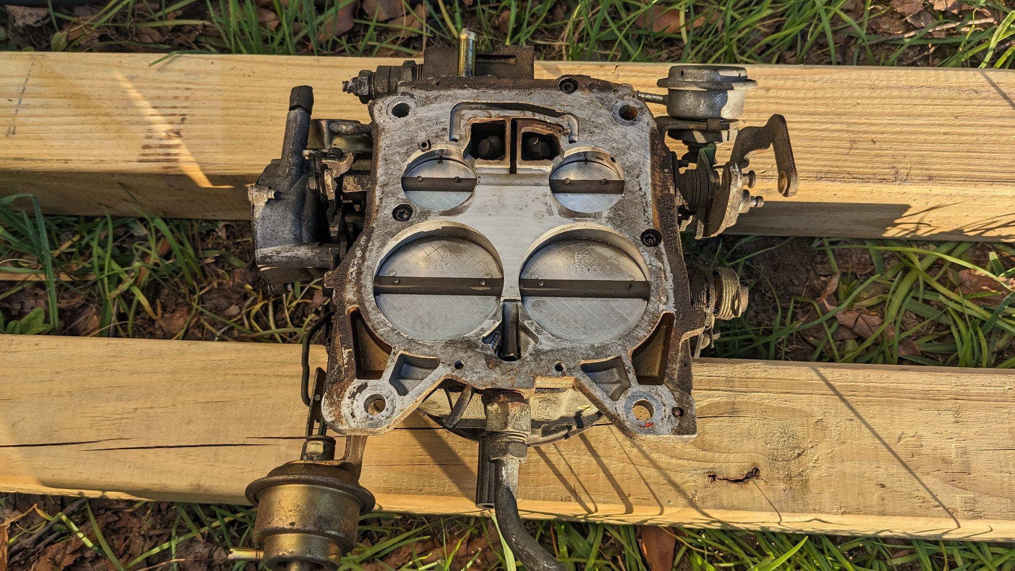

Quadrajet took some damage. Not sure if it's still usable but I have some backup options.

The secondary air valve linkage on that Quadrajet is busted off. At least the air horn and choke pull-off would have to be replaced, but it wouldn’t fit on your square bore aluminum intake manifold anyways.
I would definitely be looking at a new engine wiring harness if you want to go back to the drivers side mounted alternator.

@Piersonpie Thanks for pointing that out. I saw the damage to that area but didn't know exactly how to refer to that specific part. I managed to find a donor Quadrajet I can use for parts or as a stock swap if need be. As for the intake, depending on how I feel I'll either keep the stock cast intake for the moment or swap a donor Holley or Edelbrock carb I have with the Performer intake.
I'll scope out the price on a new harness vs. a lightly used engine harness on eBay. I did that for the dash harness and saved a ton of money last year.

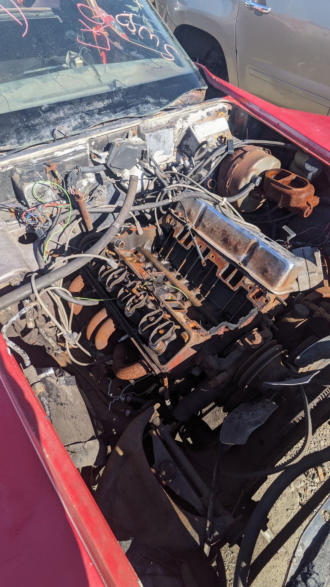

I'm lucky enough to have two pretty nice junkyards near me here in Savannah, and I occasionally search for Corvettes in the yard for fun while looking for parts for my Jeep Cherokee. I think in three years I've only ever seen three, and they have all been C4's. Imagine my surprise when I searched "corvette" upon getting back into town to find out that the local LKQ yard has a 1977 Corvette, and has had it since late October. I honestly couldn't believe it at first because they rarely have anything older than 1995 or so and if they ever have anything pre-85 it's usually a Cadillac or older Town Car. Absolutely couldn't believe a C3 ended up there. Believe me when I say I RUSHED out to the yard to see what was left of it, hoping to find the steering column intact and whatever else I could use.
I found it pretty quickly, it had been moved up to the first three rows of the yard. It had been picked over a bit since it had arrived based off the photos. The column was gone, along with the custom hood and the wheels and tires. The lone remaining tire looked like a Trans Am wheel though, so I have a feeling there weren't a ton of original parts left on it when it arrived.
Those long fenders make a decent workbench.
Not much left to take here, but I did grab the plastic interior trim. It was all in pretty good shape and I got five or six pieces for $10 total.
If I had the money and the time, I'd totally take the motor and transmission out of it.

I did manage to find a few things worth taking. The heater core/blower motor box was in great shape compared to mine, which is full of holes. Instead of repairing that box, I grabbed this one instead. I contemplated taking the full heater/ductwork box on the dash side but I don't specifically have a need for it right now so I left it for the moment.
The motor and transmission are both intact, but it looks like the motor has been sitting out in the rain for a while, probably months at this point. I WISH it was a 4 speed car, I would spend days getting that out of it if need be. On a side note, let me know if there are any parts or pieces you guys need/want, or if there's anything I should grab. I thought about the AC hard lines, but I wasn't sure if they were worth taking used.

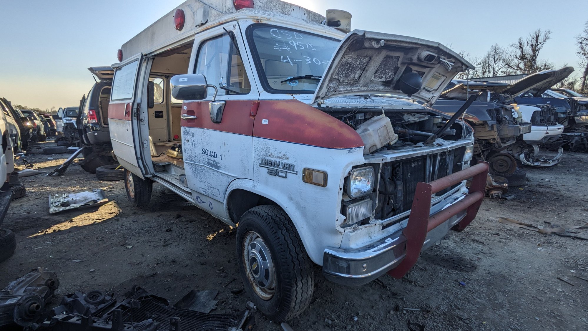

Honestly, Corvettes aside, this thing is so cool.

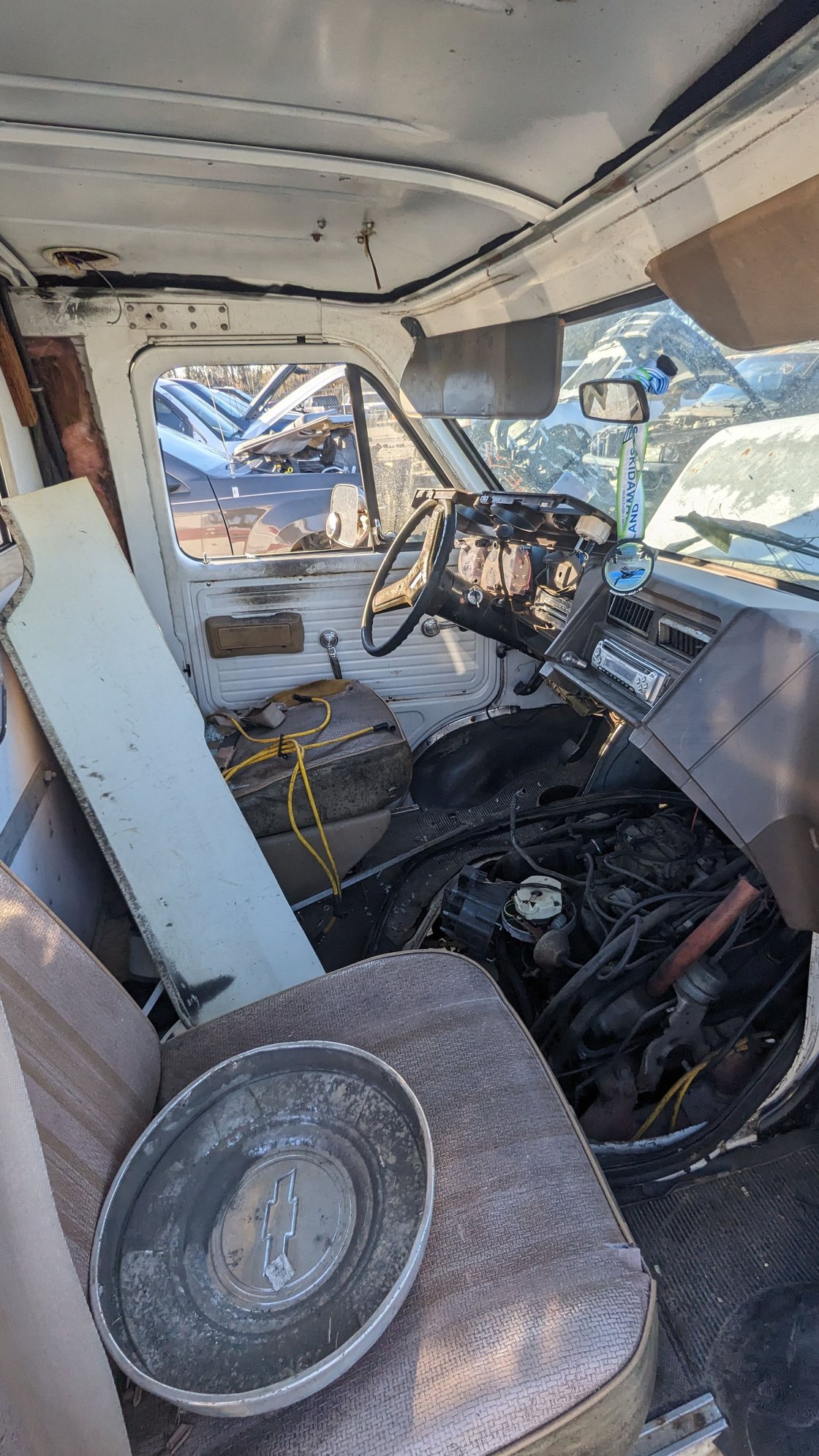

The storage inside these old ambulances is wild.
The amount of storage inside these old ambulances is wild.
The motor was in excellent shape.
I spy...a QUADRAJET!
I poked around this thing for honestly too long, and ended up using its flat floor as a workbench while I worked on a nearby Tahoe. Something about these old van conversions, they're just super cool these days. I have a friend who's into camping at music festivals, and I told them, forget camper vans, get an old AMBULANCE. The storage and flat floor are built right in. Not to mention all the power outlets and dual battery wiring.

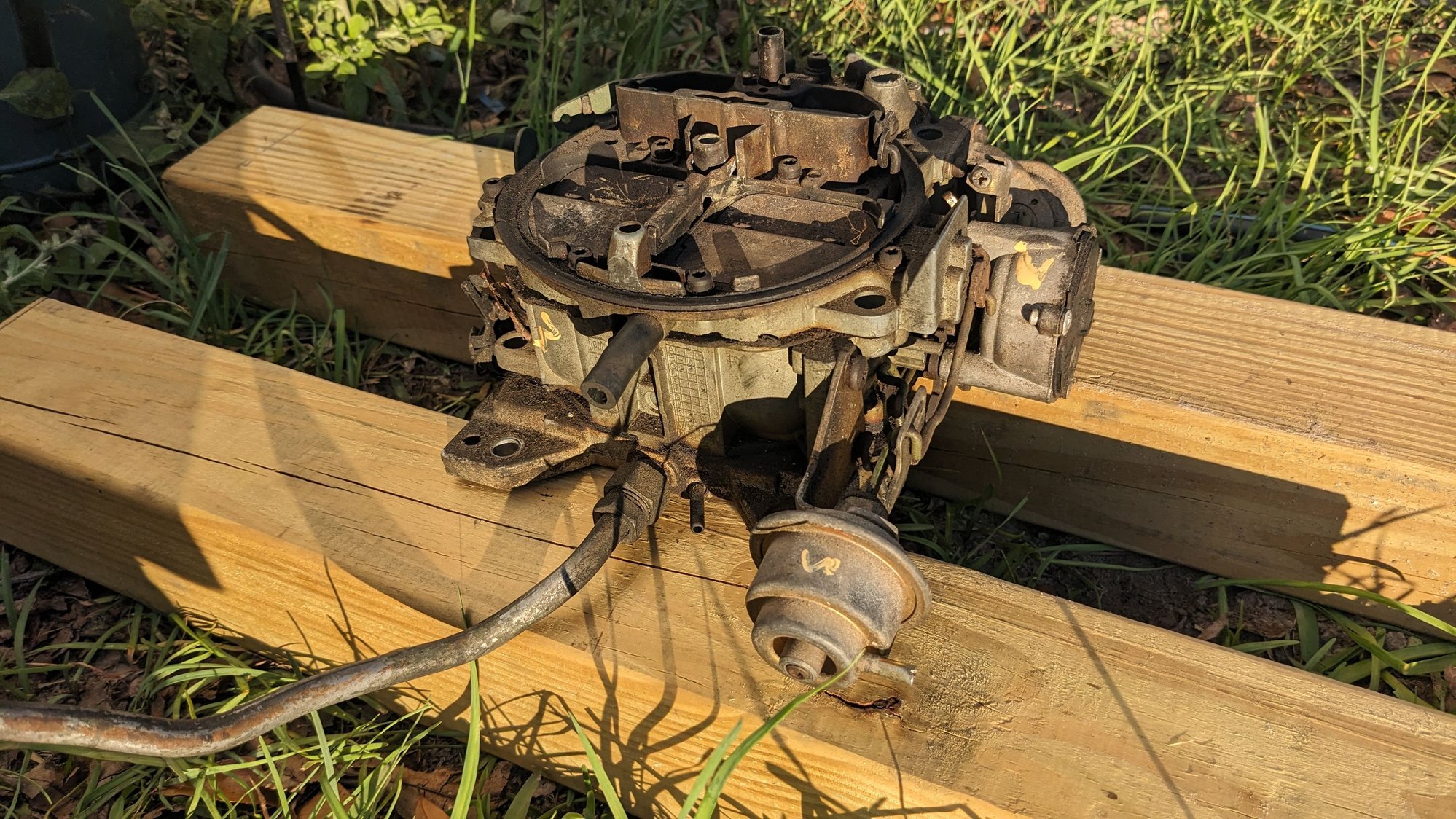

But of course, the thing that caught my eye the most was the Quadrajet in the cab. I know they're not rare, but in the junkyard these days, anything with a carburetor is rare. I rebuilt the Quadrajet in my dad's 77 when he got it years ago, and I decided to grab this one as a fun project to rebuild and also as a hands-on model to learn them inside and out. This one seemed to be in great shape, as did the entire motor. I contemplated grabbing the distributor for the Corvette but that may not be worth the money that LKQ wants for it, especially with prices for cheap new distributors.
Donor Quadrajet. May not use it, but should be a good model to play with and practice on.
Yeah, I was lazy and twisted the fuel line off. I didn't have the time or wrenches to do it right. I apologize to the Chevy club.

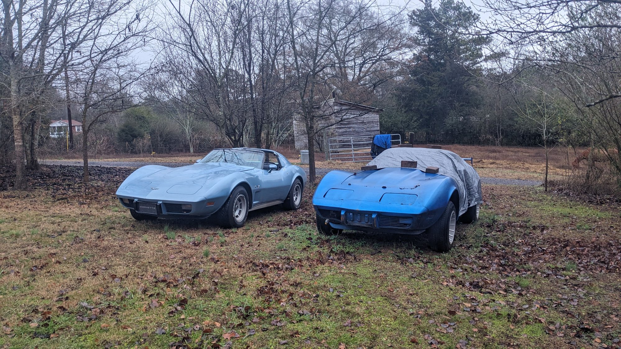

That's a a lot for now, I know. I'll leave you guys with these pics I took of my 77 next to my dad's 77 on a foggy day while moving things around in the shop.
Pretty wild the different lives they've lead.

I love poking around junkyards just to see what they have. Wether I can use it for my car or not it’s always fun to look around and “experience” cars that I would otherwise never own.
One thing to note on that Quadrajet. It has a sticker on the rear of the float bowl on the drivers side. This is a sure sign of a commercial rebuild, meaning there’s probably multiple setup issues that prevent the carb from running how it’s intended to. In most cases this would be a bad thing, but since you have it just to mess with it’s a perfect carb to learn how they go together and if you feel like it destroy it to your hearts content.

@Piersonpie I definitely agree on that, I could spend hours walking around the junkyard. I always feel kind of bad when I see something great there because I know it will never leave, and I want to save them all.
Also, good spot on the sticker! I figured being a service vehicle that it would probably have some replacement/refurbished parts, but good to know either way. My dad's 77 has a rebuilt Quadrajet on it as well. This has me questioning how it runs now as well. Is the consensus that commercially rebuilt carbs are generally junk and not worth running? Or is it more of a case-by-case basis?

It’s pretty hit or miss. Sometimes it’s things like subpar accelerator pumps and gaskets being used. Other times it’s entire different major components from other years being put together. Here is a good thread by Lars that details this. He also has another thread made more recently that talks about what you want to look for when buying a good rebuildable core. The correct carb number for a 1977 L48 with federal emissions and AC is 17057228.
To Project Thread: 1977 Corvette
Old Jan 13, 2025 | 01:15 AM
alleyesonthefuture's Avatar
alleyesonthefuture
Joined: May 2018
Posts: 30
Likes: 6
From: Savannah, Georgia
@Piersonpie Damn, good to know though! I knew there were different Quadrajets through the years and suspected a Van/Truck application would be different in the internals, but had no idea how bad the rebuilt examples were. I can definitely see why those in the know don't bother with them. I also see Torx screws all over that carb now that I'm looking at it, so it will definitely be donating its body to science.
I also am 99% positive the Quadrajet on my dad's car is a rebuild as well from memory. I recall a literal "remanufactured" sticker on the rear as well as maybe a 78 or 79 casting number. It was on the car when he bought it, and I cleaned it up and used a rebuild kit on it not really knowing any better. I'm definitely wondering if it has the same issues mentioned in those threads, and I've always wondered if I could set it up better. Might be time to swap a different carb in and try it out for a while.

Hi guys! Update after a long absence. Starting to clean this motor up and unfortunately noticed one of the 882 heads is cracked around the center bolt holes.
Couple of questions:
1. is that a good candidate to just Helicoil up and hope for the best? I plan on replacing these heads eventually so it's not a forever fix but good enough to get it moving and make some progress.
2. Seems like that mounting hole is right around the center air port and not the coolant passage, so I'm guessing at worst it would leak air and not coolant right?
3. I have a spare set of 993 heads I could swap over. Is there an issue with reusing the pushrods from the current motor on those 993 heads, or does it not really matter anyway since the rods are mating to the lifters and not the rocker arms on the heads?
Thanks again. Gonna go get knee deep in degreaser now.
Update: I ended up deciding to trash the 882s and fix up the 993s for now!

Tore into the L48 I bought off Marketplace a few months back after degreasing it and pressure washing all the gunk off. Took forever to find the hidden bolt under the EGR valve diaphragm on the intake though, that was a small struggle.
Once I got the intake off I noticed the crack in the head mating surface I posted above. I'm 50/50 on whether I caused the crack trying to pry the intake off with that bolt left in or whether the previous owner cracked it since it looks like they had a lot of sealant around that port. Either way, I had the spare set of 993 heads from the 4 bolt block i bought around the same time, so I quickly decided to go with those instead.
After removing the heads, I got my first look at the pistons on this motor. I'd say 6 of the 8 look fairly decent, with 1 or 2 even looking brand new from the tops after a lot of scrubbing with gasoline and brushes. There are 2 that don't look so hot, however, with major divots and chips taken out of the tops. I didn't notice any damage on the underside of the heads, so I'm assuming something made its way into those two cylinders and caused the damage.
Since I'm further than just a simple clean and maybe refresh at this point, seeing this has me thinking I should continue to strip the engine down and check everything else I can, and then take it to a local machine shop and have them check all the measurements I'm unable to.
Since they'd have it, I would have them go ahead and hot tank the block at that point, plus any other highly specific stuff that would save me time and headache down the line. I'd hate to put the whole thing back together to find out one of the cylinders is out of round and it burns oil.
This also has me thinking I might as well use this opportunity to get rid of the dished pistons and replace the cam. My original plan was to just clean it and run it as stock for awhile before making any major upgrades, but we're in the operating room already so I guess we might as well.
