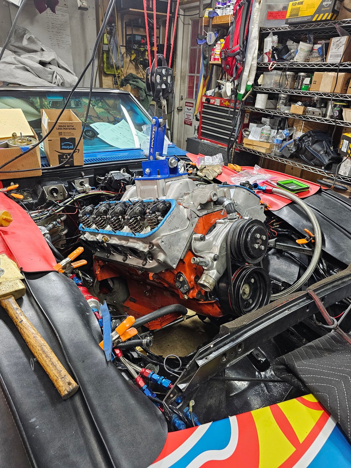

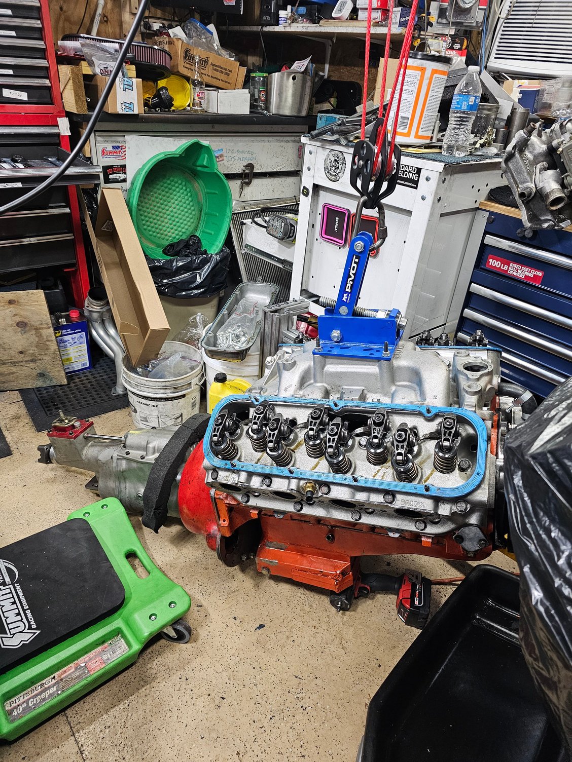

I pulled the 454 out of my 70. I removed the radiator and shroud first. I pulled the engine/bellhousing/transmission as one assembly. I always pull the engine/bellhousing/transmission as one unit. Take out only the engine and bell housing?.......No way am I going to lay on my back and try to get the transmission input shaft backing the clutch assembly with a fixed transmission crossmember. No way. It's just me. When I get the engine finished, I assemble the clutch and transmission out of the car......it's soooo much easier. I used a harbor freight engine hoist and a "load leveler" where I could tilt the engine/bellhousing/transmission assembly for ease getting in and out. With an engine hoist, during removal you'll reach a point where have to angle the nose of the engine up in the air to start to get the entire assembly to swing up and over the radiator frame. As for removing the engine, bell housing, transmission.......the whole assembly is only held on, in the car, by four bolts. The engine motor mounts (2 bolts) and the transmission/crossmember bolts (2).

I did it by myself with a leveler device on the hoist.
If you are going to leave the trans in the car, unbolt the 4 trans bolts..
Separate it an inch with a crowbar.
Set the car down, and put a jack under the trans.

i always pull the engine and trans separately. i know everyone will jump and bash me and tell me im an idiot and they do it together.
but really- you are under the car anyway disconnecting things, how much more work is it to either unbolt 4 trans to bellhousing bolts or 6 bellhousing to engine bolts? if you unbolt the bellhousing from the engine you only have to pull forward like 3-4" and it lifts straight out. then go back under the car and pull the trans by itself.
