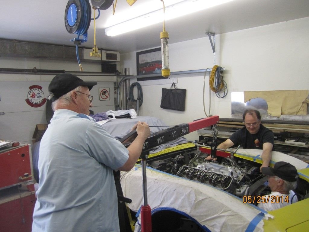

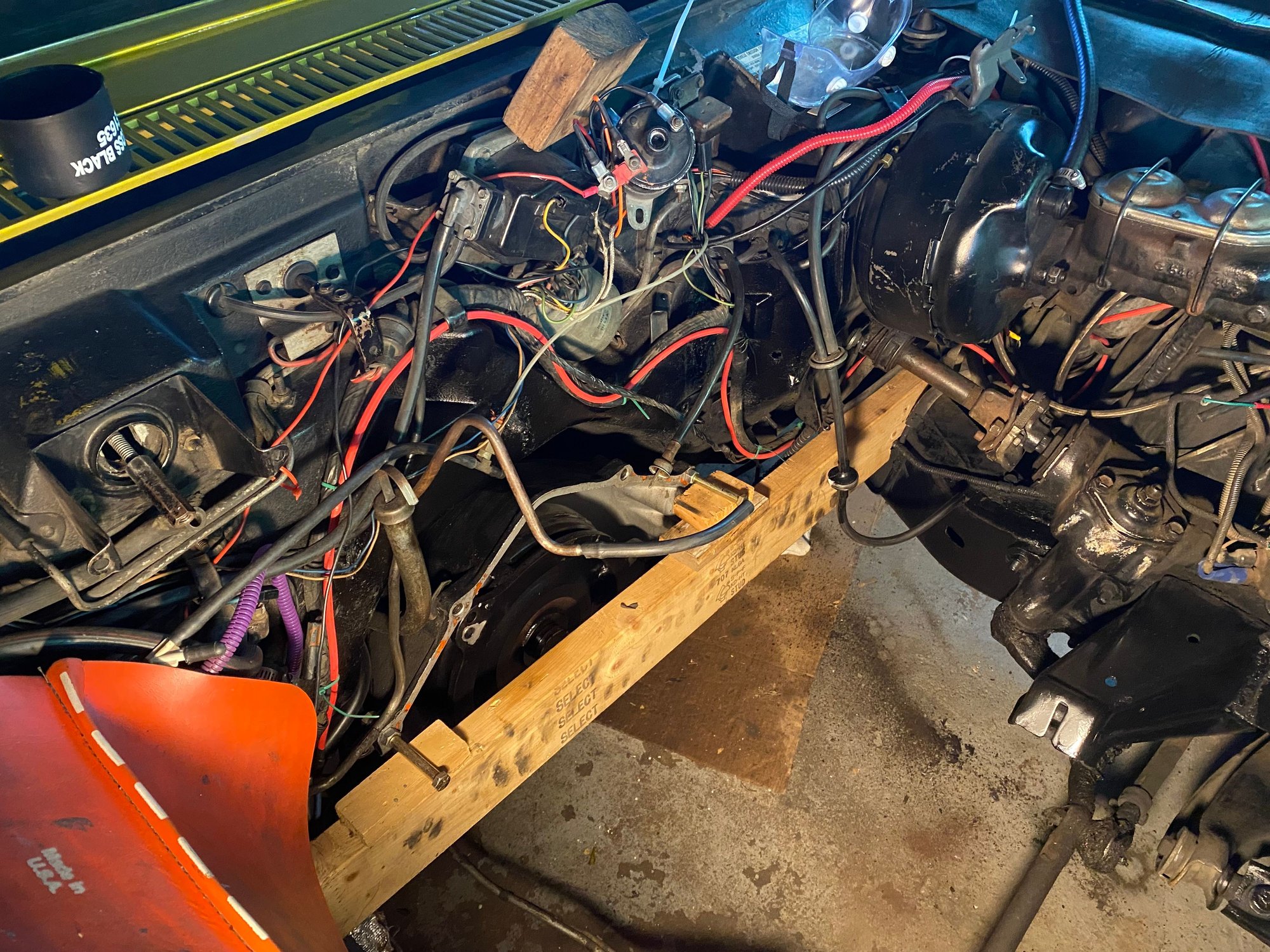

I left the trans in the car. Then I just slipped the engine forward and left the trans in place. It needed a jack under it, until I could park a 2*4 under the input shaft to the frame rails to hold it.
I had major concerns about height in my 9.'2" garage ceiling and getting the hoist up high enough, even from the side, to get the oil pan over the fender and the hoist not hit the ceiling. It was all kind of tight. I even removed the left front wheel, and lowered the car almost down to the rotor. I had a leveling attachment on there which almost made it all too tall. But it all worked.
Boy wish I had a couple helpers! Managed to do it as a one man show. But that 600# lump bouncing over the fiberglass was nerve racking.

Cool pic...glad I'm not going to be in the bay like that though...! I pulled the support so it's all open up front. Is yours a stick and did you have to brace the trans to pull the motor and leave it in there?

Interesting on the 2x4 idea. Maybe I can do that while it's up in the air and then drop down to pull the engine for overhead clearance... Looks like you were elevated for the whole thing? Also, how did you post the photo? I tried and it just made an attachment...
