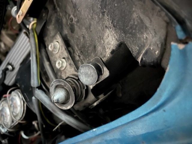

My hood will not close because this part is bent (see pictures), what is it called and where can I buy a new one? I have seen a few used on Ebay, but have not been able to find any at the online Corvette stores.

why don't you just bend it back? Or am I missing something?
the more interesting question is how did it get bent?

The part you have circled is part of the hood latch mechanism.

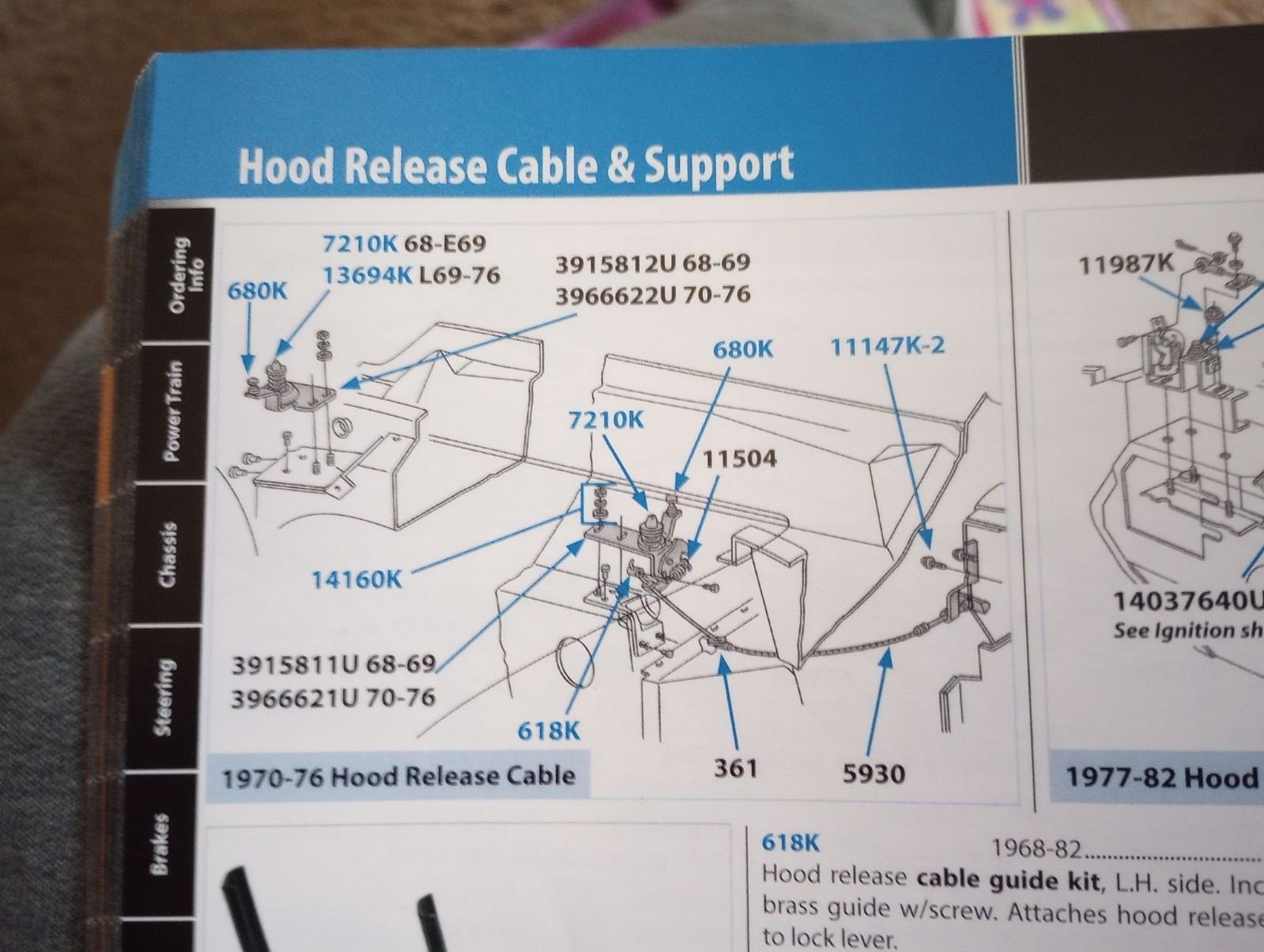

Paragon Reproduction used to sell those and they were called "Male Hood Lock Assembly". Corvette Central took them over so you might try calling them. But really, you can just try straightening it back out first. They were used and you already have one of those.
PS- probably wanna fill the relevant year and whatnot in your profile for future reference.....

Taking it and bending it back is our first thought, just not sure if that will work. No idea how it got bent, we just bought the car with the bent bracket.

Perfect thank you. It's a 1969.
We are going to take it out this weekend and try to straighten it out. If we cant get it to work would being looking to replace it.

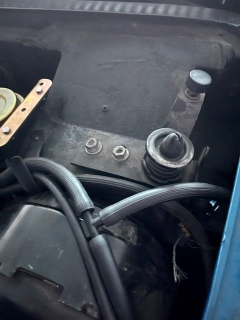

Yes, I would bend it back. Some of these brackets are super hard, and may require some heat to bend, and not crack.
BUT, be carefull when adjusting this that the hood doesn't get stuck--it would be a major problem. I wonder if someone bent it or spaced it up to try to get correct alignment. Mine is flat against the body. Usually, there is enough movement, when the presssure of the spring is released, to move the spring and alignment pin around for a good match to the hood latch. I don't remember, but maybe you can move the hood latch around also, to get a good match.
You can put some grease on the washer above the spring and lightly touch it against the hood latch to make sure it matches, before closing the hood all the way.
The conical part, stud, above the spring can be screwed in or out, and the rubber bumper also, to adjust the hood height fitment.

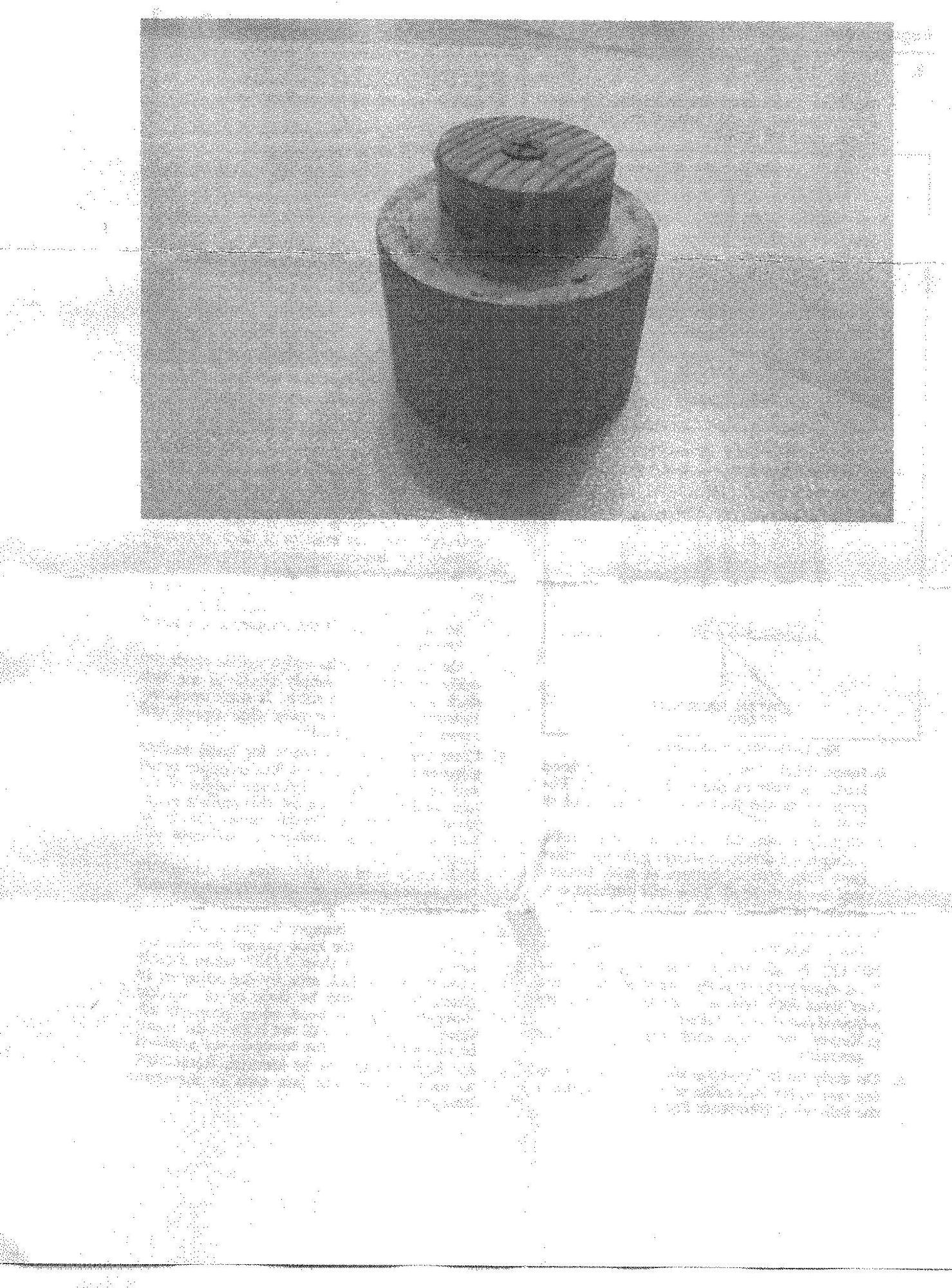

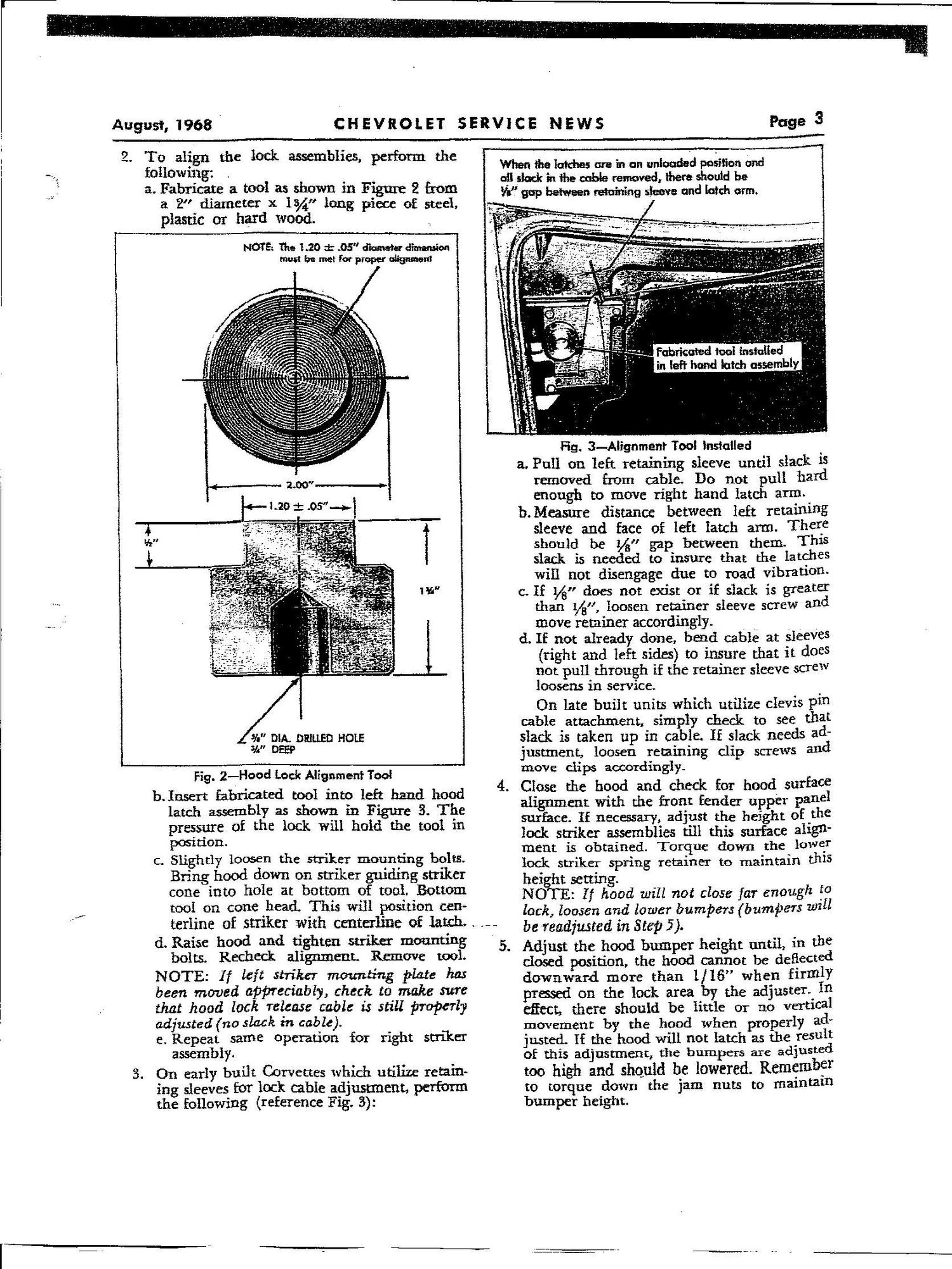

You must get the two parts centered or the hood can get stuck closed.
Buy or build this tool.

Yes, the hood alignment tool is invaluable when installing a hood or adjusting one. Your latch is most likely bent because someone did not use, or know of, this easy to use tool.
They are readily available on eBay and quite affordable:
https://www.ebay.com/itm/13404035722...Bk9SR6bihqWoYw
I recommend straightening yours and using one of these to align. Very simple.
Cheers!

pull it out, put it in a vise and squeeze the bent part straight by flattening it. Then if its still bent try putting on a piece of thick leather on an anvil and striking the center of the curve just enough to straighten it. IF there is a visible crease from the previous owner try clamping on the straight side of the crease and steadily applying pressure to the bent side. You dont want to keep bending it or hammering so that you soften the metal or put waves in it.
that piece needs to be bolted down flat and the piece on the hood is the adjustable side. Provided you have the latches for a 69 vette and you use the tool described above you can align it BEFORE shutting it again. I would put something large and soft at the closure line near where you are working so if the hood gets dropped its dampened by the pillow and doesnt close....do not put anything in the nose of the hood. If you have a clevise pin of sorts there is a hole in the hood prop rod that you can put it into to prevent thehood from accidentally closing while working on it or at car shows from tourists or the wind.

The ebay listing says not for 68-69E.
