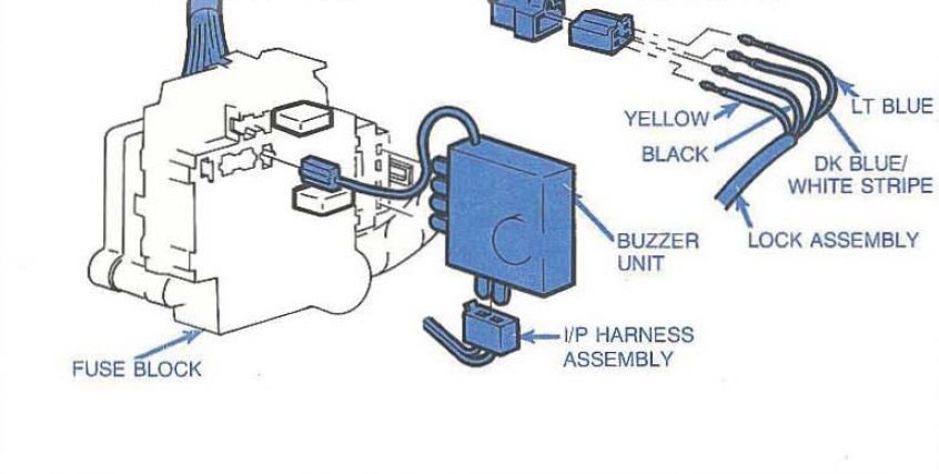

Two different problems. Key buzzer. Switch in column at ign barrel. Grounds though the left hand door switch. If the switch itself is stuck shut and the door switch is grounding even with door closed?????
pink wire with black tracer from buzzer unit to the key switch in the column is likely shorted to ground.
I would start at the buzzer unit. Follow the pink w/black tracer wire looking for a pinch. Unplug the harmonica connector. Does the buzzer stop? Perhaps there is a short to ground inside the column. Etc. Etc. Follow the wire. The key buzzer switch is closed with key off in the off position of the barrel. A little plastic tab that usually wears away and doesn't work hits the switch and closes the contacts. Then a black wire goes from switch to the left door switch which actually has 3 contacts. And yes it's possible to have the dome light go out but the key buzzer to still make contact. The third contact is for the factory alarm.

Your buzzer should have a gray wire coming out of it and landing in the LPS socket of the fuse panel.
That wire is normally HOT when the headlight switch is pulled in either the 1st or second position(s) so when a door is opened and HLS is on the buzzer will sound.
"But" if the buzzer is back feeding internally through that circuit it MAY also feed and illuminate your dash and gauges lamps.
Try unplugging the single wire connector landing in the LPS socket, I believe it should be a single gray wire,

Thanks bmotojoe. I completely removed the buzzer box and still have paring light and dash lights on. Does that have to be connected for the system to function properly? I wouldn't think so but I'm reaching for anything here.
