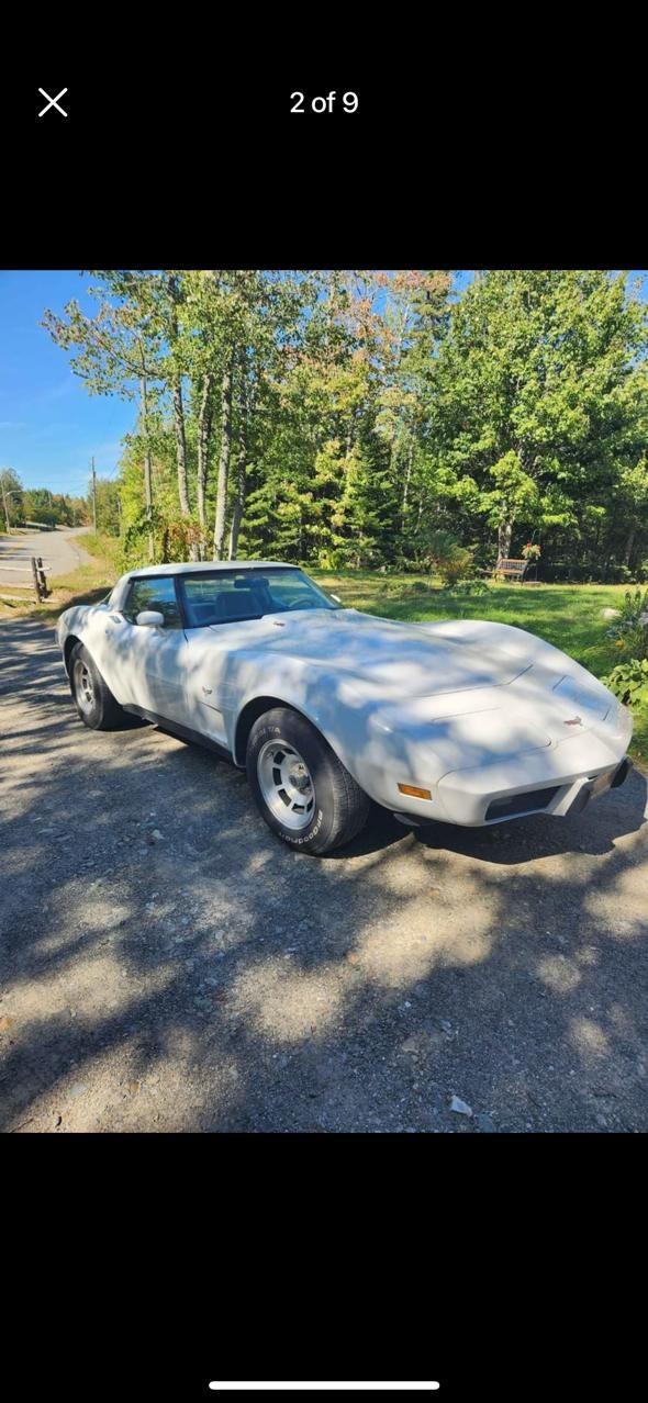

hey guys just wanted to know if this would fit my this fits my engine because I've had issues with other parts if anybody could help me out. My Engine number is 14016379 corvette (1979 L48 corvette C3) so if they fit i can order them as soon as possible thank you guys.
the items i want to order: ( Stage 3 Master Engine Rebuild Overhaul Kit for 1967-1979 Chevrolet SBC 350 5.7L) from ebay they include all these: Rod Bearings: CB663P
