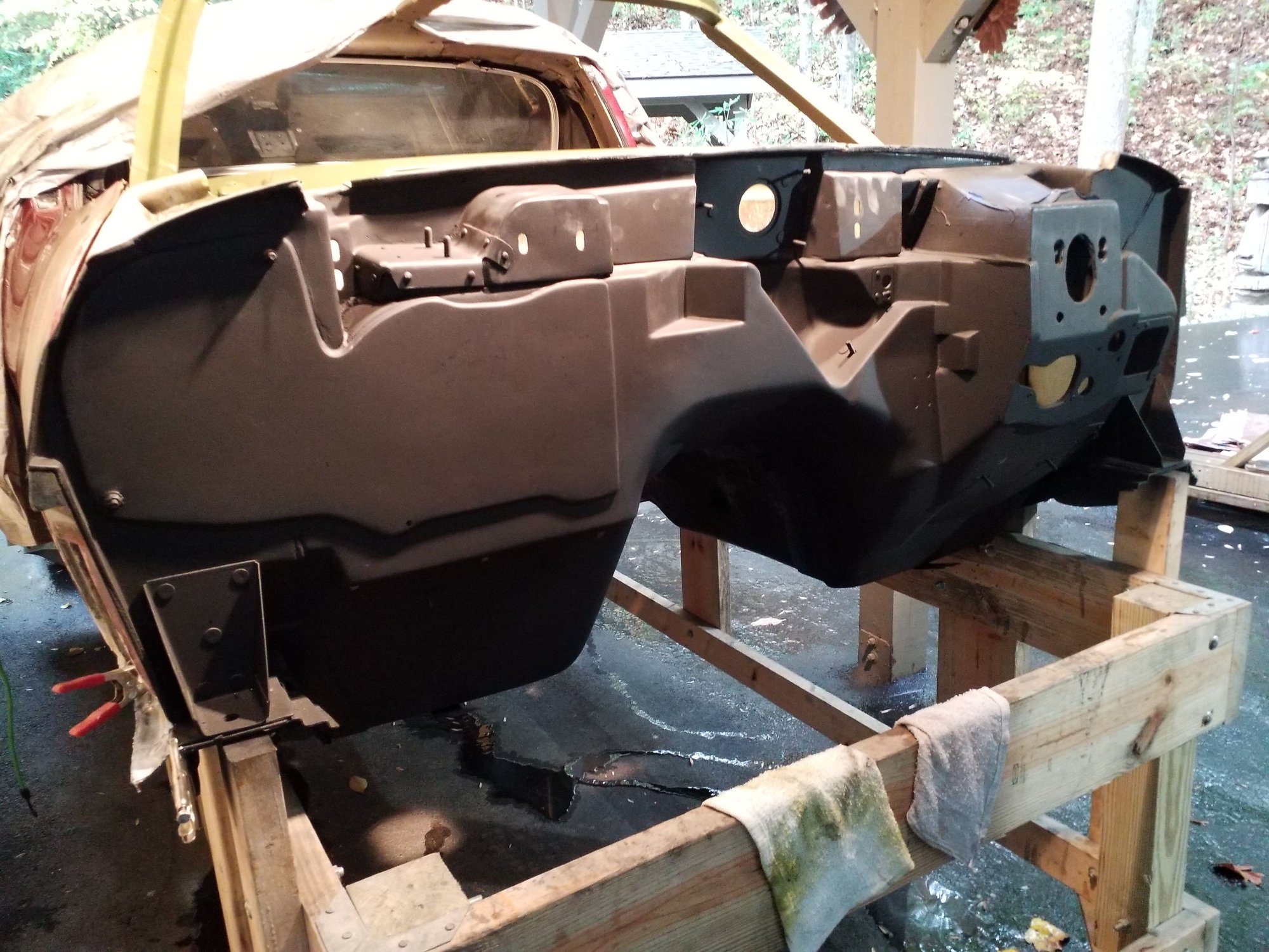

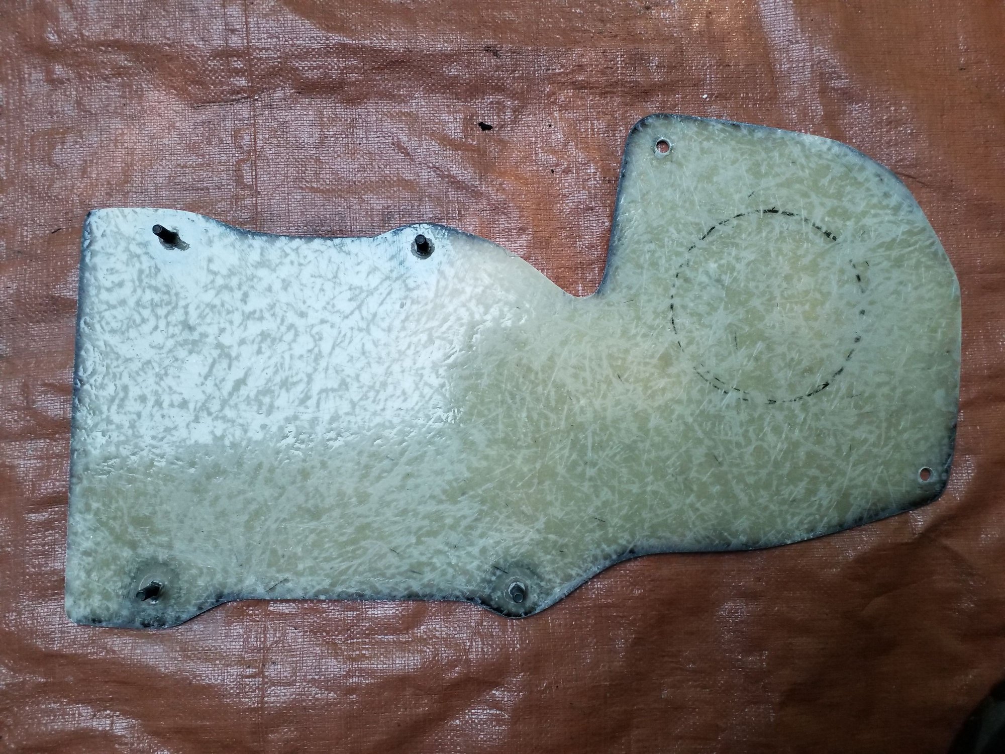

I first made a poster board template...
Next, I cut 6 layers of fiberglass mat to match the shape and laid up the composite part and sanded it down to smooth it out. I also bonded in 4 mounting studs and used the 2 original studs on the car for mounting.
I then bonded it to the firewall and tightened all the studs to pull it tight to the firewall. I'm guessing the removal shaved about 15-20 pounds.I also shaved and smoothed the rest of the firewall and filled any factory holes that I would not be reusing. Hope this helps!
