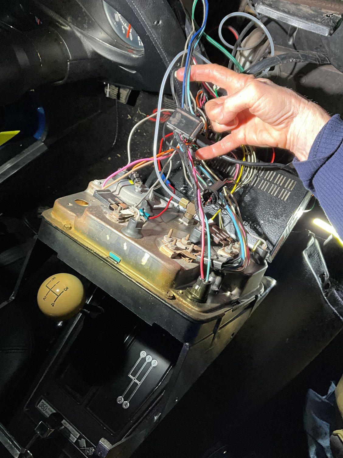

Can anyone tell me were this plug is supposed be connected to

Windshield wiper switch

FWI, pay close attention the the "ears" stamped on the male tabs of the switch, they determin the orientation of the plug (it will go on either way the wrong way and the correct way)
