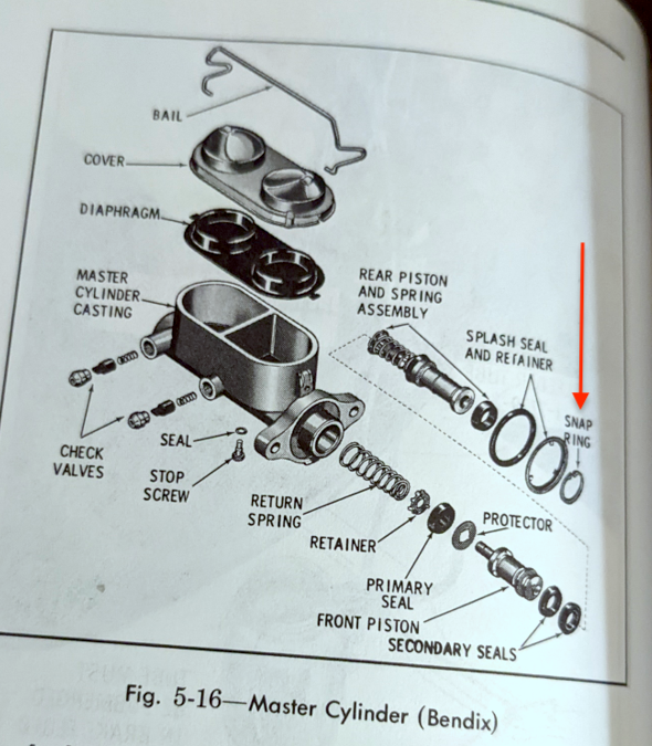

There isn't anything from inside the master cylinder that will come out on its own, unless it's completely rotted and there is brake fluid all down the firewall on the engine side and the interior. The MC's internals are captured by a lock ring. In case you aren't familiar, here's a diagram of a typical Corvette-style MC. I added the arrow to indicate the snap ring that holds everything in the case:

Welp, problem figured out. Pulled MC out again and did a more thorough inspection. What looked to be a mass of wires or something of some sort ended up being a nest of some critter with brake fluid/grease all over it. Whatever it was built its home in the rubber gasket. Going to reassemble new MC tonight and begin the bleeding process. Thanks all!
