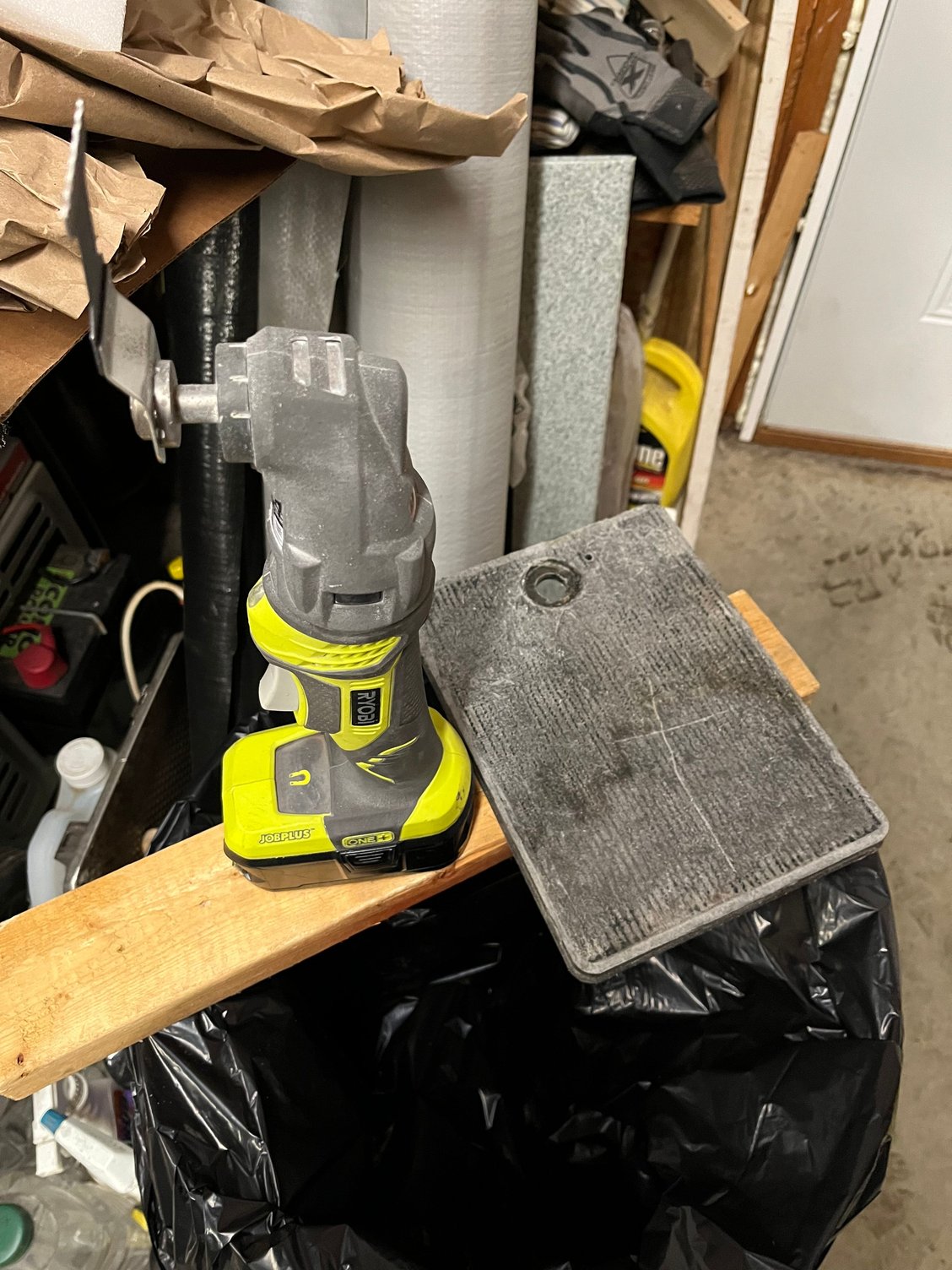

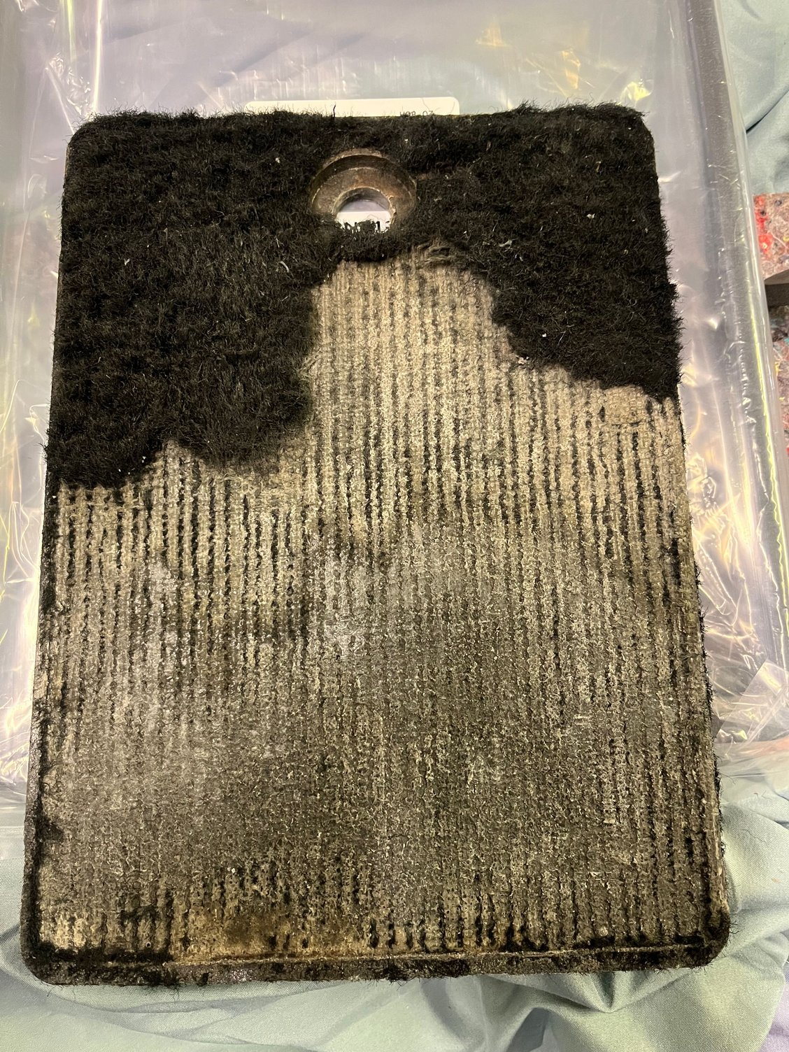

That's exactly what I tried today. It did help a lot, but I was breaking razor blades in the holder like crazy. So I resorted to mechanical means:
That did the trick nicely! Kind of like shaving it off. Afterwards I took my orbital sander to it with some 80 grit and finished it up.
