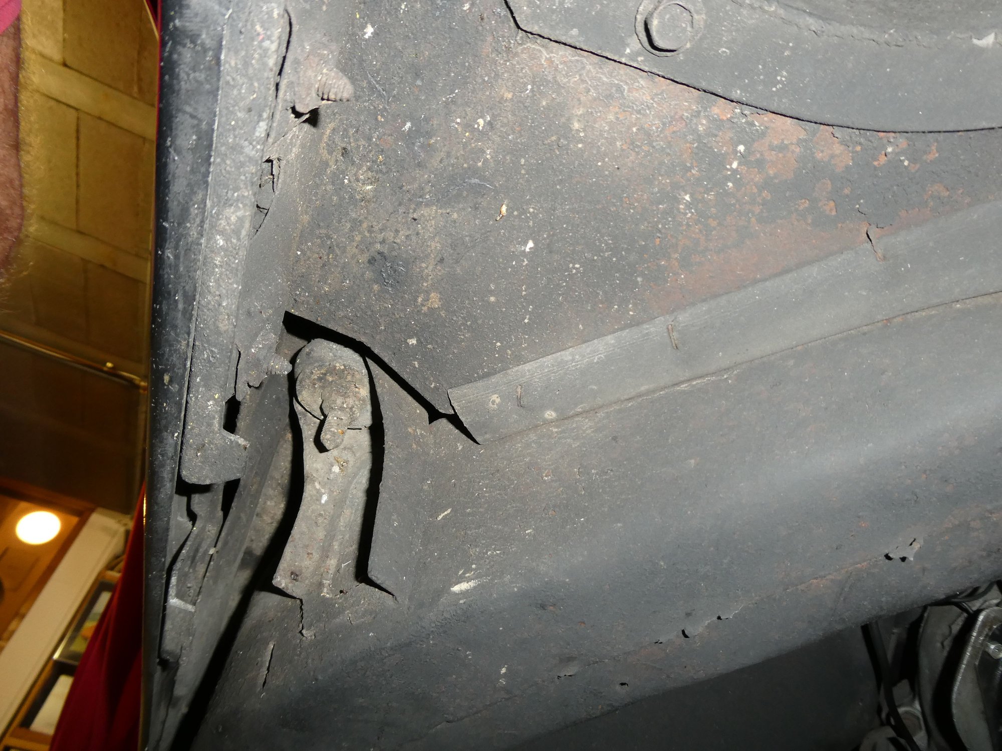

A friend has shown me the new inner splash shields he has fitted to his 1964 , that go just behind the front wheels, on the inside of the frame.
It got me looking at my '78. The area where the shields fit on the '64 is here:
I can see holes in the frame that correspond to where the shields are screwed to the '64 frame.
However, my '78 does not have the shields and I am wondering if it ever did. I had a look through my AIM and couldn't see any reference to them.

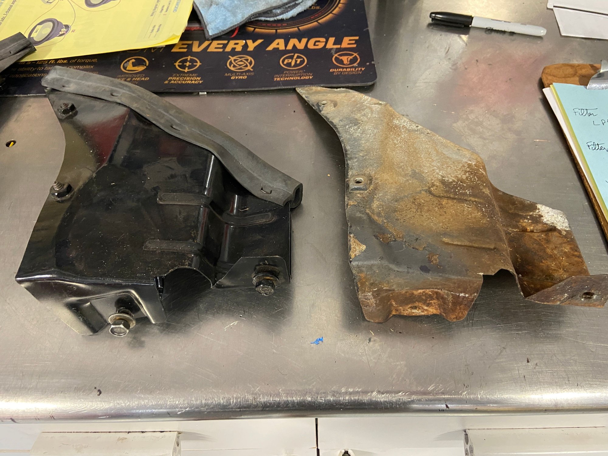

These are the splash shields on my 78.
Old Mar 5, 2024 | 02:43 PM

I'm referring to the inner shields.
My car has the outer shields, this is the right side:
These are what kanvasman posted photos of.
