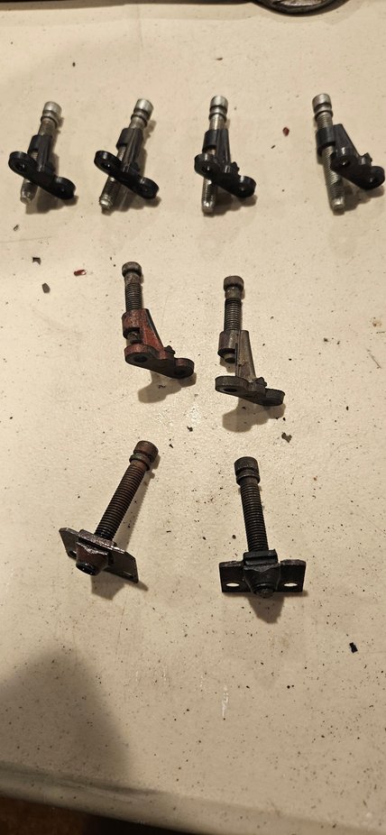

1968 Convertible. Build date 10/1967. Disassembled 5+ years ago...working on rehabbing the headlights. Have 2 "adjuster' bolts with 2 small 2-hole plates. The holes match the pattern for all the other adjuster brackets. Can't determine where these 2 parts came from or where they belong. Have searched the AIM and all the pics, videos, parts outlets I could, but I can't find these plates mentioned anywhere. Any help Identifying these would be greatly appreciated. Pics attached.

The headlight adjusters should all be plastic. The metal ones look like a homemade fabrication.
New plastic ones can be bought through most of the Corvette parts dealers, or local auto parts stores.

Hey Gary. I do have the complete Headlight rebuild kit on order from Corvette Central. Looking back at it, it does come with 8 adjusters. So, i guess you are correct since I only have 6 of the OEM style adjusters and the 2 oddballs. Weird though...they don't seem like "homemade" pieces. the adjuster bolts thread through plastic inserts that are captive in the metal plates. Anyway. I guess I will have the correct ones shortly. Thanks for your reply.
