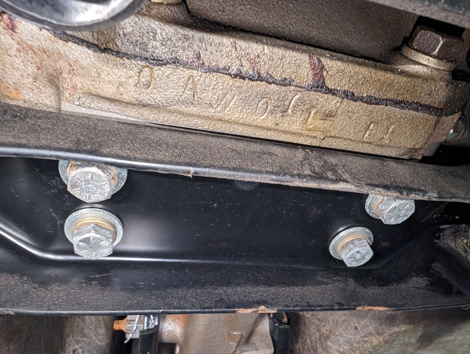

Looking at a friends rear diff and saw the following;
If I did this right - I don't know what the first "0" is?
AW = 3:08
071 = 71st day
E1 = Eaton, 1st shift

OA= 3.08
W= Warren Plant
